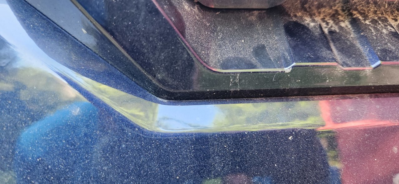

    I had a look at mine after 6 months and there are no apparent paint issues, just dirt.
    I did notice that the spoiler moves if you press on it. And that there are 2 contact points where the spoiler contacts the tailgate. There seems to be a sizeable gap everywhere else.
    All you need to do is sit on the open tailgate or put a load on it and that will start the process of paint removal.
    A quick fix might be to take it off and grind down the 2 points (I think the spoiler is plastic or ABS) or shim the spoiler so it doesn't touch the tailgate. I will check this out soon when I put my flares on.

    Yes, mine has the same paint wear in the same spot. Service manager is going to look at it next time I take it in. I was told they needed to send to the body shop and wouldn't see my truck for like 6 days. lol... Mine had it before I put a tonneau cover on it too.

    checked mine last night, i have about 1/8in to 1/16in gap between those panels for flex, they are not touching
    Mattedfred likes this.

    Most of that piece has about that size of a gap except right by the handle. Sounds like either some need new spacers for the gap or were cranked down too tight.

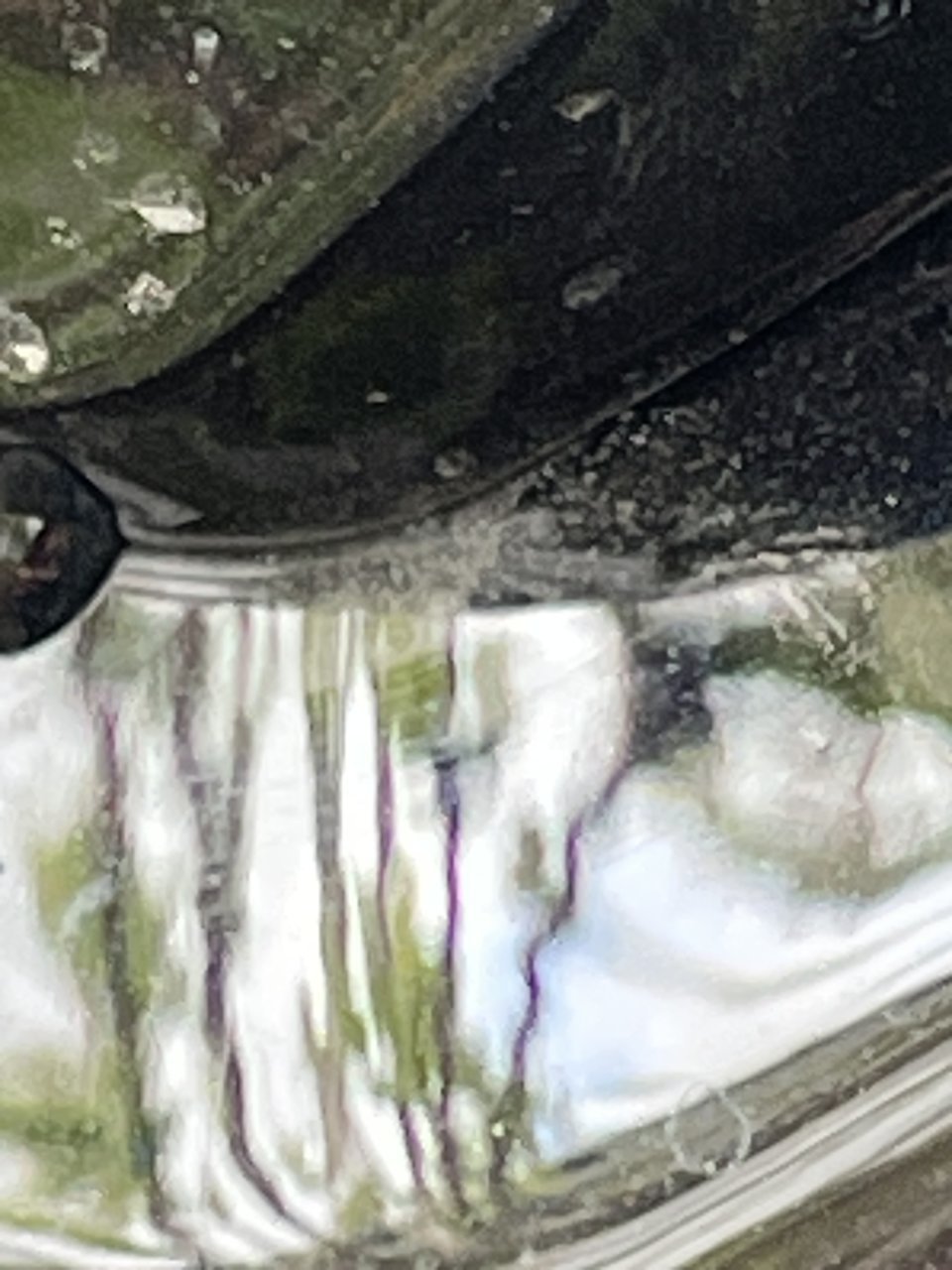

    I just checked my 23 that I got 2 months ago and it looks like I’m starting to get a small chip in the bottom corner as well. Not sure if I should try to pry out the spoiler a little bit to see if it pulls it away from the tailgate a little bit. The left side has a good gap, but the right side corner is basically touching the tailgate. I don’t want it to get any worse, so I’m stuck on trying to fix myself (maybe add silicone and touch up paint on the small area) or just take it to the dealer. I don’t really want to get something brand new repainted. Mine is very minor, but based on the thread it looks like it gets worse over time.

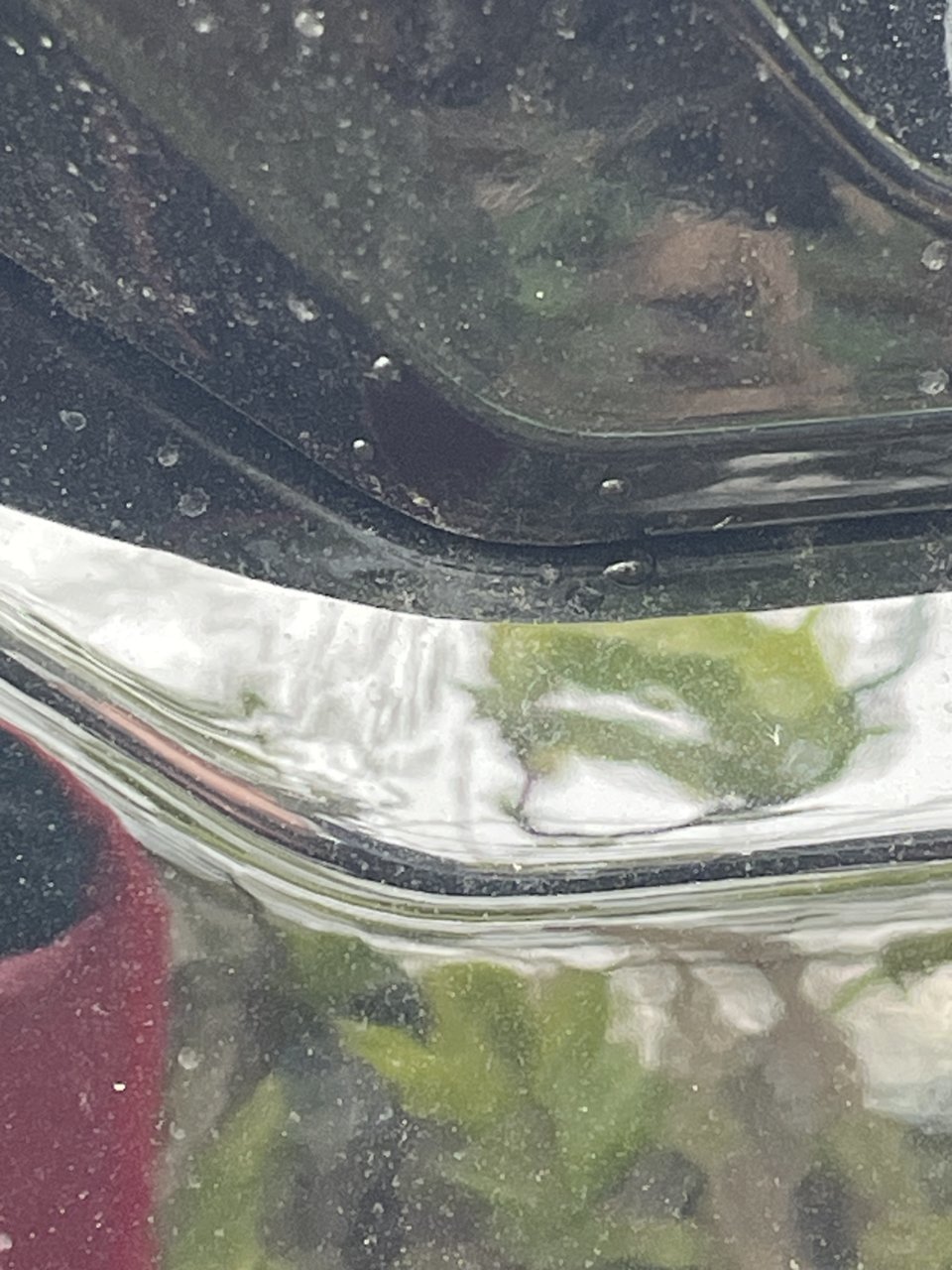

    I took mine in today for an oil change and asked about it. Service guy said they took pics for the mothership and would get back to me.

    I've got the same wear around mine. Also, looks like the tailgate is steel, tested with a magnet, so would definitely see about getting the dealer to fix it before it starts to rust.

    The dealer called me back today. He said Toyota was aware of the issue and was working on a fix. Said it would be a month or two.

    Just looked at mine. Very late '22 build on a platinum. Trim fits tight and so far no issues in that location for me.
    And yes, with a magnet test, it is steel.
