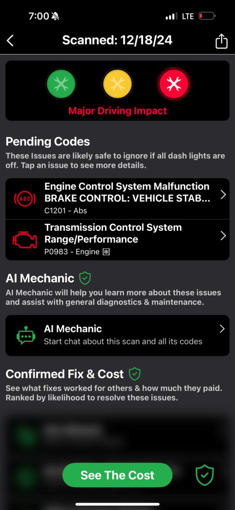

  4. Dec 18, 2024 at 6:47 PM
    #34
    Jsutundra2010
    Jsutundra2010 New Member
    Oct 10, 2024
    #124071
    Joe
    2010 white 5.7
    4” lift 33x12.5
