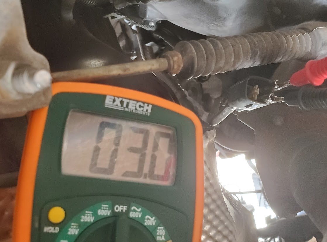

    I have not replaced the front/upstream sensor in bank 1. Good to know that it's best practice to replace both sensors in the bank at the same time. It looks like it's part 89467-0C010 which is ~$200, or Denso 234-9051 at ~$100, and it's the same part in both banks.

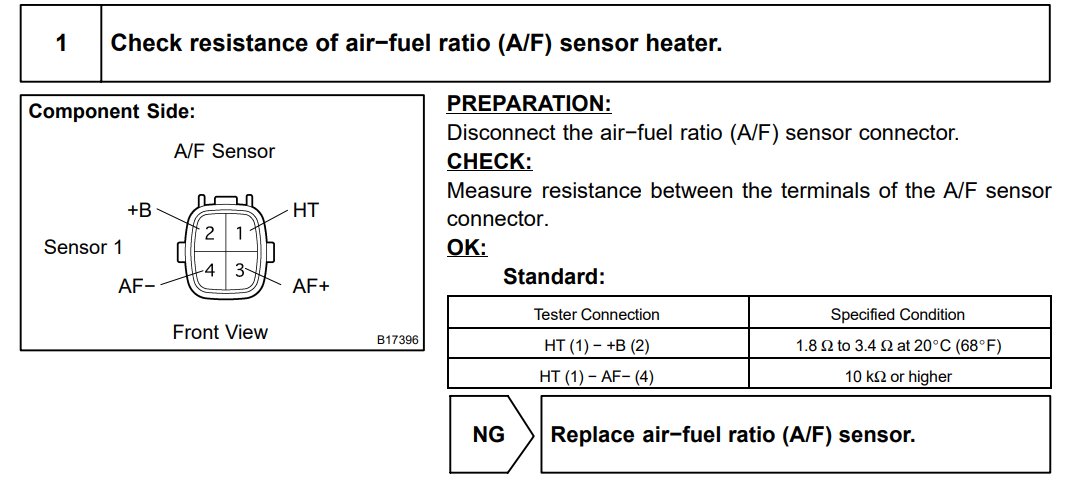

    I just measured the resistance according to the manual and it seems reasonable (3.0Ω at 85°F). I guess I should measure the other bank as well for a comparison. Maybe I could swap them to see if it makes a difference before I throw more money into this.

    BubbaW
    Aug 19, 2019
    #34845
    4,135
    Bubba
    Where Eagles Nest
    04 DC LTD 4X4 4.7 V8
    T150 Lover
    While I agree that's a good reading for the heater element of the sensor, pins 3 and 4(AF+/AF-) are the money makers when it comes to sensing the oxygen.
    If that has not been mentioned already, that is very good way to tell if it moves code to other side....result should be P0156

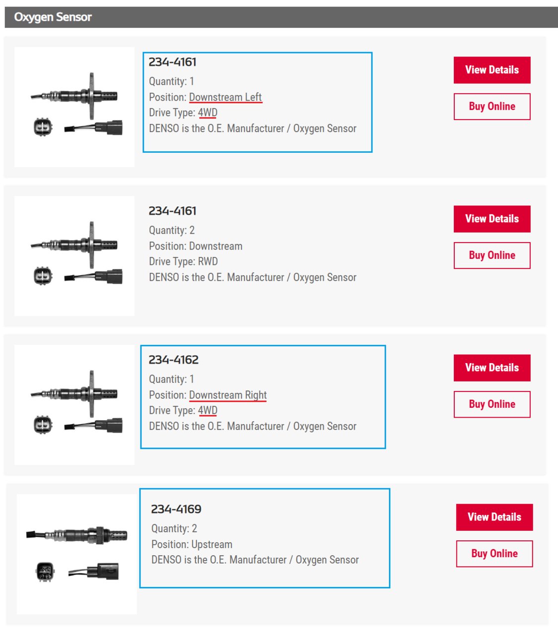

    Is this a part where I should stick with a Toyota original, or is Denso going to be fine here? And what's the general consensus about Amazon, can it be trusted for Denso parts? If not then at Autozone the Denso is about the same price as the original, so I'd just buy from the dealership at that point.

    Denso from Rockauto (not A-mazon or e-Bay or Wally-mart .com) is the consensus

    Yup ^^
    Denso. Use the part finder at their site to find the part number by plugging in your truck info or VIN and choosing 'Sensors' checkbox: https://www.densoautoparts.com/
    Don't get confused with the output. They always list at least one "Universal" sensor in the lot. Pay attention to which is upstream or downstream in the part details.
    Sometimes they also have further details like "for manual transmission trucks..." or "for 4WD" for example. If you need a sanity check, reply back in here.
    Take the part number and plug it in at Rockauto or Summit Racing or your preferred non-fleaBay, non-scAmazon, non-WallyWurld vendor's wwebsite and order it up.
    Glad the swap-between-banks test worked out for you. Great way to save a buck.

    But anyway, I looked it up, this is what Denso is listing for you - looks like 4WD and 2WD are different, where your 4WD has a different downstream sensor bank 1 vs 2:
