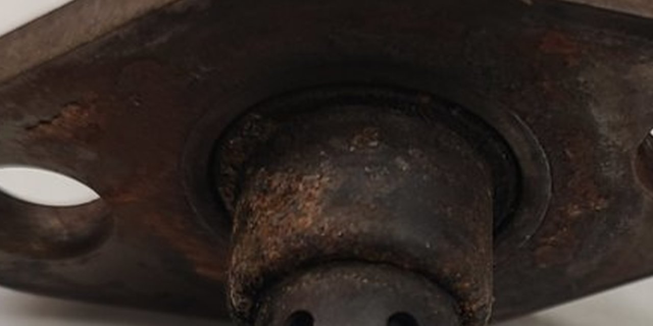

    When you replaced B1S2, did you clean the exhaust side mating service and did you use a new gasket ?
    From the looks of the B1S2 sensor you posted above and the continuous lean condition(less fuel/more air) in graph when reving, it causes me to suspect air being drawn in due to bad mating service contact. Bottom of that sensor if indeed new, has collected a lot of gunk/gasket flakes..

    OK, update. Turns out the brand new O2 sensor from Napa was defective. They're not giving my $ back but at least I avoided a trip to a shop. Just waiting for the evaporated monitor to complete and I'm ready for inspection.
    I attempted to remove B1S1 today but the 7/8" O2 sensor socket I bought fit very loose. So I aborted on that task. Probably won't bother with it since truck probably won't pass inspection next year.
    Lesson learned, just because it's new doesn't mean it's not defective.
