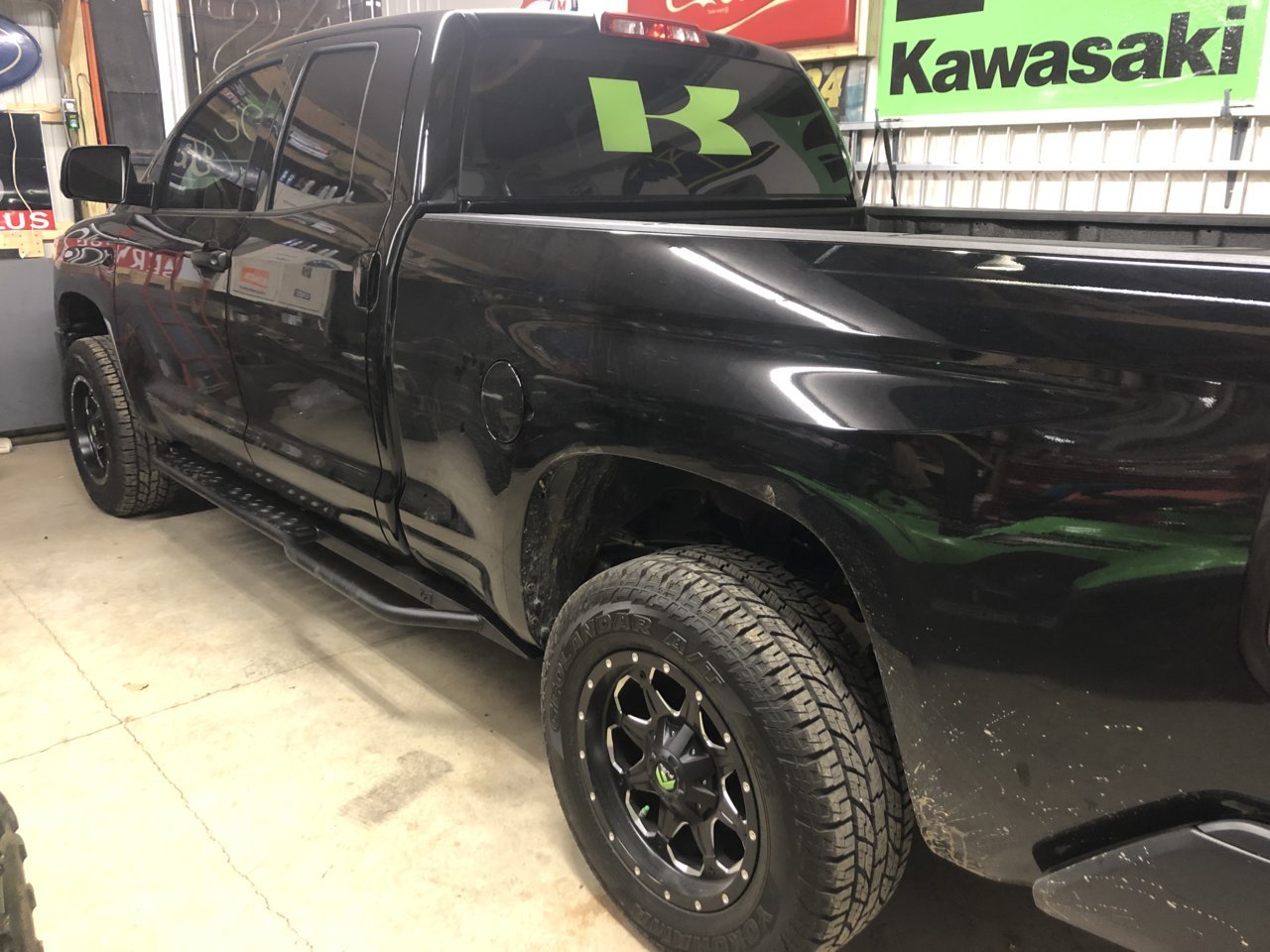

    Install DONE- final project looks great
    Getting there a little tuff
    On my 18 SR DC the problems were on driver side- last rear bolt- TIGHT spot/access issues (1/4 turn at a time with open end wrench only)and “E” brake cable/ bracket must be relocated
    Pass-side has “hard” break lines in frame channel- must un-snap lines from brackets in a couple spots( carefull not to break plastic)to get backing plates to sit flat against frame - then lines ride on top of plates then most snap back into brackets
    Both sides -last rear cab-mount bolts must be cut off flush with locknuts if u want sliders to be up tight to cab as possible( using ATVjack & floor jack to hold tight )and level with front - I installed a rubber isolater (neon boot) over cut bolt/nut of body mount were it hits slider - so hopefully it won’t rub and RUST!!!
    Yea now need to WASH!!
    All in all it could have been worse!!
    Good luck to all - SLIDE ON!!
    :mudding:
