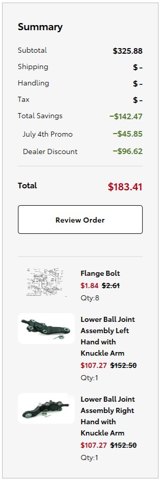

    I'd clarify that a bit with "standard discount price shows up on the item page and in cart, final added discount shows up at checkout".
    They're always offering some percentage below discount (their 'standard discount' 15-50% off), but during sales like the Independence Day sale going on now, that extra 20% off (and free shipping, and free tax if applicable) don't appear until checkout. It confused a number of people in the past.
    The reality is, Ourisman can't hand a candle to the discount other Toyota Parts Program participants offer during these national sales.

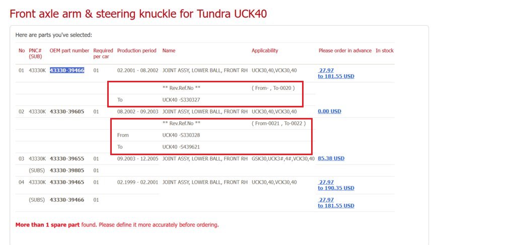

    PS - @kolouri I looked up a 2000 V8/4WD Limited VIN and these are the LBJ showing in the EPC:
    • Passenger/RH: 43330-39466
    • Driver/LH: 43340-39356
    • Bolts (need 8): 90080-10066 (NOTE: There was a note in the EPC about different fasteners depending on manufacture date, but also, see THIS THREAD which says this is also correct p/n, and your bolts are single use, so you MUST buy 8 new ones, ideally)
    Cart price shows $229 when you add it all in. Price at Checkout is (if you're outside Alabama) no tax, free ship, $183.41

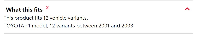

    Oh, wait. I remember a member here telling me about that. I think it’s either 2001-2003 or 2002-2003 Tundras that were only impacted for the recall. Sorry, my mistake.

    No worries. All I kept reading about was those recalls but couldn't find anything for my truck. Maybe the 2000 was a unicorn year that didnt have them, I'm not sure

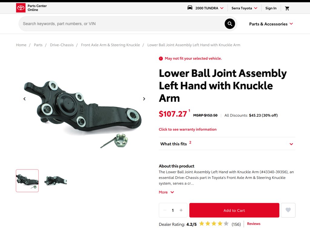

    omg this is the most confusing thing ever. It should be the right part but theres a note that says it may not fit my vehicle.

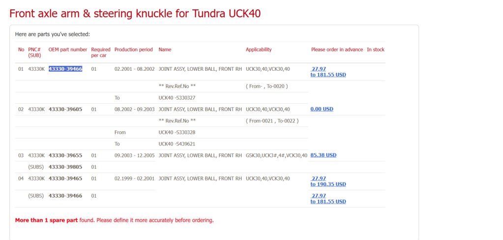

    OMG, I'm so sorry but so confused. Took me forever, but I found the part in the EPC and it's that -39466 number that you show but then the toyota site says it's for 2001-2004 vehicles. Do I just ignore that warning that it might not fit since it's such an old part? I absolutely appreciate the link you gave me and totally believe you that it fits, just trying to learn to look this stuff up myself and it's so hard haha.

    This gives you the information, how to tell which part is for your truck, find the "S" in your VIN number, and if it's lower than the "S330327" (i.e. it's 330327, 330326, or lower, etc.) then the top part number is for you. If it's between 330328 - 439621 in sequence, then the 2nd part number is for you. Can you give the last 7 digits of your VIN?
    The reason I say it's the former is because the production periods are Feb 2001 - August 2008 on the part number I linked, and the other part number is for newer-production trucks, so I was running on the assumption the -39466 is correct.
    If you don't want to post your VIN (partial or otherwise) directly here, feel free to PM. I've been busy as shit the last two days, despite trying to take some time to relax, so I haven't been replying much.
