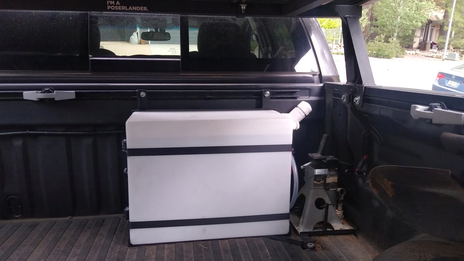

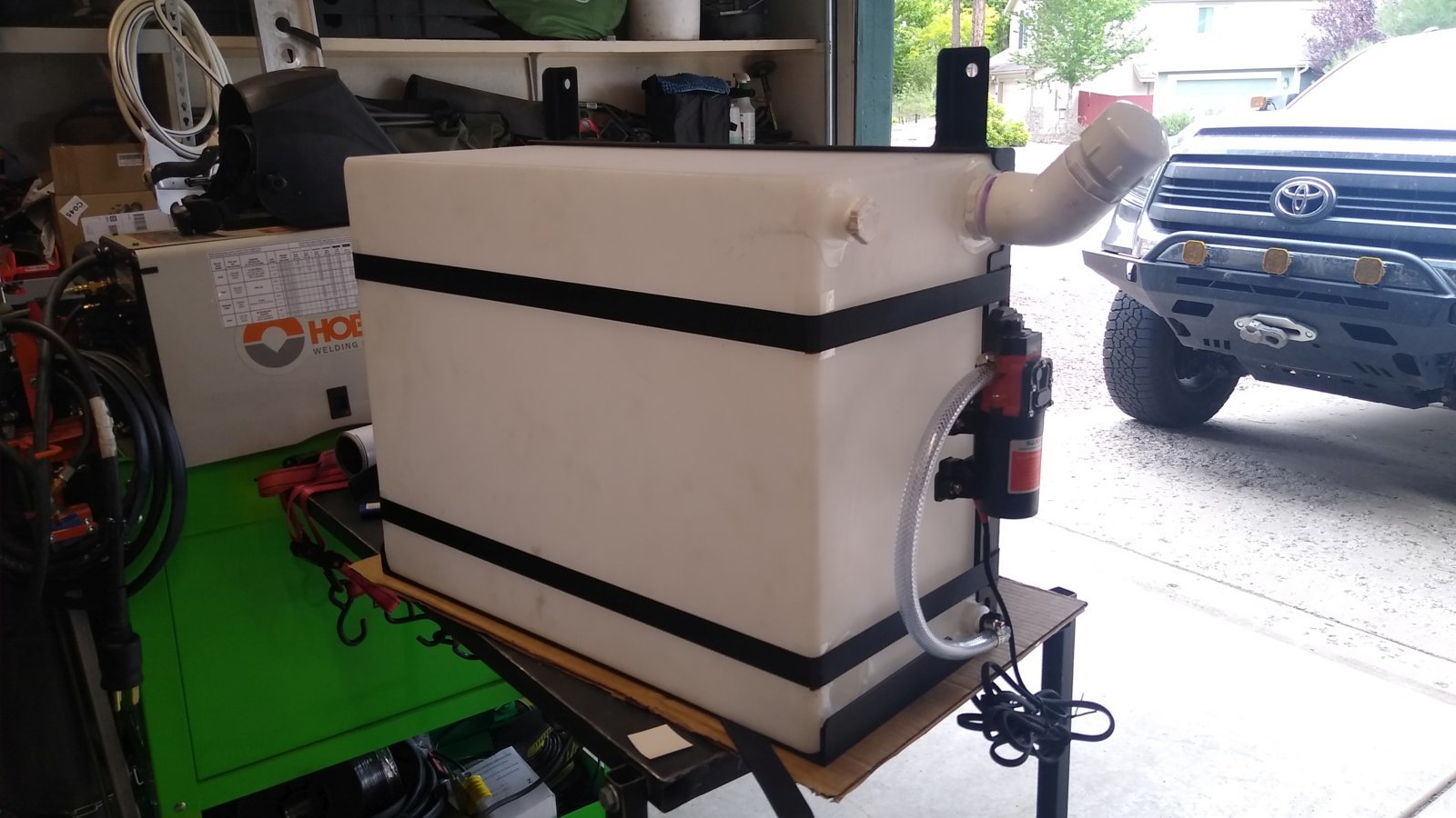

    That’s a lot of water Dave. Are using that for showers or are you planning to water those desert thirsty plants on the side of the trails?

    all of the above, plus filling camelbacks, putting out campfires, and possibly even drinking

    Hey Dave, curious about what you feel are the benefits of this water setup over the dual aquatainers other than the increased capacity?

    Not a whole lot, really. It's the same pump and hose, so the only real difference is not having to switch tanks and it's easier to see the water level.
    edit: and it was an excuse to make stuff

    found another benefit: the extra weight makes my truck ride nice :rofl:

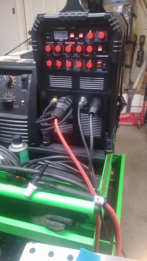

    new addition to the garage. need to think up some projects to TIG now. primeweld 225X ACDC

    Chop your DC frame, heard that’s a lot of welding :rolleyes:

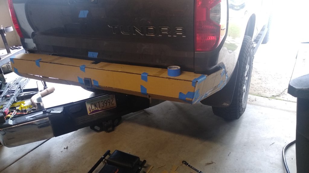

    Really like your whole thread. I like it when you just build it and get it done. That rear bumper is
    really impressive. Was that a send cut send idea with your own template for sections?
    I’d like info on that Jack, I’ve never seen one before. I just got a CoastalOffroad bumper kit

    Local guy tried to sell me a new Miller 225 TIG. Like I don’t have enough to do.
    If I had a new welder I’d never get out of the shop

    The rear bumper was my design and all hand made except for a couple of the hitch brackets, which I had cut by sendcutsend. I designed the whole bumper in cad first to get an idea of how I wanted it to look then used cardboard to mock it up on the truck and cut the steel.
    I can easily reach the spool lever through the front of the bumper.

    Thanks, you got skills! Few years ago instead of forking out $2200 for a fancy bumper I bought
    a $1900 plasma cutter and made my own. This was before sendcutsend ideas even existed. World has
    changed.
    Any tips on doing the Coastal Offroad bumper? I haven't really looked at it yet, too much else.
    But soon. How tight do you tighten that center section on before you get to it? Seems to me that's where it

    If i remember right, you build the center section on the bench and install it on the truck, then build the rest of it on the vehicle so you can tack up the little pieces and make sure its all level and symmetrical. My only advice is take your time getting it all in place and aligned, and when you weld it up try and jump around and not put too much heat into one spot at a time.

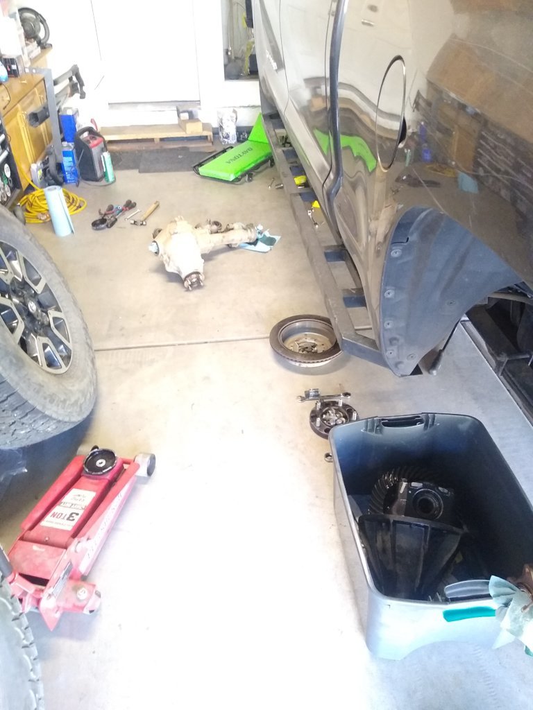

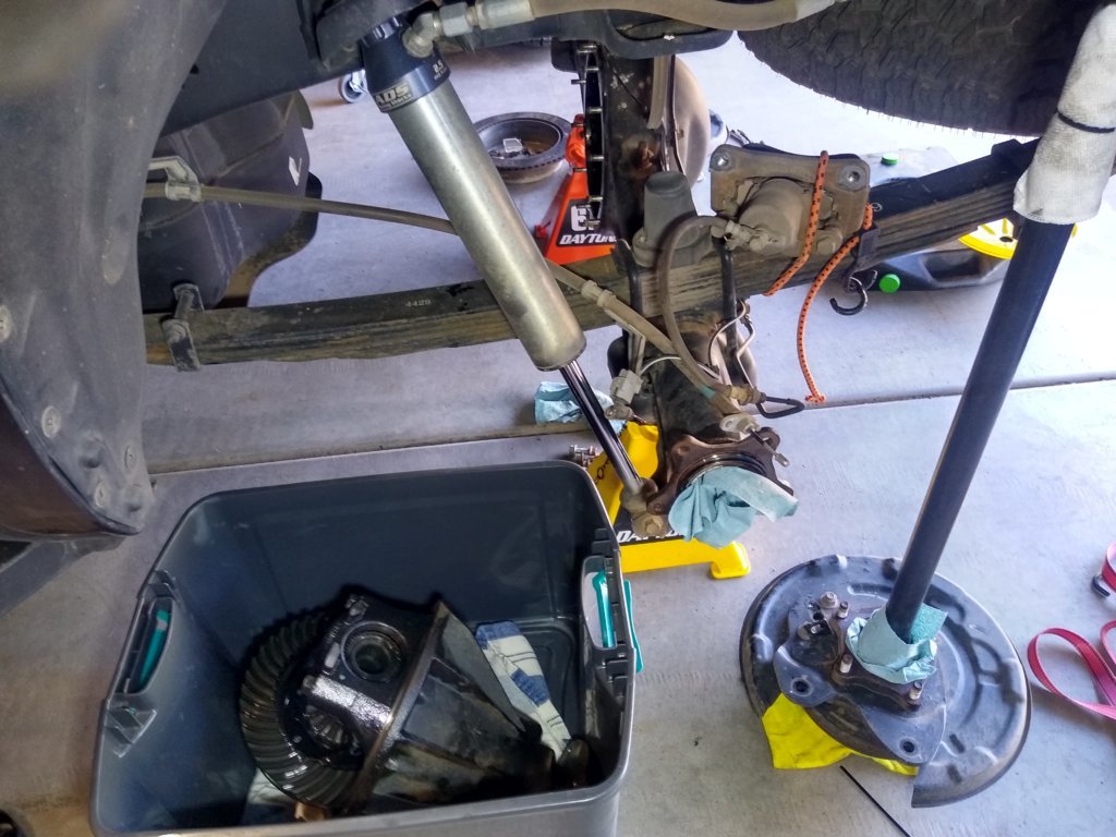

    Gonna be a busy week. Pulling diffs to take to ZUK for revolution 5.29s and a powertrax, then while its apart going to replace the front springs with 700's and ditch the solid motor mounts. Also gong to try and clean and paint the undercarriage if its not too cold.

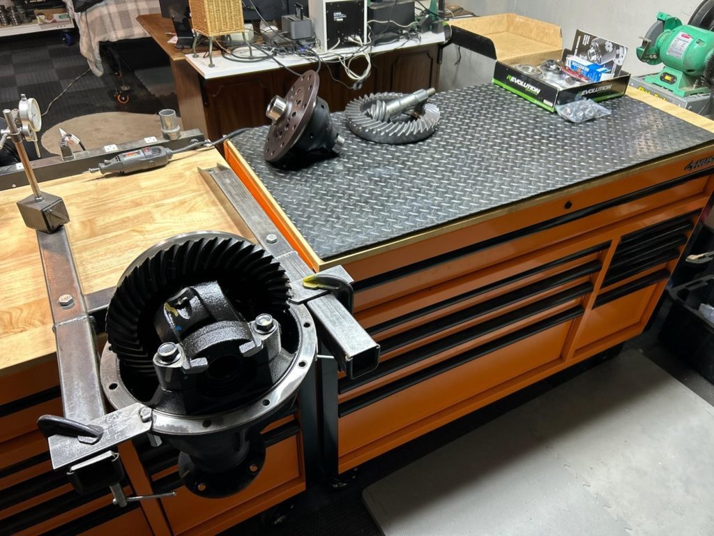

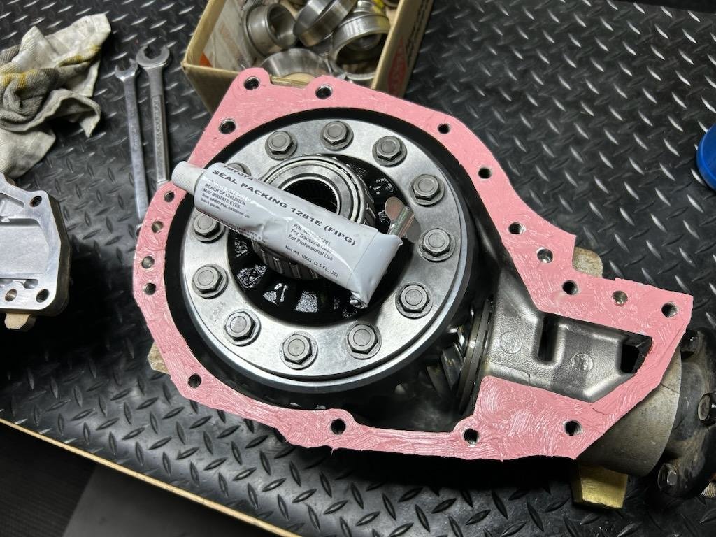

    Gears: done. 700lb springs: on. Half the pictures: accidently deleted
