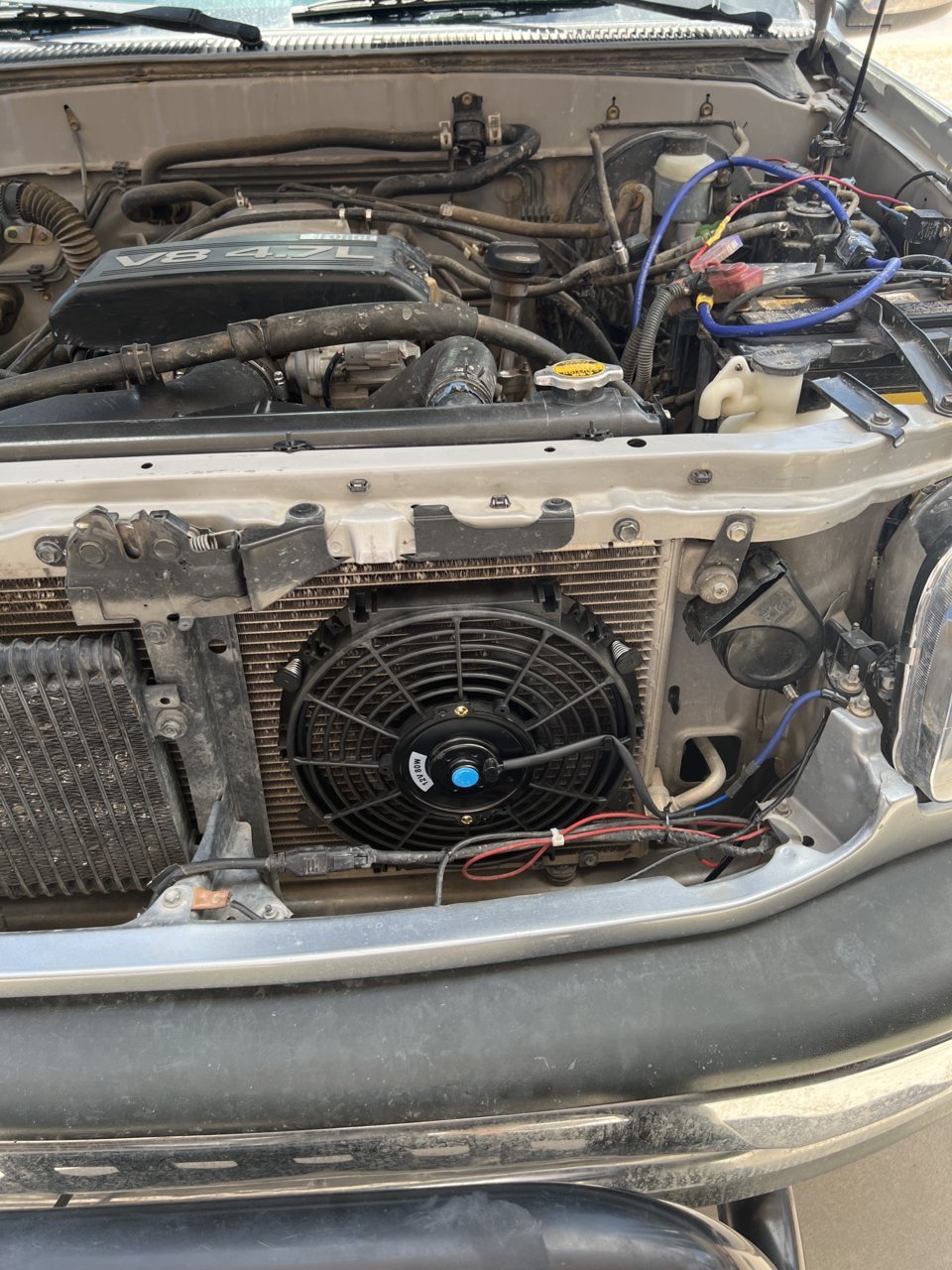

    Just a little fix I have done recently and it worked for me, try adding a cooling fan to the front of your ac cooler, I wired mine up to a switch in the truck and I turn it on when I’m idling or in slow traffic and I have no overheating issues, the ac blows cold for a lot longer now to.

    Interesting. I must experiment.
