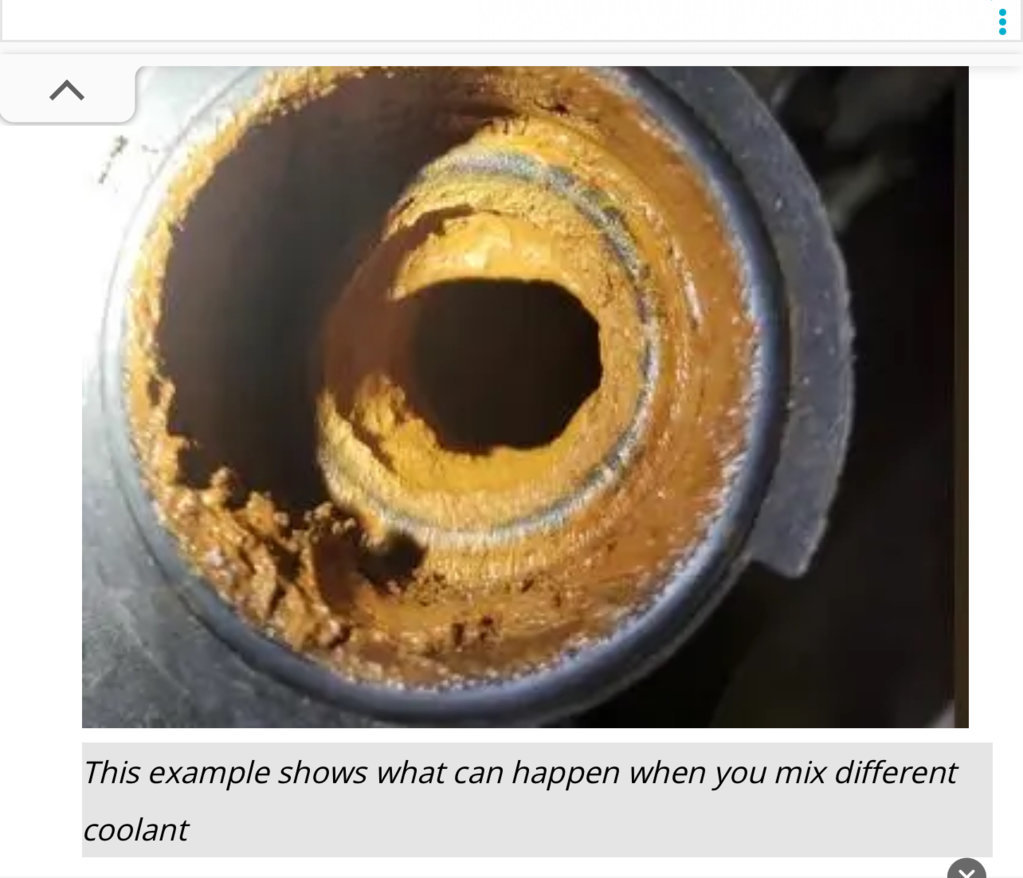

    I’d
    Definitely fix that reservoir then I’d do what others suggested also to burp the system.
    Being it had water in it instead of coolant like you said, if that doesn’t help personally I would take Off the front covers and look at water pump to see if there is any sign of leakage. (About and hour job to get it apart). But I’d rather spend the time than blow a head.
    If incompatibile coolants have ever been put together in that system it can also affect water pumps not just thermostats.
    That’s what happened to our Malibu years ago. I assume an oil change shop put wrong coolant in and this is what ours looked like.
    Took a couple months before it ruined the thermostat and water pump, but I never did get that one going again due to the Malibu system.
    If you saw anything like that, or chunks in it, back up and do several flushes of your system to cut that stuff out before proceeding.
    Id also check the compression.
    I have seen heads crack on other vehicles, and when they warm up crack opens wider and starts putting pressure into the cooling system.
    If don’t know if Toyota engines would do that though, we never got to work on very many Toyotas because Most lasted a while.
