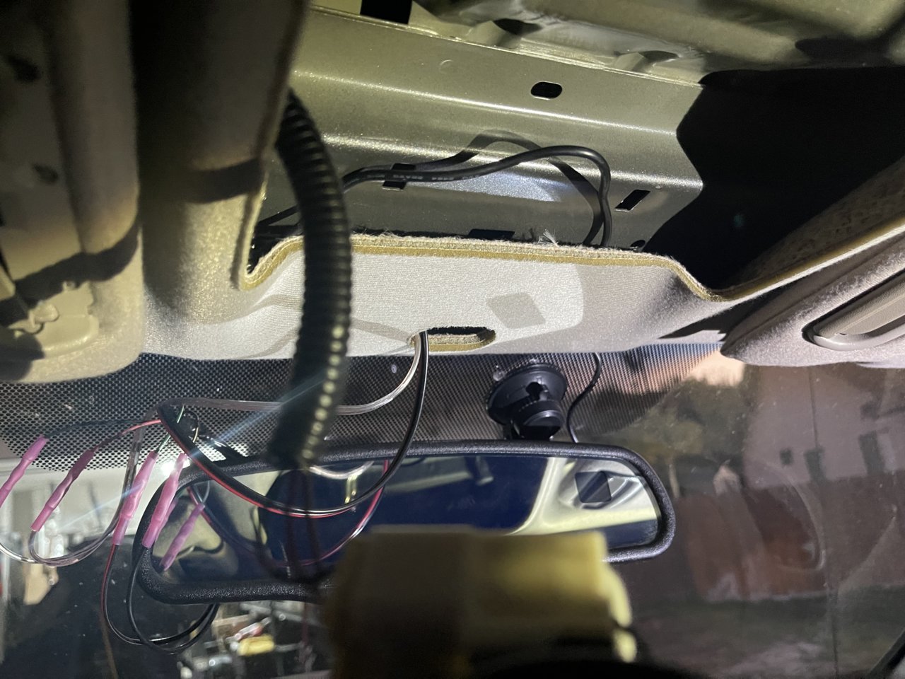

    Hi, just thought I’d give an update17BBE673-2122-4840-A9D9-304A4D245D41.jpg 17BBE673-2122-4840-A9D9-304A4D245D41.jpg 0D0D484F-8EE1-4DAF-ABC8-10012F775D9F.jpg . I went with a Gentex 177 mirror. It was a bit of a learning curve on how to install it but thankfully the eBay seller was super helpful

    Awesome, thanks for checking back in. So, I'm seeing 2 pairs of wires coming down there, 1 red/black pair, 1 translucent pair (spkr).
    I take it one pair is bringing power and ground to the mirror (red/blk), the other is bringing temp gauge feed (clear)?
    Curious, is your power feed always-on, or tied to accessory power?
    Where'd you pull power from, and how?

    Yes that’s correct, I had some spare speaker wires and used different colors as to not get confused. But yeah, one set (black/red) is for the temperature probe and the other is bringing in power.
    Power feed is not always on, only when acc is on in the ignition switch.
    I added a circuit to the fuse box with a special cable that came with the kit for hardwiring my dash cam. Then I T-tapped that cable with the power supply cable to the mirror, grounded it and it worked.
    I had struggled to find a good place to tap into elsewhere.
    I tried some ACC cable near the ignition switch but my ignition engaged earlier so I undid that real quick. Then I dove into adding a circuit to fuse box and that was the cleaner safer way.
    5N0W808 likes this.
