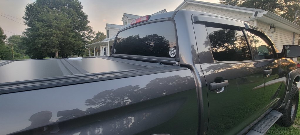

  24. Jul 30, 2025 at 3:51 PM
    #114
    Boneskull420
    Boneskull420 New Member
    Dec 11, 2024
    #127230
    172
    Tn
    2018 tundra crewmax magnetic gray trd offroad
    Ironman 4x4 foamcell pro 3.5in lift Complete custom stereo with 2 12's under rear seat S&B/stillen Frankenstein cold air intake True dual exhaust with Carven Tr mufflers Rough country hood bulge led strip Running board led's
    Got my OTT tune yesterday from AppalachianToyotaTuning. Went with medium/ spicy for my setup. So far I am happy with it. I wish I would have tried the super spicy for the tow haul mode but all in all I am happy with the way it drives. Thanks you all for your help and info! 20250729_203947.jpg 20250729_203455.jpg
