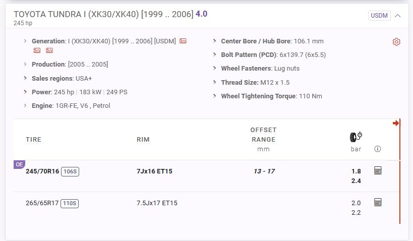

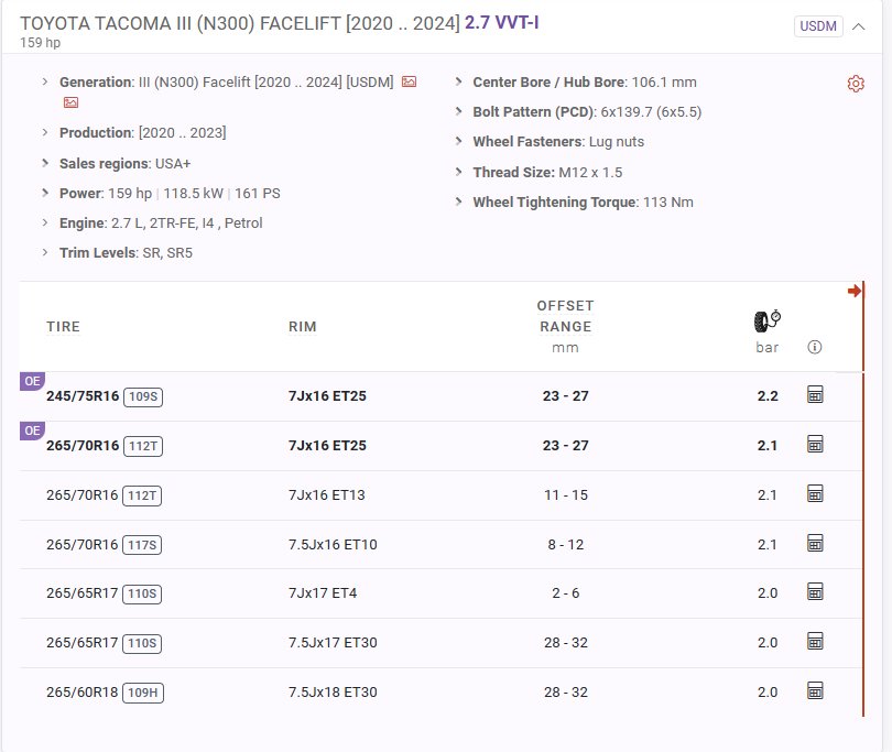

    Gents, I'm a noob here and looking for a good wheel/tire setup for my '05 Tundra. I've settled on a 16" wheel with 285/75/16 tires (along with a 2.5" lift). However, the particular wheels I was about to pull the trigger on are very explicitly listed on the manufacturer's site as ONLY fitting Tacomas due to the hub bore size.
    Would these not also fit the Tundra? Unless I'm missing something, they both have a 106mm bore so there shouldn't be an issue. Just thought I'd get some expert opinions from you old salty tundra dogs.:D Thanks!

    It certainly looks to be the same size...:confused:

    Welcome from TX. I can assure you that they have the same hub bore size. The starfish on my 00 Tundra came off of an 02 Taco.

    • Wheel fitment (from other Tundras): 2007-2022 Tundras use 5-lug wheels. In 2023, Tundras started using 6-lug axles again, but the hub bore is smaller (95mm on 3rd gen vs. 106mm on 1st gen), so they technically won't work unless you spend a couple hundo on custom-made spacers.
    • Wheel fitment (from other Toyota models): Anything from Tacomas, 4Runners, Land Cruiser, LX470 and GX models that are 6-lug will typically fit. Someone here is probably running it already, and pics of it are in the OEM wheels thread.
    tl;dr - anything 105.9 to 108 will fit pretty cleanly from what others have found.
