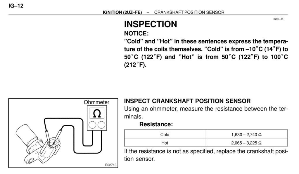

    How can you test if the crankshaft position sensor is bad?
  2. Jan 29, 2025 at 5:54 PM
    #182
    BroHon
    Sep 19, 2023
    #104169
    2,644
    Bro
    Location: Bitch Mitten
    2000 SR5 AC 4x4 4.7

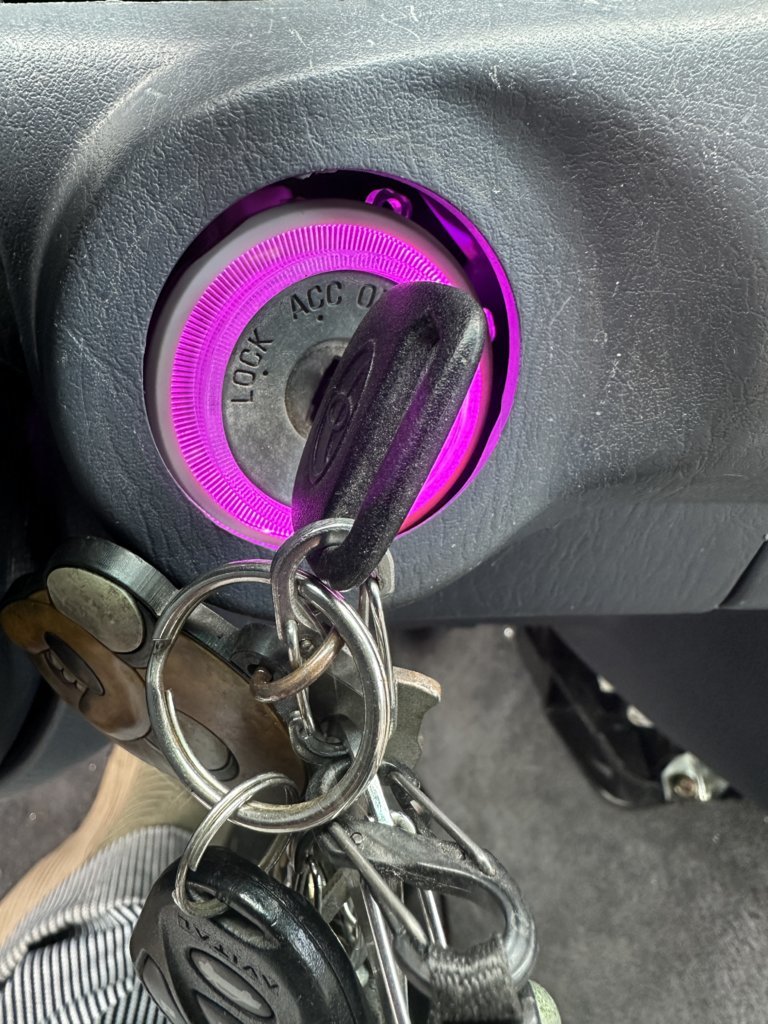

    Okay this is a stupid question but how did this happen? Is there a way I can unscrew something to zero in the ignition to the panel trim hole? Did I accidentally move something and it lowered the ignition key? All the bolt holes line up and screw in easy?
  11. Jan 31, 2025 at 1:15 PM
    #191
    whodatschrome
    whodatschrome New Member
    Sep 13, 2023
    #103882
    1,865
    North of North Plains, Oregon
    lots of dents
    Perhaps the missing black plastic trim ring is the final piece of the puzzle that's keeping the lock cylinder from being centered in the trim panel?
