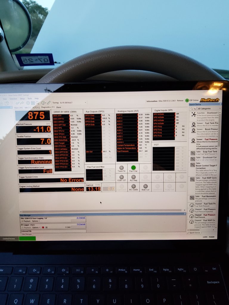

    What does it idle at with intake hose removed? If removing the intake hose improves it, it sounds like it could be a MAF issue.

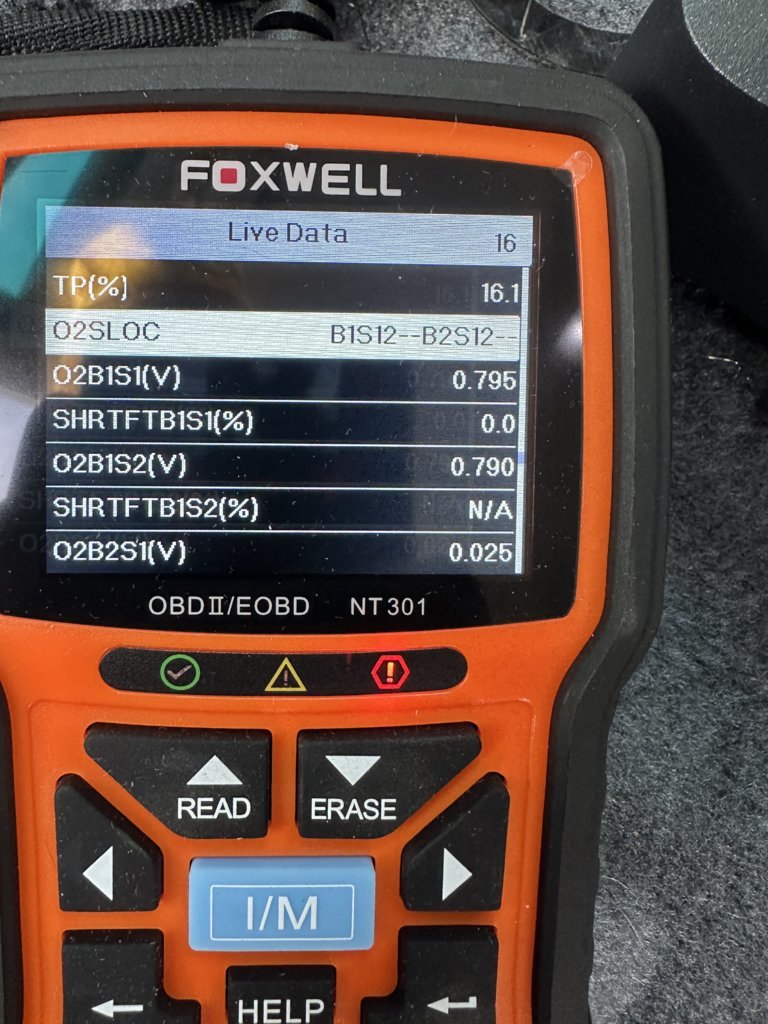

    Is that TP % OK? Shouldn't it be low single digits at idle?

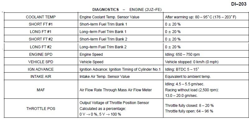

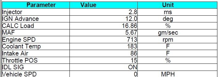

    TP % of 16 is ok when speaking of a normal operating system but that was a number without an RPM reading also at that point in time. For instance, at idle The FSM for 1st Gen shows 8-20 %. Ciphering anything from the scan results that were shown are meaningless if for no other reason than what OP said earlier about his bucking bronco....."Right now it idles up and down goes up to about 4500 then down to 1500 then back up then down to zero then back up then back to 2800".
    As @KNABORES asked earlier about the MAF, it may indeed have an issue given the high number shown but that's a head scratcher and hard to focus on until it's back to purring like a kitten.
    This is my normal for my 04 DC 2UZ, FWIW....
    This is from FSM 2UZ normal....
    Hopefully when his buddy brings him his throttle body that he mentioned earlier, perhaps they can figure certain things out....TPS issue, APPS issue ???...etc

    Oh damn. That's pretty high. I guess on a cold start it would make sense to allow a higher idle. I was kinda taking a shot in the dark based off my Crown vic. It sits around 7%.

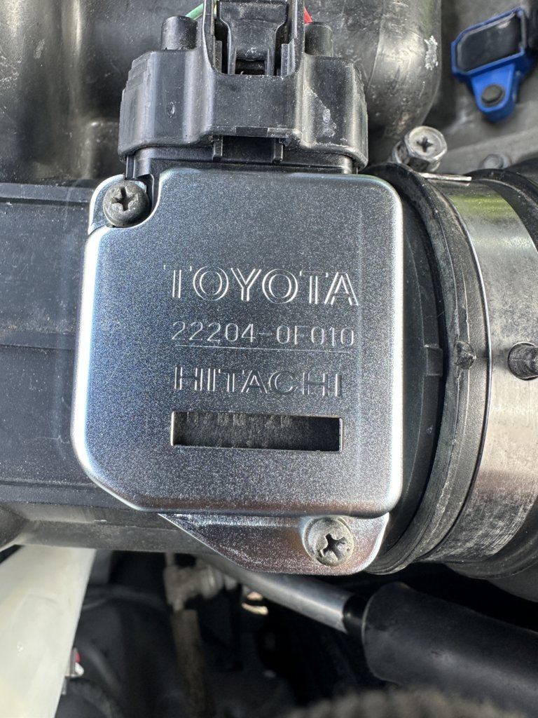

    I think the OEM maf is Hitachi???

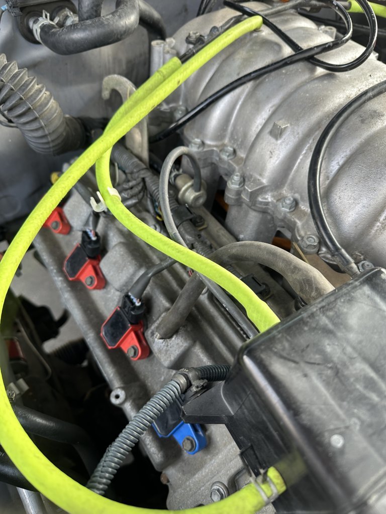

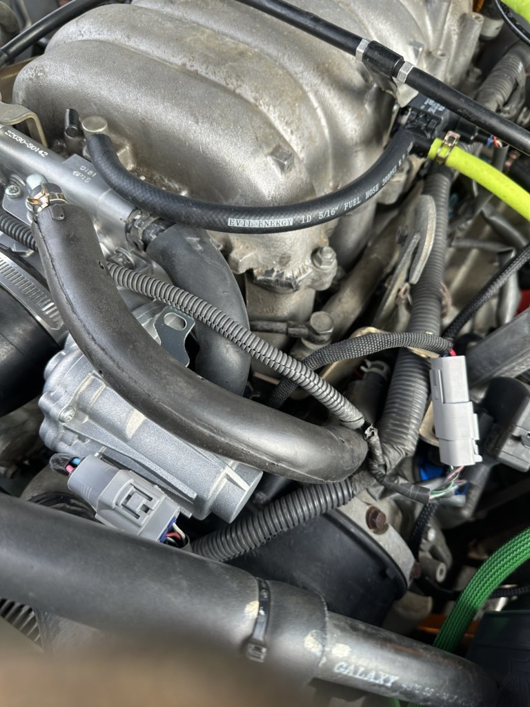

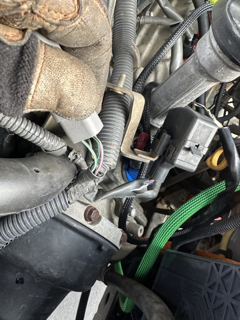

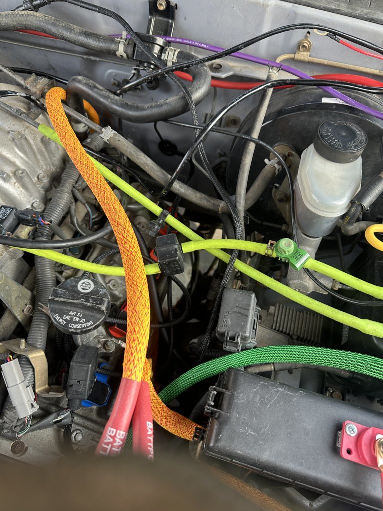

    Yes it’s a hitachi. Here are some other pictures of the hoses. I think I have them all hooked where they need to go and in the right spot

    I need to get off my ass and do all the hoses in my truck. What'd you use for brand/diameter on the vast majority of those hoses? And is it possible any were too large/too small/maybe have nicks or cuts?

    Fuel line is NOT vacuum hose. It will flatten faster than overcooked penne! (I can tell you how I know this...)

    Have you checked the pleets in your intake snorkel for cracks/splits? That (new?)MAF reading looks super low now, especially at almost 1900rpm.
    Prize for the most colorful engine bay I've seen on here... and I'm not hating on it :cool:

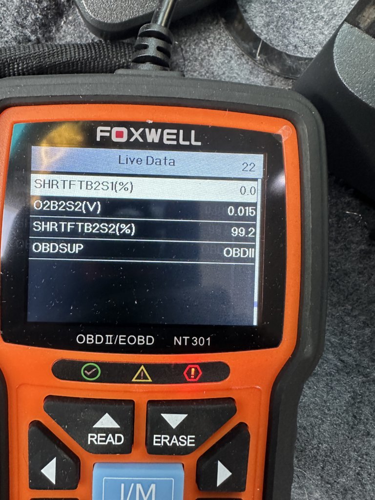

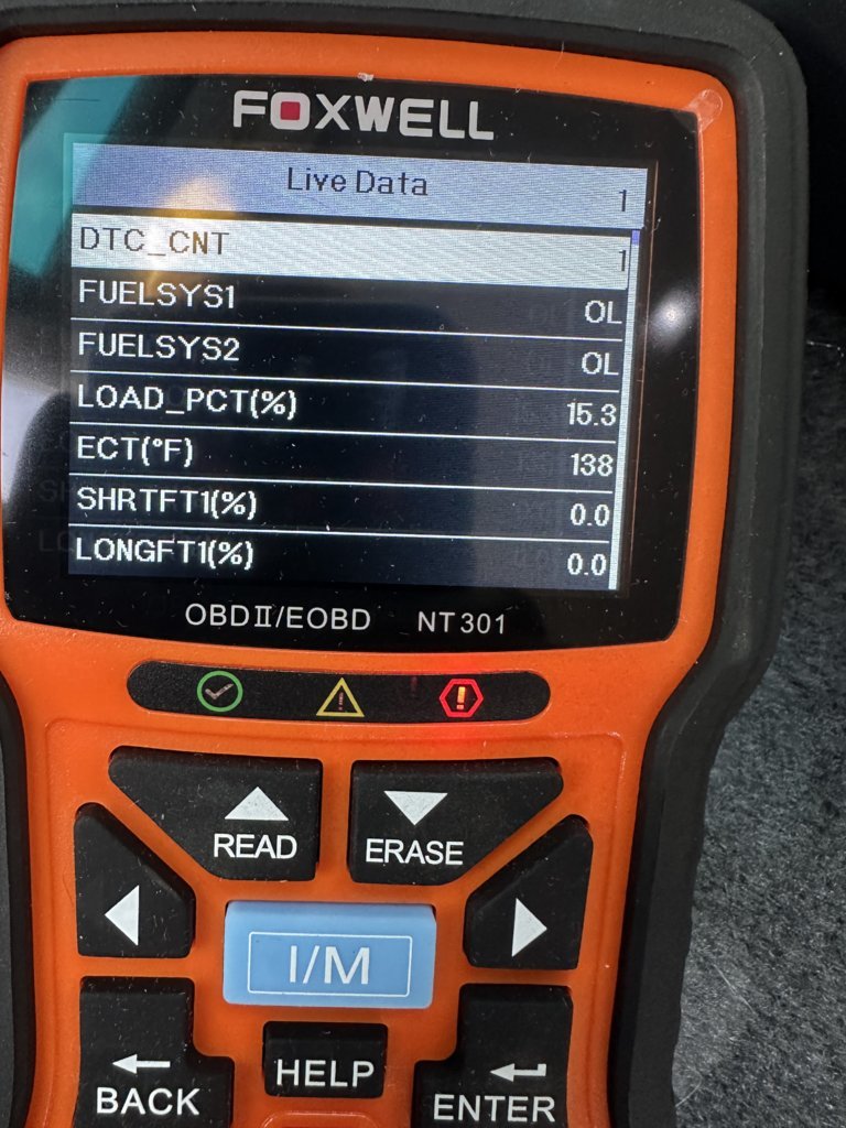

    One thing with all those reading is your system was still in Open Loop, meaning the ECM was waiting for the engine to fully warm up before it starts taking in/and adjusting for sensor data. Make sure it will eventually go closed loop when 180-190 deg on the ECT reading.
    Are your O2 sensors fluctuating like they should be? Sensor 1s on both banks should fluctuate and sensor 2s should remain relatively flat. But for the pics you posted O2s readings aren't relevant to how it's running because that data isn't being used (open loop - running a pre programed set of parameters until the engine reaches operating temp).

    W666 well that’s a reinforced hose and it’s been on there for several years now. It doesn’t go flatter than pasta. Thank you for your concern though

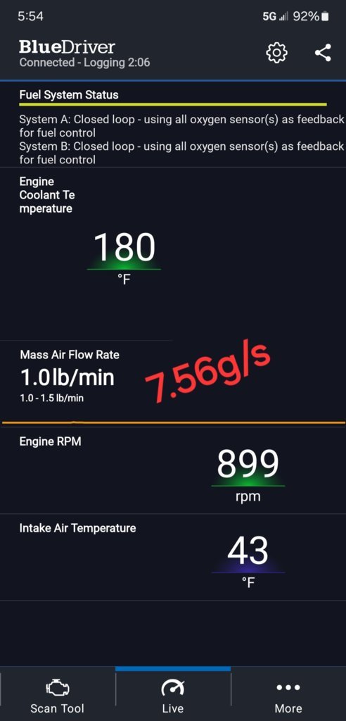

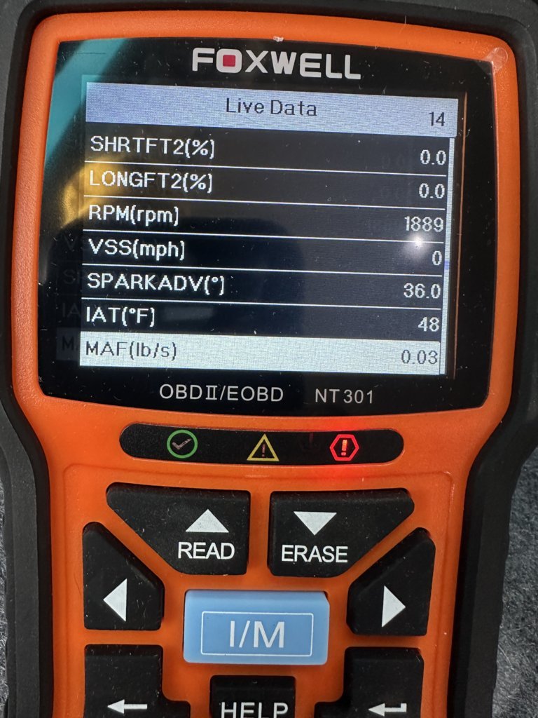

    If you still have the code P0120 you probably wont get movement on the throttle plate until the last bit of pedal travel, when the control becomes and actual mechanical movement, AKA limp mode. But Ide still focus on the P0120 because the ECM doesn't lie, it doesn't like something there specifically.
    Odd thing is how your MAF went from High, to barley registering (@ 1889 rpm!) with the new one. Was the intake ajar letting in unmetered air when you took that photo of your OBD2 readings? Are you running stock air filter/inlet?

    I mostly work by feel/vibration. I can feel ticks and vibrations that are not normal. I feel through my foot or by touch. I mainly go by what my son says. He really quite good at signing me what the truck is doing or describing how the truck sounds.
    yes the truck only has response at the last bit of peddle travel. All the air filter and tubing is stock.
