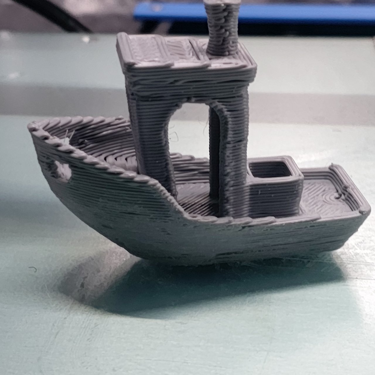

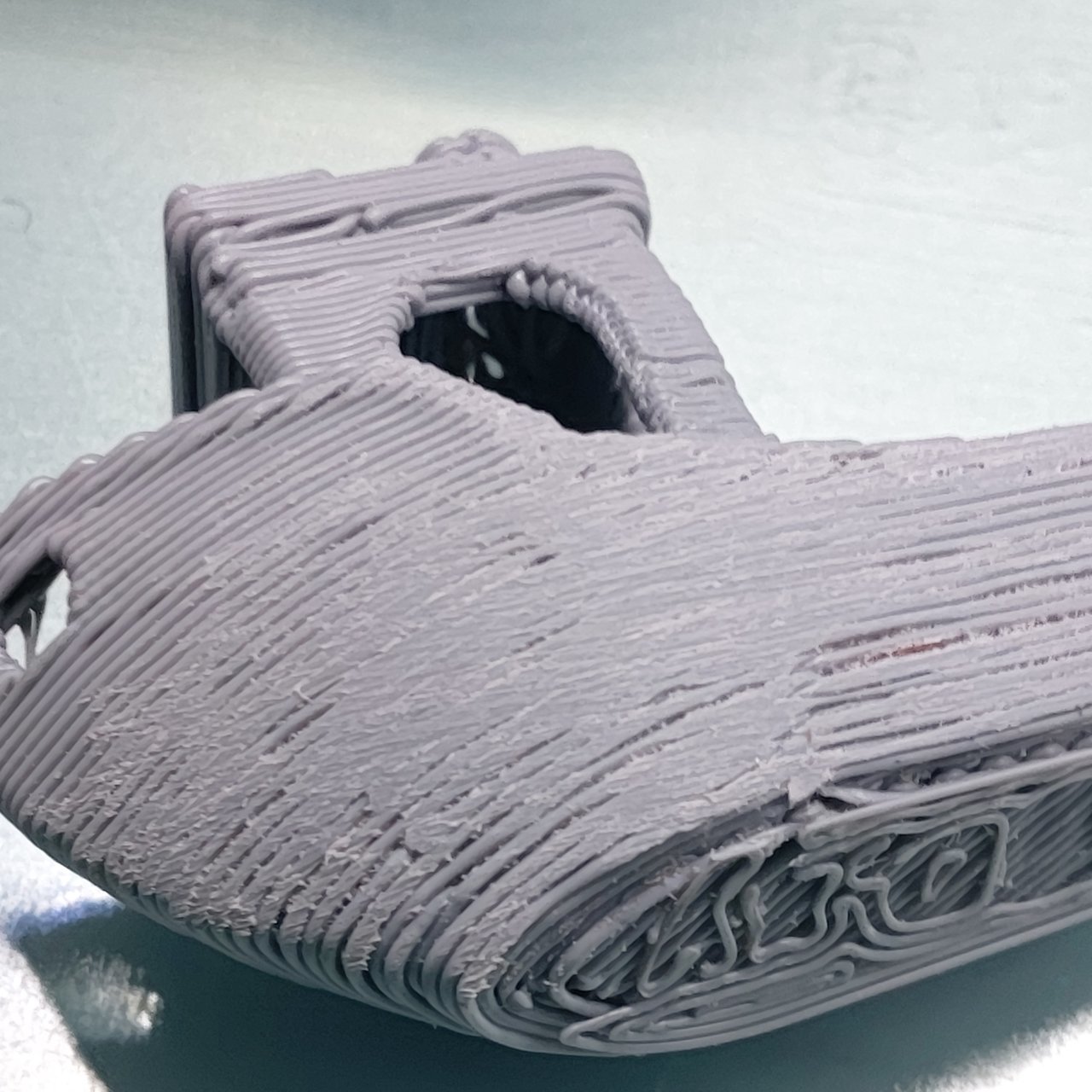

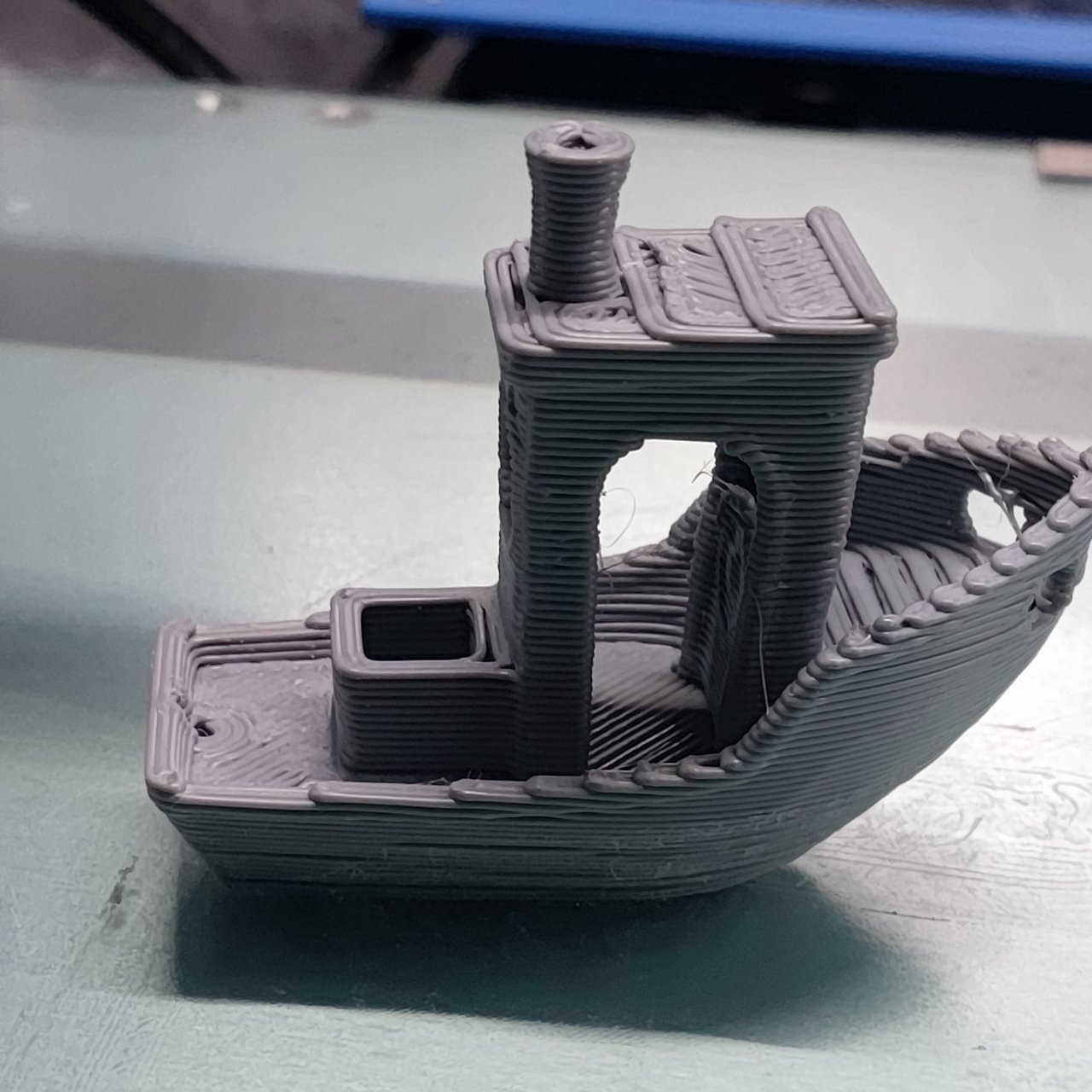

    My first print using ASA, just using recommended temp and speed settings. It didnt turn out too bad.
    .8mm nozzle
    .6mm layer height
    .8mm line width
    25% infill
    I actually had to lower to temp to 235 °C probably becase of the ambient temps in the chamber being so warm I dont need to have the nozzle as hot which is a good thing
    Some tweaking still needs to be done.
    Also I quickly tried sanding, and wow, it's so much better than trying to sand PLA or PETG. They just melt under that friction heat, but ASA is actually sandable
    Sanded quickly
    I know it may not look good, but I'm running a nozzle thats 2 times larger than what's usually used. Also using layer heights 3 times higher than standard, so this is actually looking really good for those who may not understand 3d printing too well.

    Speaking of speed the boat "Benchy" only took 34 minutes to print, which with normal settings (listed above) but 25% infill, Cura said would take 1 hour and 25 minutes so almost 3 times faster.

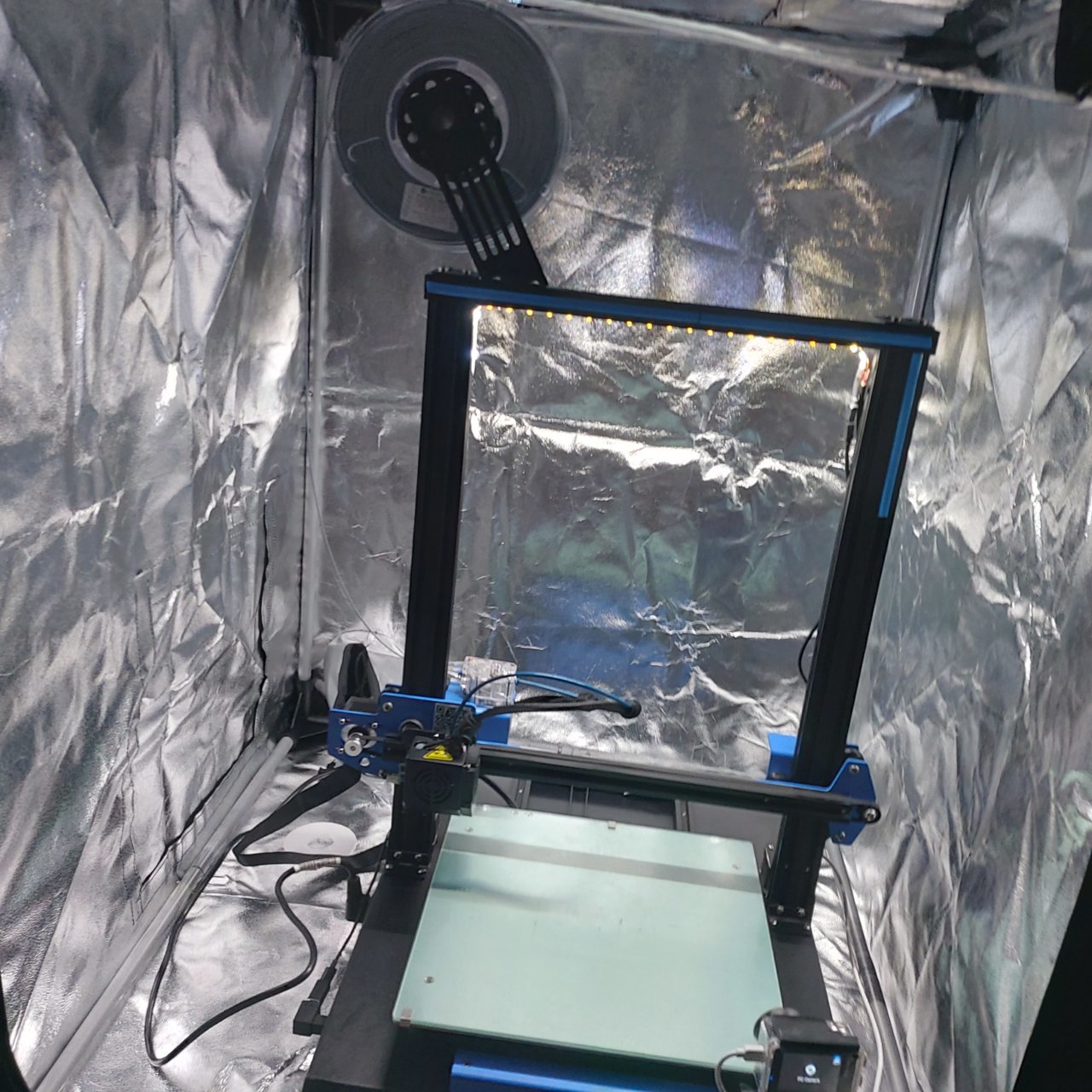

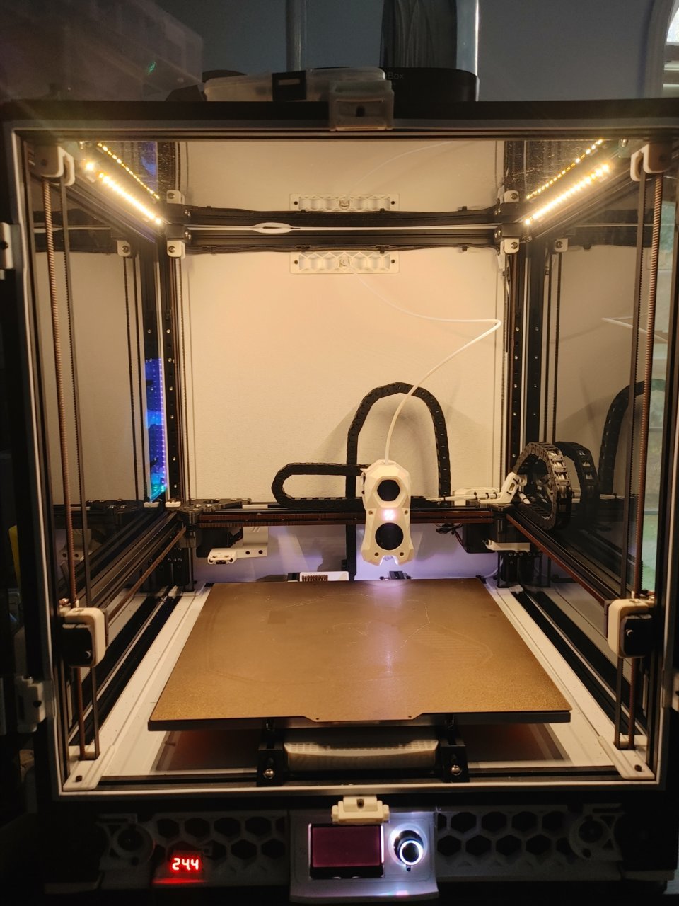

    Also got the chamber set up as well, and oh boy she holds some heat.
    I guess I can call it hot box now :rofl:

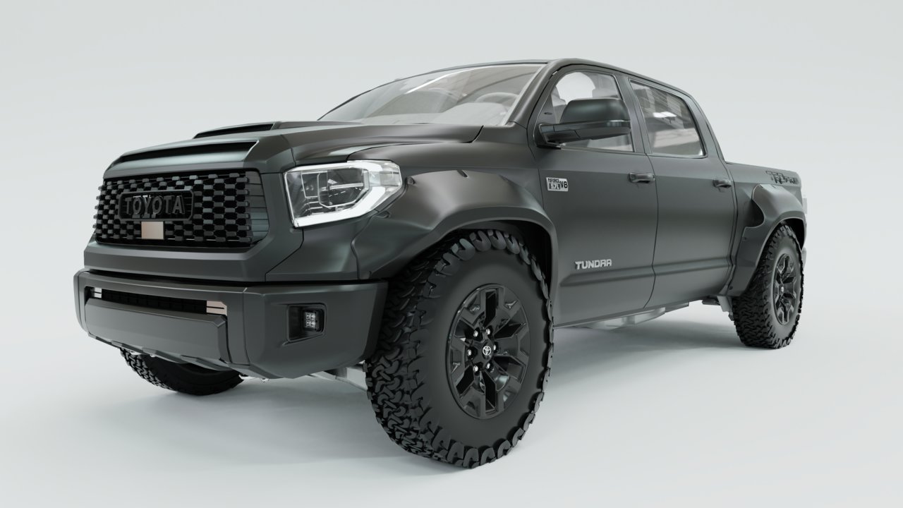

    Update!!
    here's some renders
    Almost done just have to do the cutout for the fuel door
    Im excited

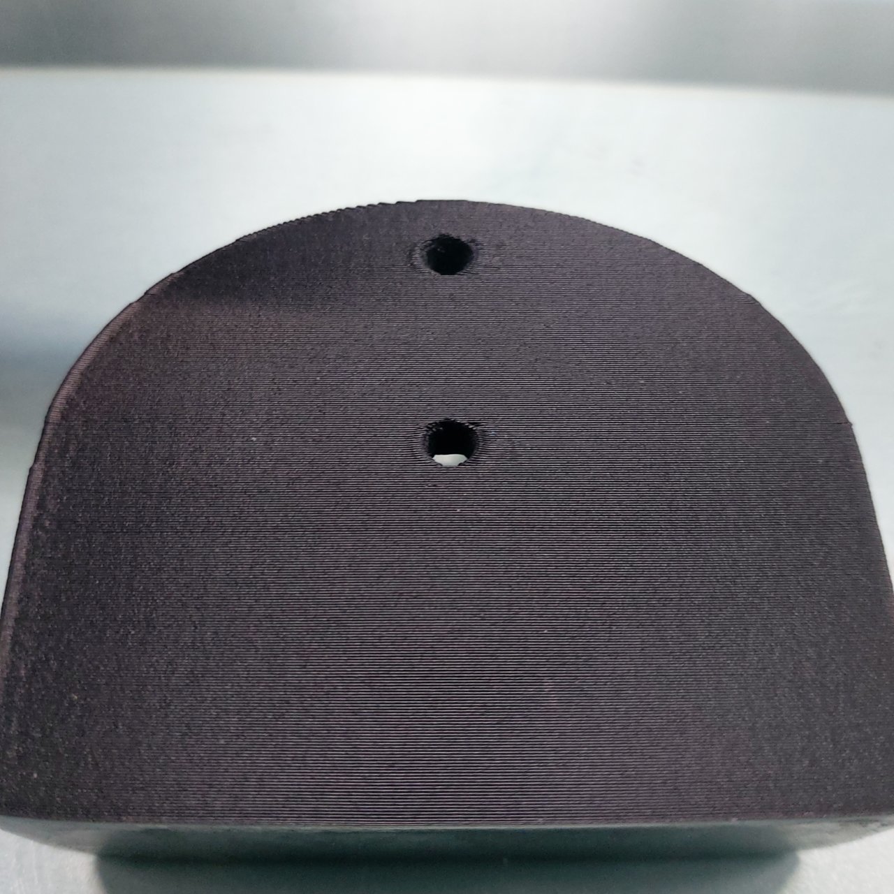

    Finnally cut out the gas door,
    And some more renders:

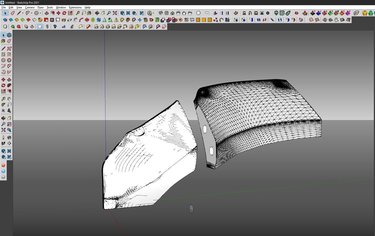

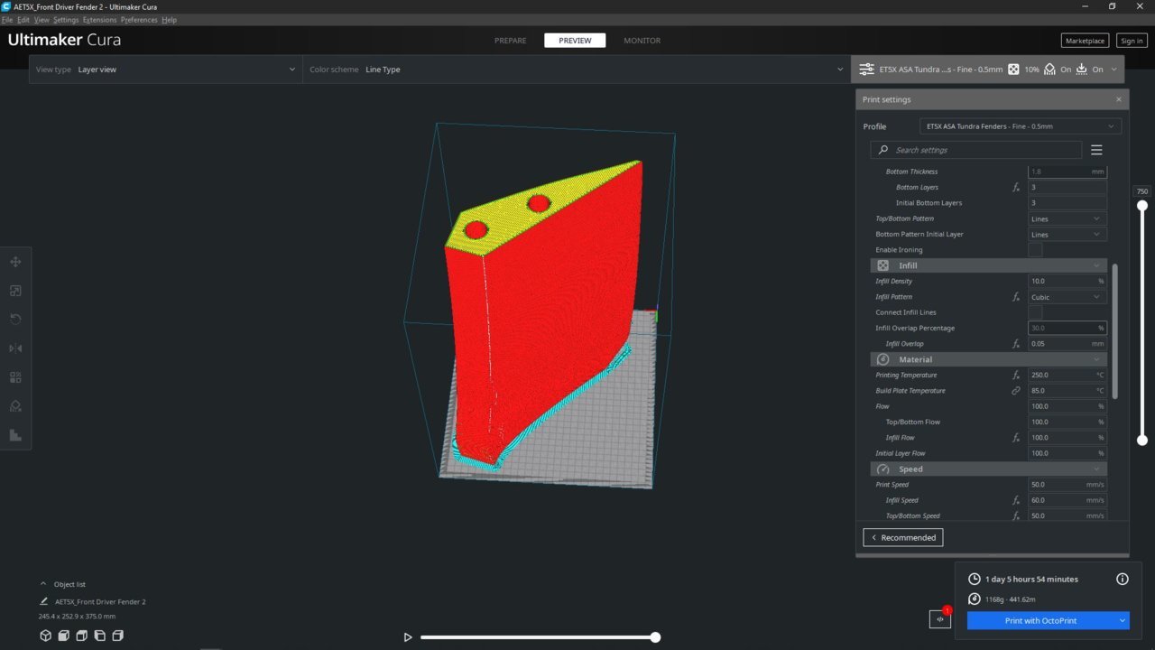

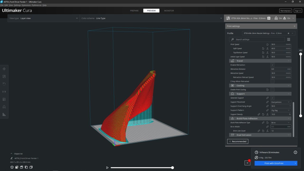

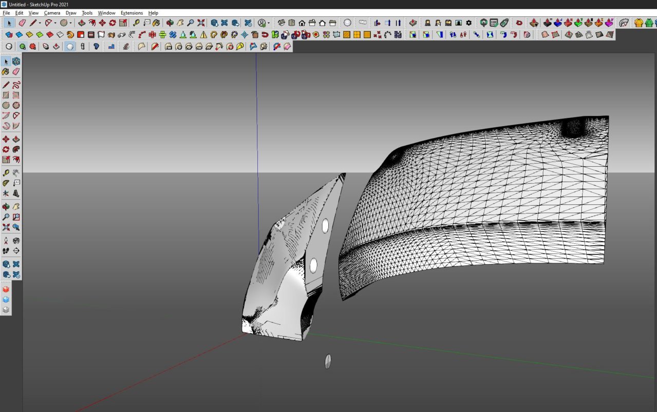

    Update: Finally getting the fenders cut and adding 1/2" alignment dowel holes
    I should start printing the first piece of the front driver fender soon tonight.

    And yes for those wondering I just started building a Voron 2.4 350x350x350. The frame kit came Monday and motion parts are on the way. So this poor printer won't have to suffer too much longer :rofl:

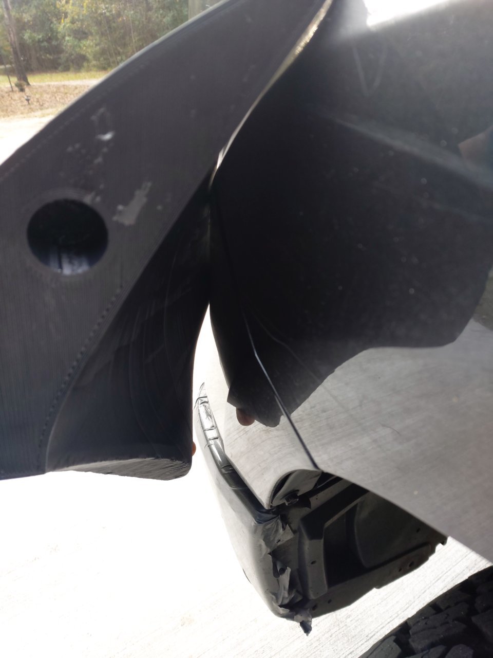

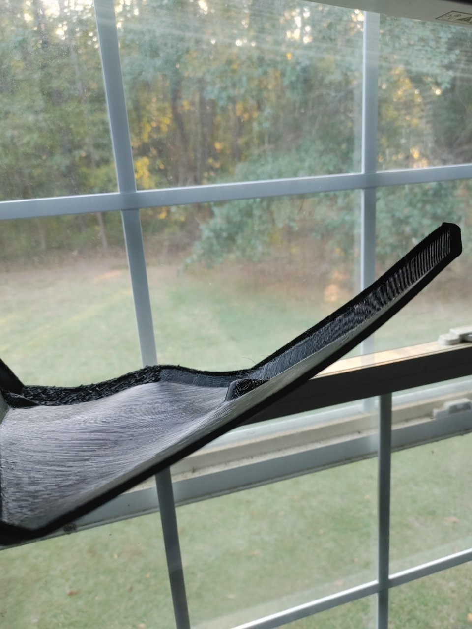

    Welp, misson failed....

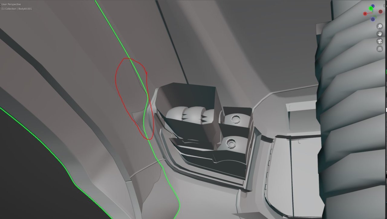

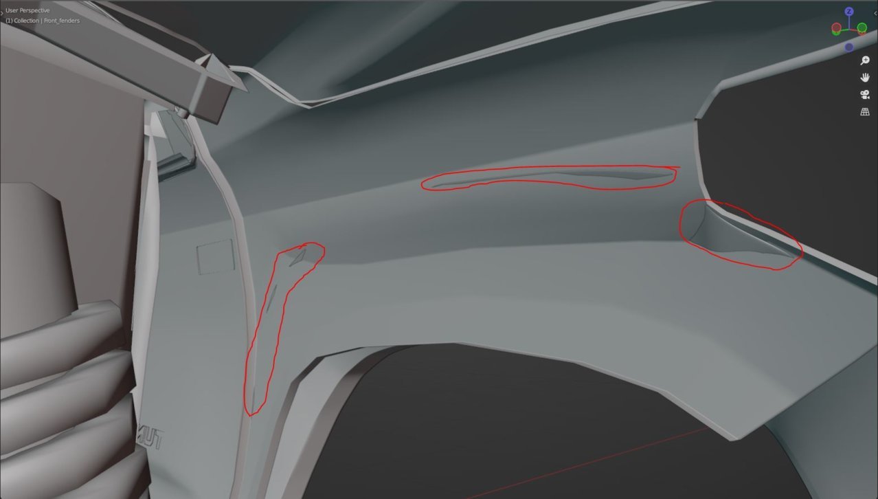

    The thickness modifer I used the take the 2D mesh and make it a manifold 3D object intersects the model and I over-looked it so it doesn't sit flush on the real truck.
    Back to the drawing board:frusty:. This is easily fixable though.
    On the bright side the bodylines match up well.
    But this is the beauty of 3D printing I only used about 620 grams of filament so around $20 worth. Plus it requires no man power to prototype. So who's the real loser?
    (My wallet:spending:)

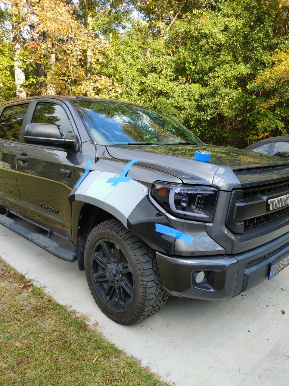

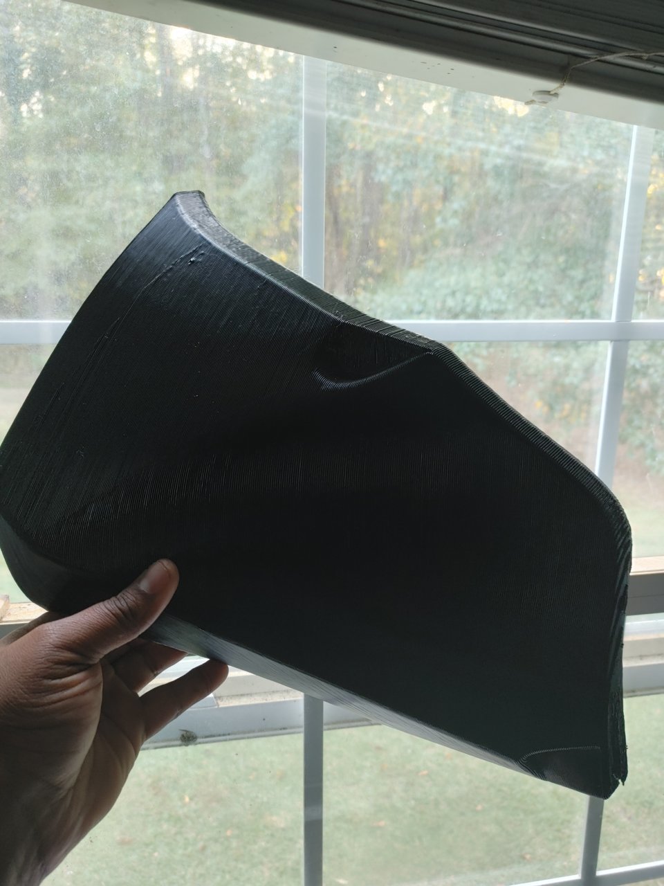

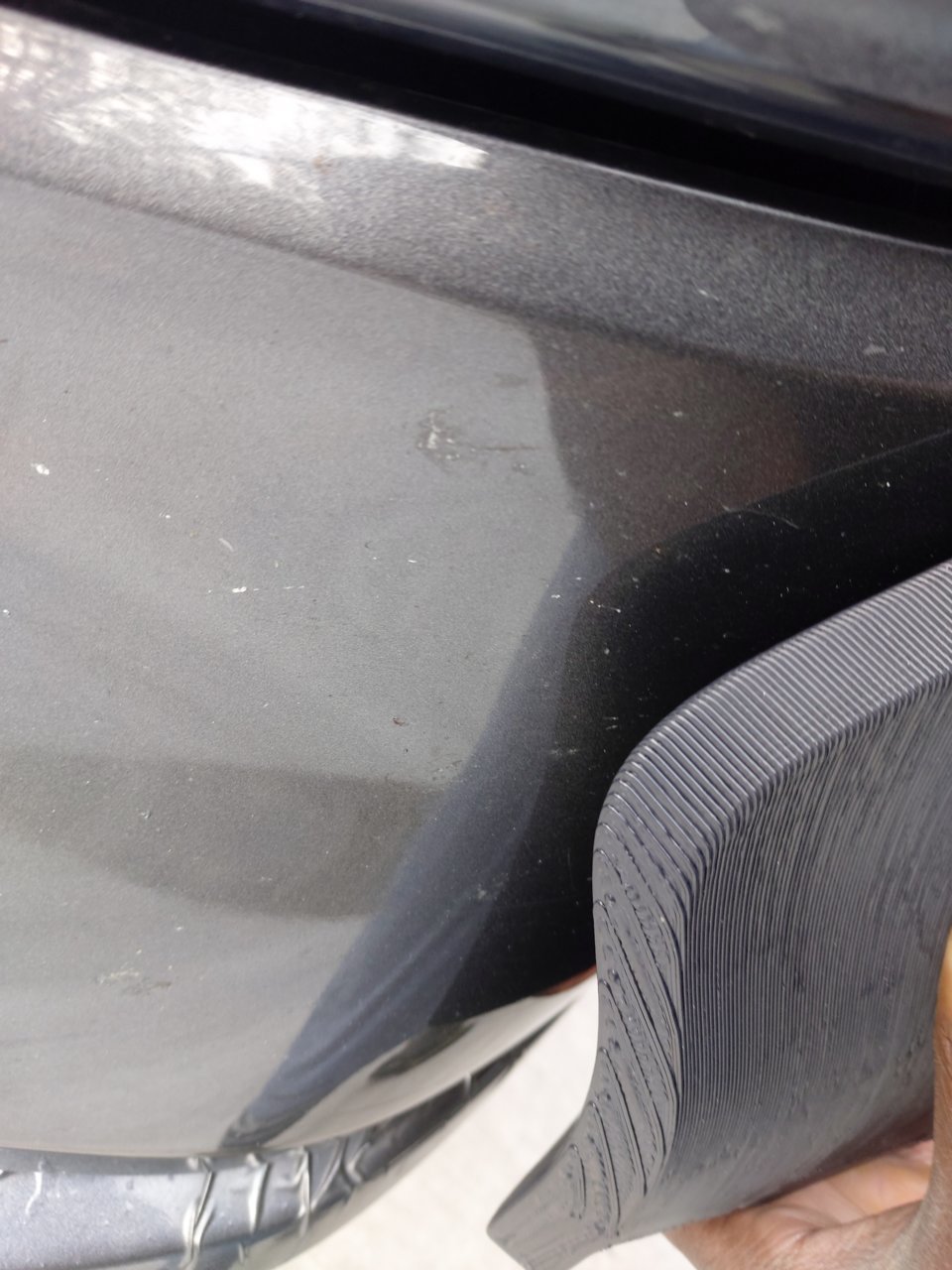

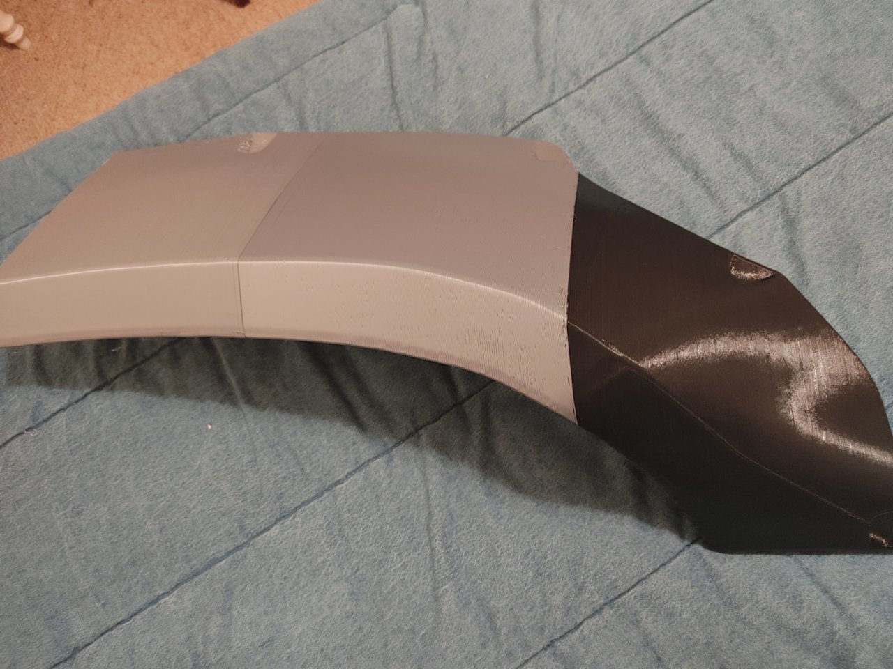

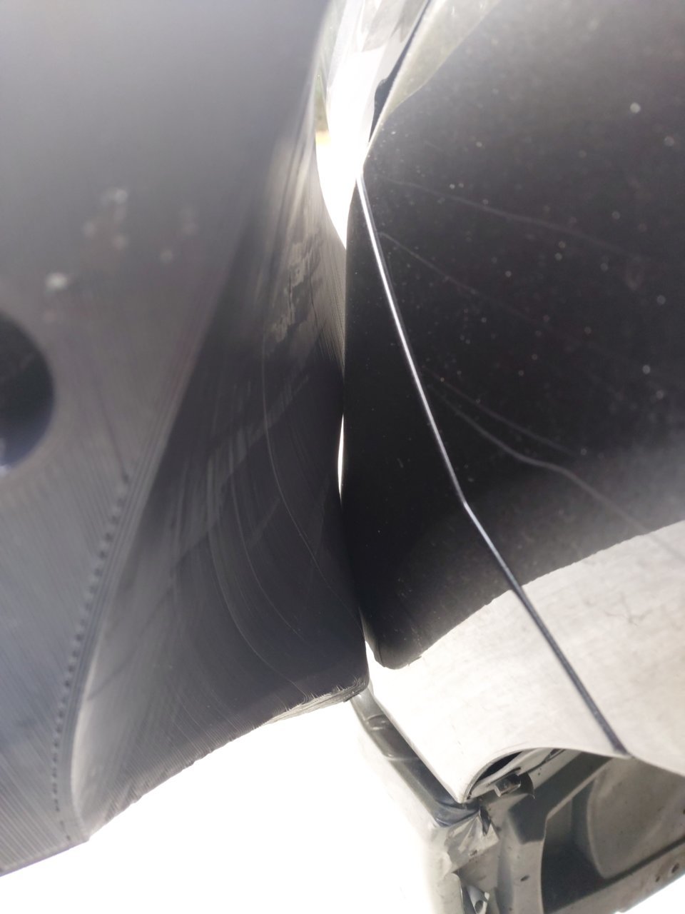

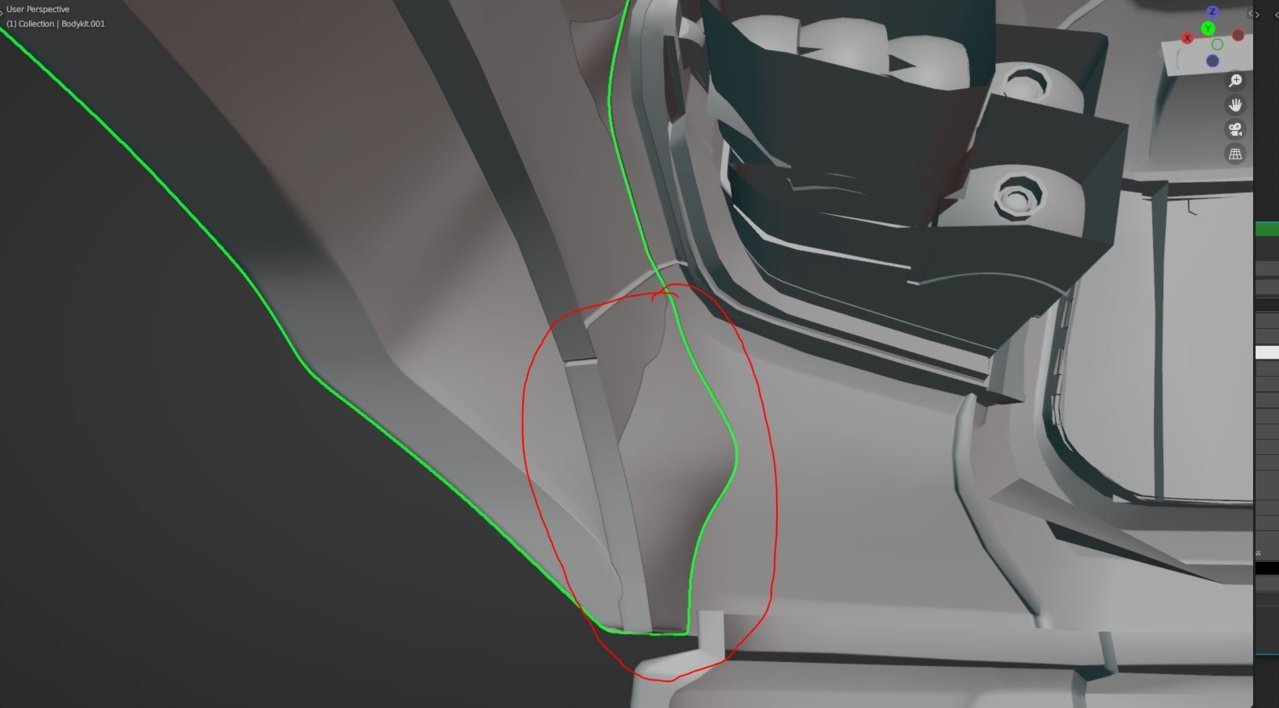

    I had a eureka moment last night and fixed the problem with the parts being printed too thick, using a program called Autodesk Meshmixer I was able to thicken the 2D mesh to be just 3mm thick which is perfect for this application.
    I have matched it up to my truck. Just didn't take pictures. BUT it fits good enough so when its time to fiberglass and do final fitment, stuff can be trimmed and sanded. It's way better than it was when it was thick and saves alot on filament and print time.

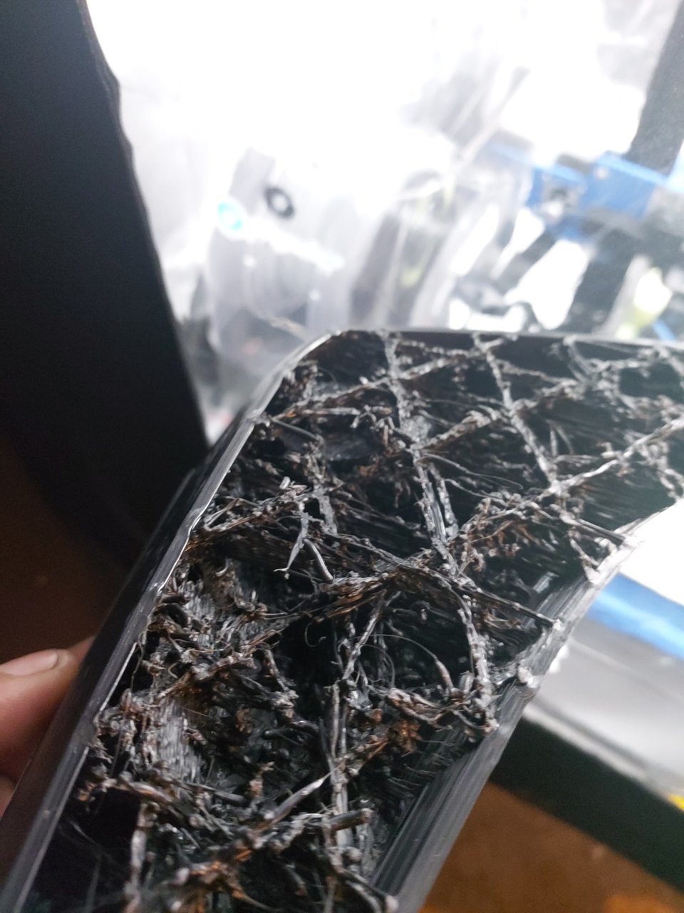

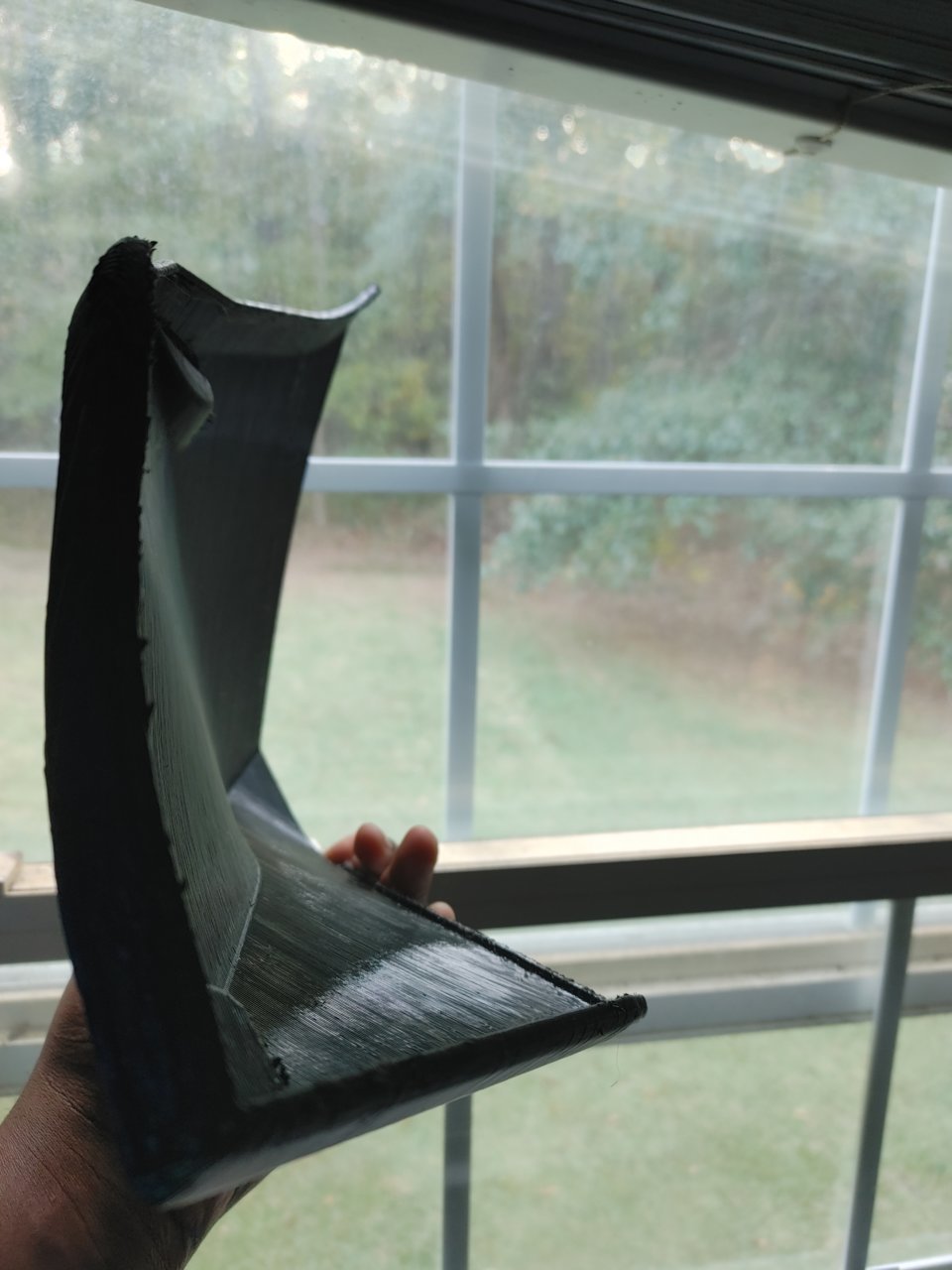

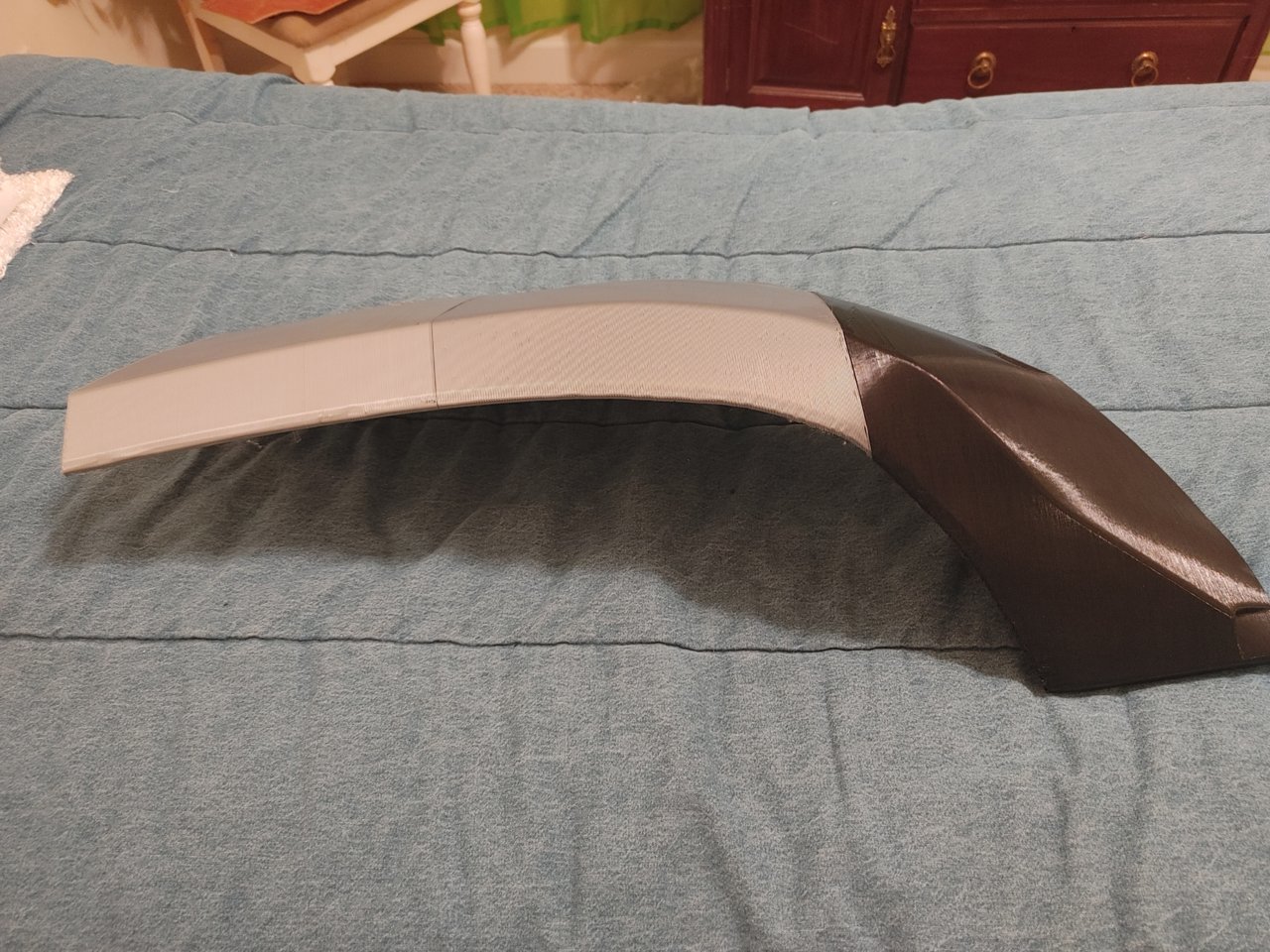

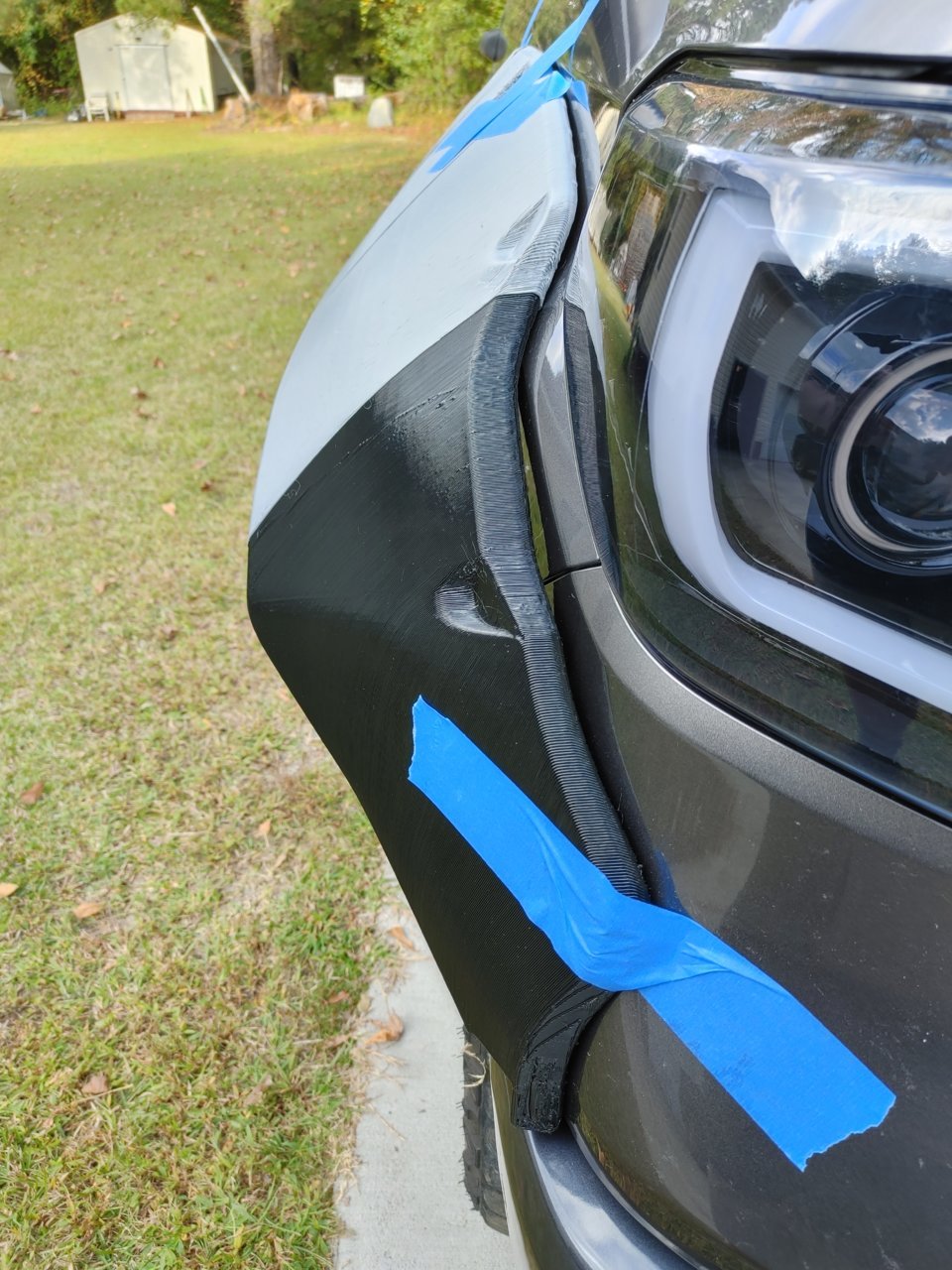

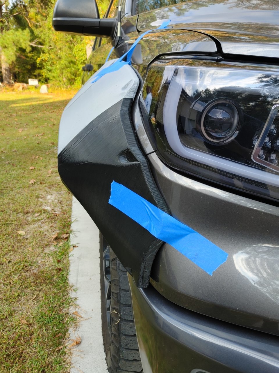

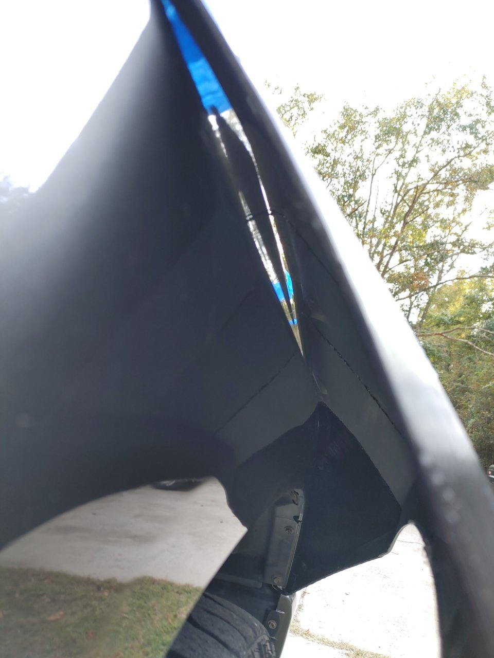

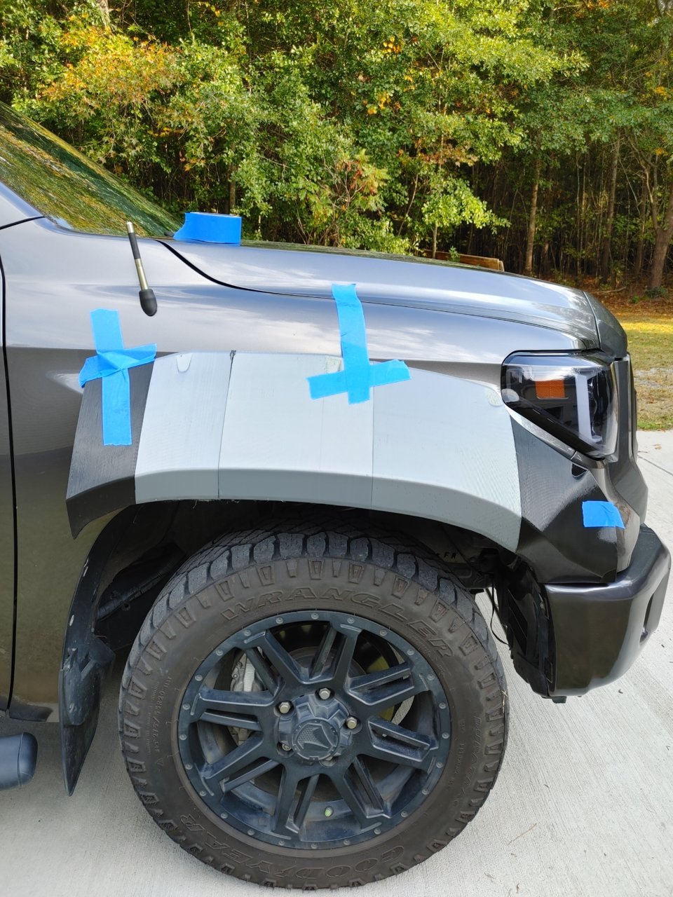

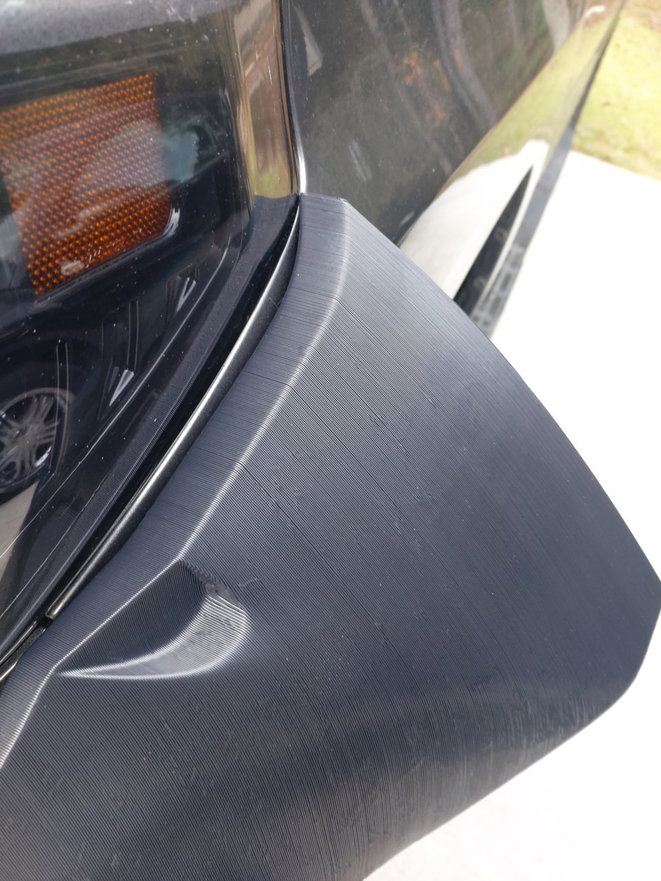

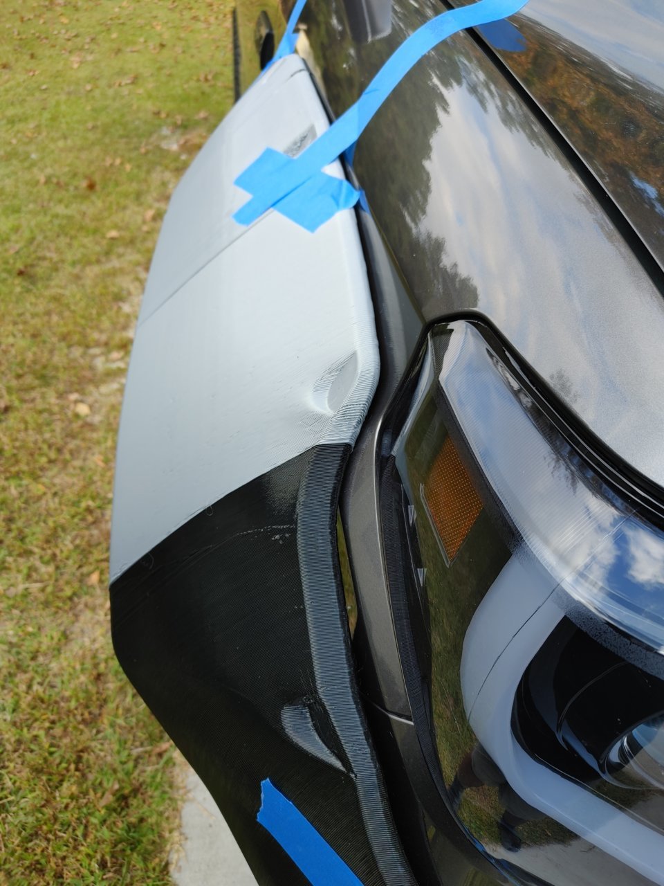

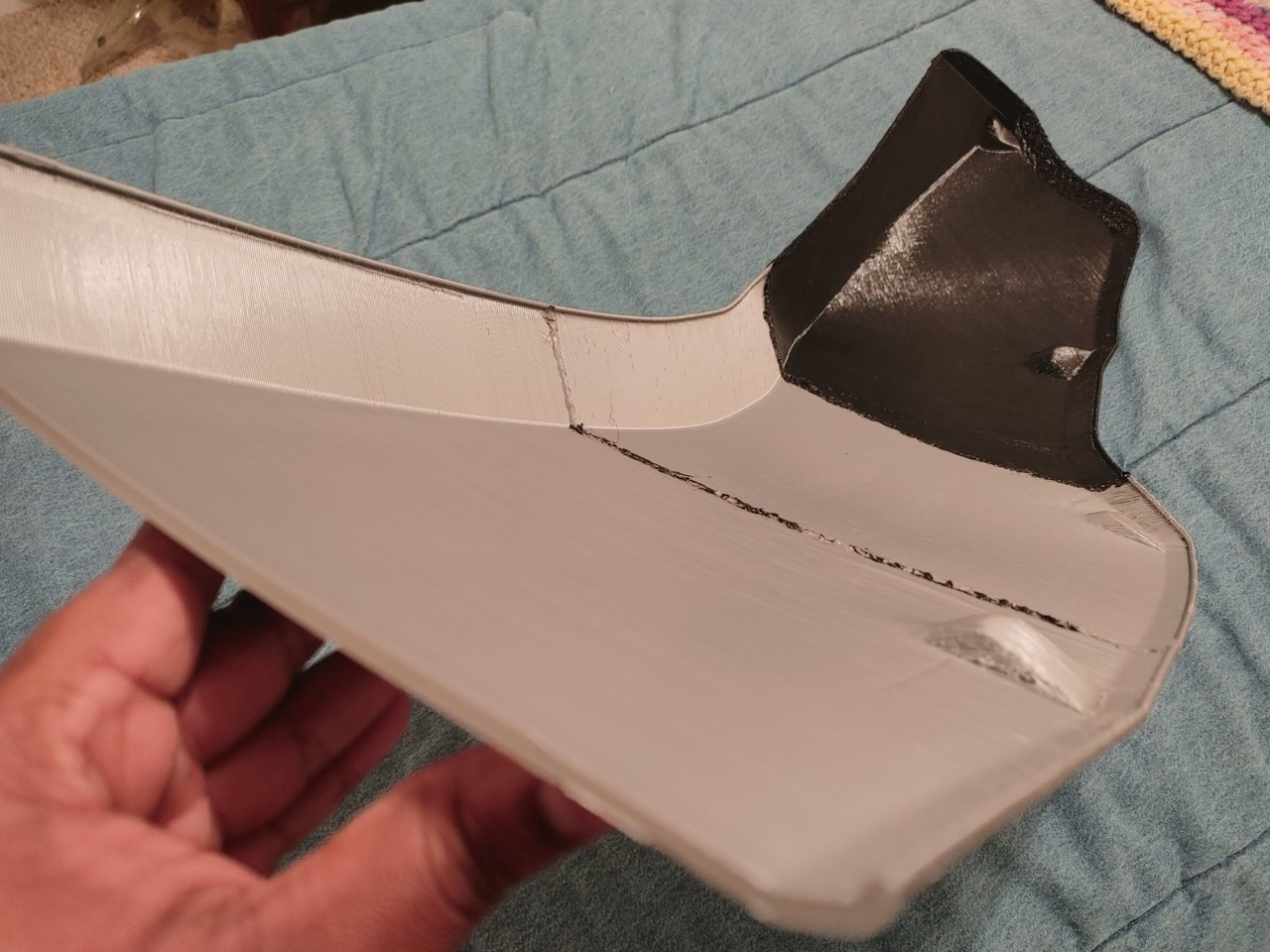

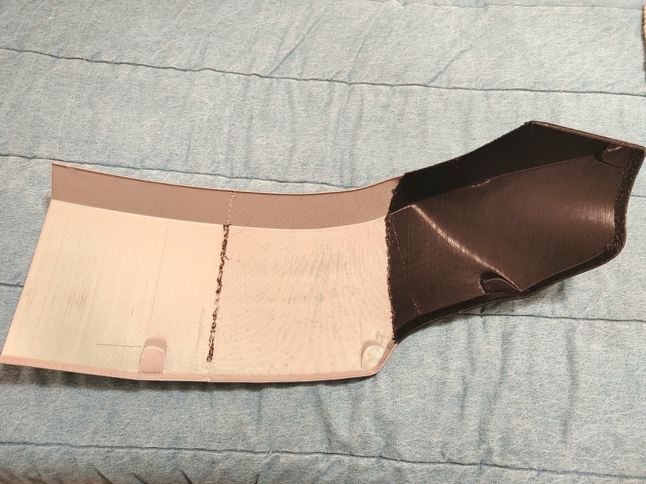

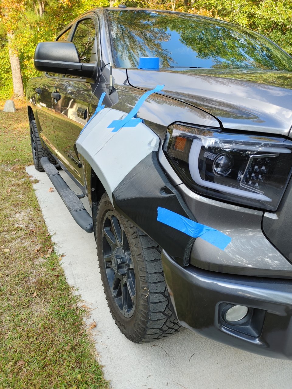

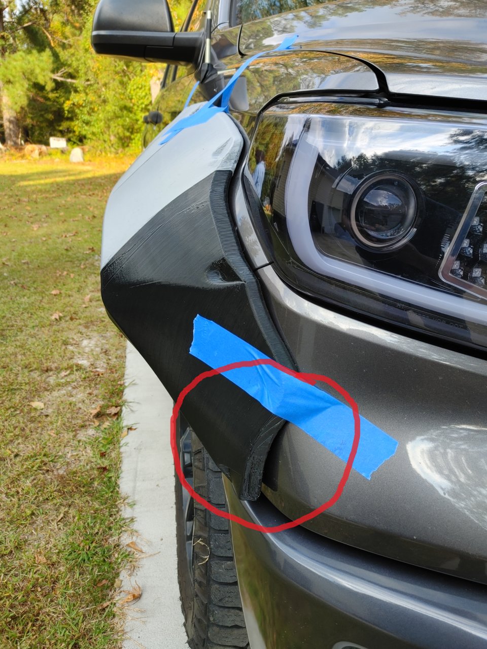

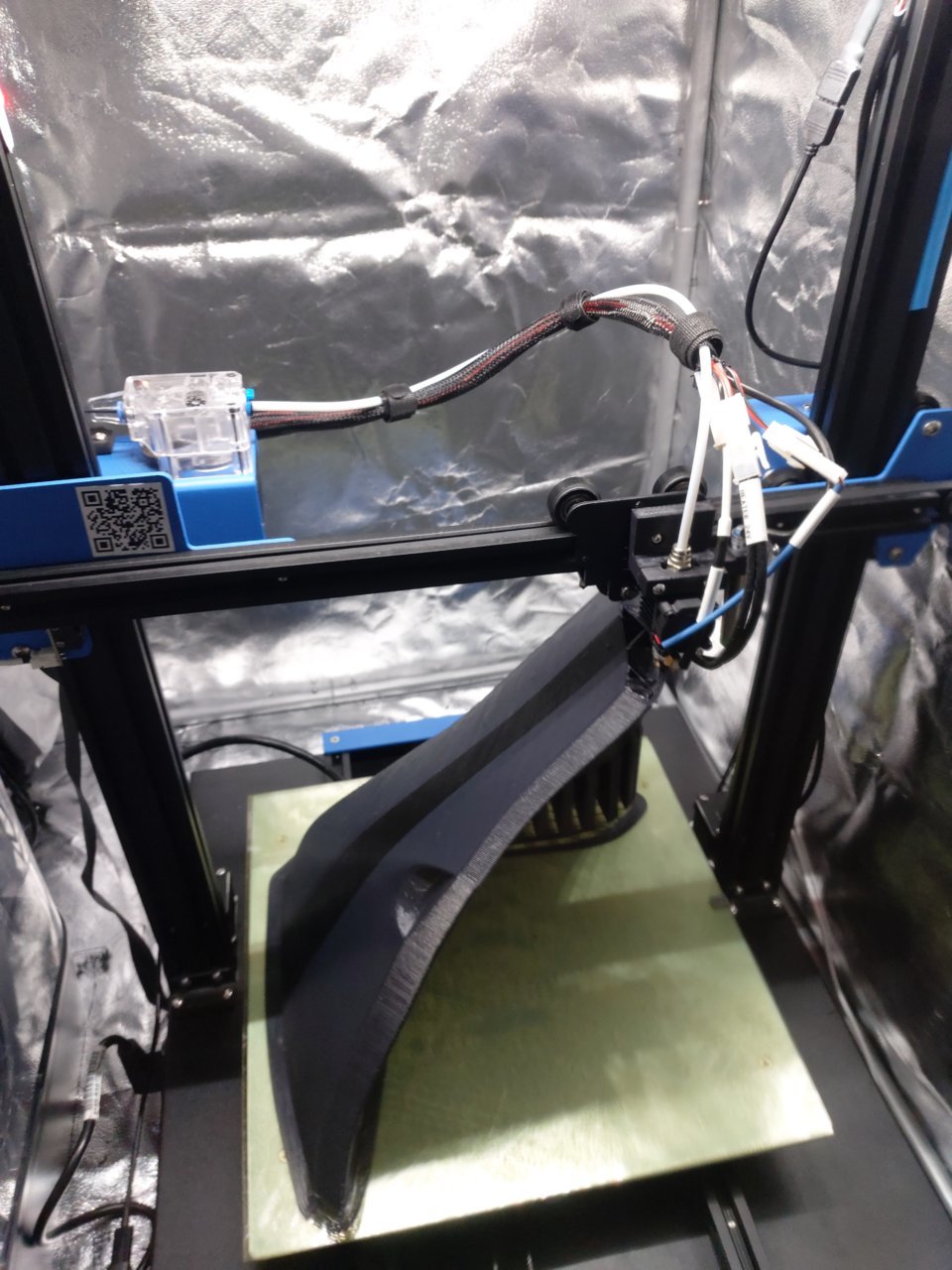

    Update: I got 3 pieces printed and melted together!
    So far so good and it matches up fine. The front black piece needs a bit of cutting on the part the touches the truck other than that the 2 grey pieces sit flush to the body. (pictures tomorrow when there's light out.)
    The inside of the fenders are just melted with a soldering gun, but ill use plastic weld or CA (superglue) on the visible side.
    Passenger front fender:
    20221010_201739.jpg 20221010_201729.jpg 20221010_201718.jpg 20221010_201710.jpg 20221010_201658.jpg

    I should also mention that the black is the Final PETG material I'll be using the grey is just PLA I have just sitting around.
    I'm just testing with random PLA I have laying around to using it as a fit test piece and probably testing the effects of resin on the PLA and PETG for the fiberglass encapsulation step
    I only bought a 1kg spool of Polymaker Polylite PETG to test how it prints on my printer and dial in settings. I ended up using the whole spool dialing in the settings and printing the first part which took over 530g of filament due to the weird shape and the amount of support it has to print. that piece took 10 hours to print while the 3rd piece only took 2 ½ hours and only 300g because it has little to no over hangs.
    given everything goes to plan, theoretically I could have a whole panel printed in 3 days (at least the front ones). (I have yet to cut and slice the Rear panels yet)

    looks really good:
    this is not the final position exactly, but gives me and y'all an idea.
    There's a bit on the underside that needs to be shaved down but I'll probably do it after its fiber-glassed.
