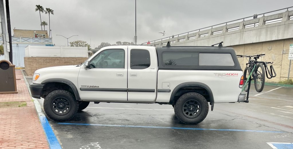

    I got my 5100s and 2884s on last weekend. What a difference! I may do 4600s on the rear. This is after a week of settling, the ride is awesome. Thanks @shifty and @Iamsecond for the insight on this combo!!

    Is it just the angle of the pic, or are you squatting in the rear about 1"?
    4600 vs 5100: Think of them as the same shock, the latter has adjustable spring cup. But Bilstein doesn't recommend using anything except the lowest spring cup (circlip) setting if using lifted springs with the 5100. So think of them as the same.
    If sticking with stock height springs, 5100 is your better bet because you can adjust ride height up or down by changing circlip. If going with lifted springs, since you've got to use the lowest setting, it essentially comes about looks and/or future flexibility.
    Basically, you nailed it in the latter sentences you wrote.

    @shifty` yeah she does have a little squat to her, but when I got it aligned they made sure ti let me know I need rear shocks, which I think is part of it along with the topper
