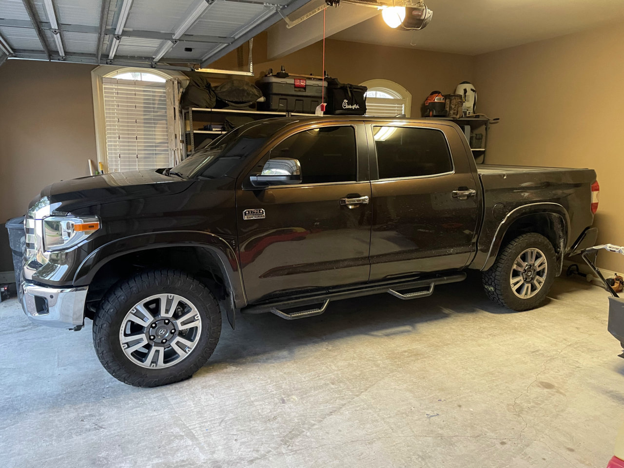

    Installed everything last night, drove great on the way home from our shop. Still need an alignment and tires mounted. The smallest things seemed to have been a pain in the a$$. The driver side nut on the differential drop, and the sway bar bolts on the lower control arms. Took me 5 hours by myself to get everything swapped out from start to finish. New leaves and shocks on the back, new springs and struts on the front (preassembled), carrier bearing drop kit, and the front diff drop. All around it wasnt too bad. I've measured the drivers side only so far. Prelift center of hub to fender 21.5", post lift 24" driver front. Prelift hub to fender, driver rear, 23.25", post lift 25.5. Time will tell, but I am happy with the results.

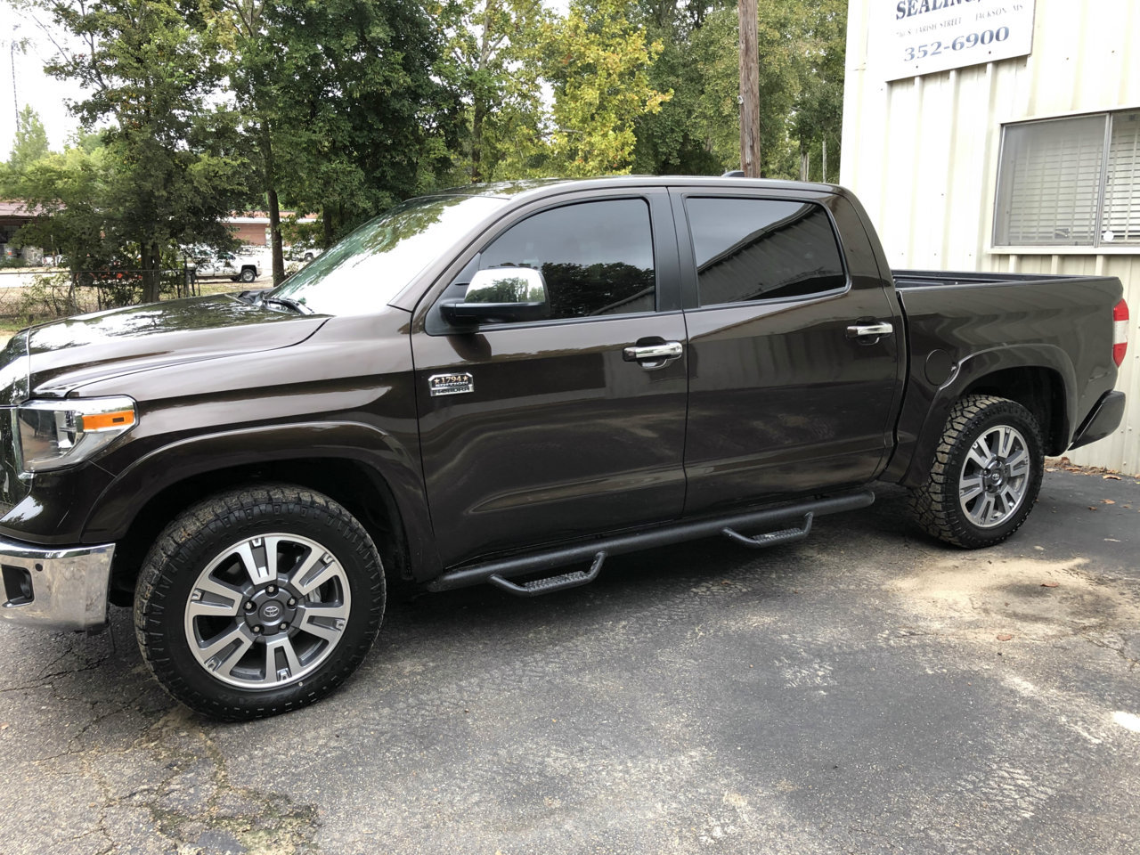

    Below are some reference pics for those debating the old man emu lift. Garage picture is after installing the 275/65R20 Toyo Open Country AT3 with the 612 springs and Dakar Leaf Packs, as well as a pre-lift picture of the same truck. Then, my 08 Tundra with 613 springs, Dakar Leaf packs and 295/70R18 Nitto Trail Grapplers. Neither of the trucks have any rub in any situation. Hope this helps anyone considering this kit. I have been very pleased with the low maintenance, reliability of the lift. Compliments those same qualities that we buy the Tundra for.

    looks great. I have used OME on other vehicles and currently have the suspension on my 4th gen 4runner. How does the Tundra suspension ride and feel, light 612s?

    It’s firmer than the factory suspension. Really only notice a difference in the rear in my opinion. I have a toolbox back there with roughly 200lbs worth of tools, Jack’s, etc and you can feel the rear over sharp road bumps like an uneven concrete joint or concrete jointed highways that have been overlayed with asphalt. The asphalt will hump up at the expansion joint. Feels like a mini speed bump. But I like it, feels like a truck should.

    Body roll in the corners is substantially less as well, doesn't bobble back and forth on windy mountain roads. Big improvement, feels way more planted.
