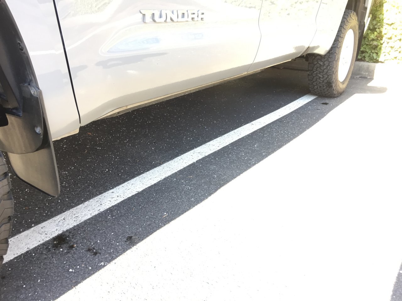

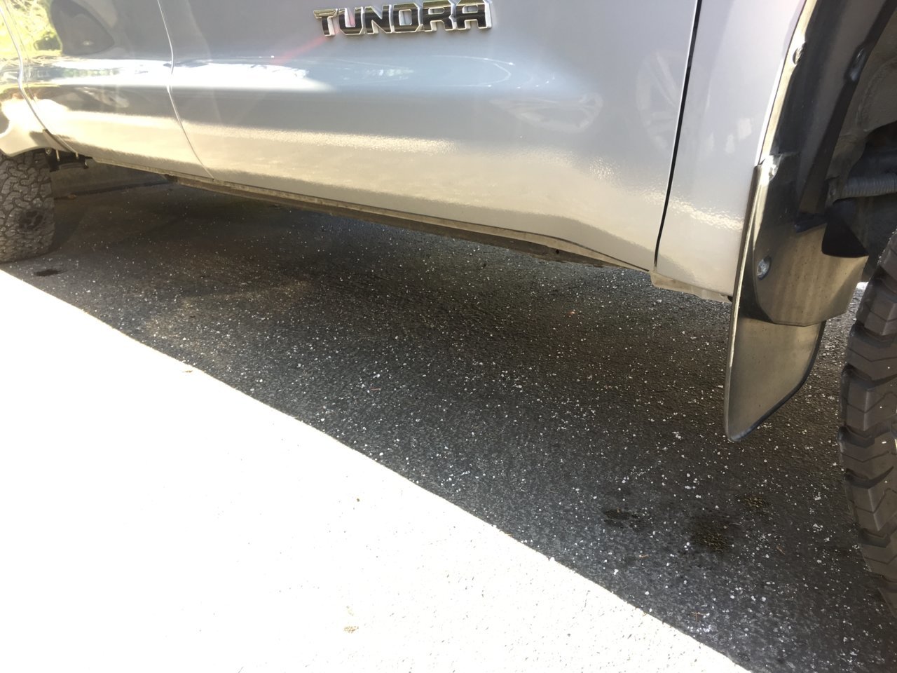

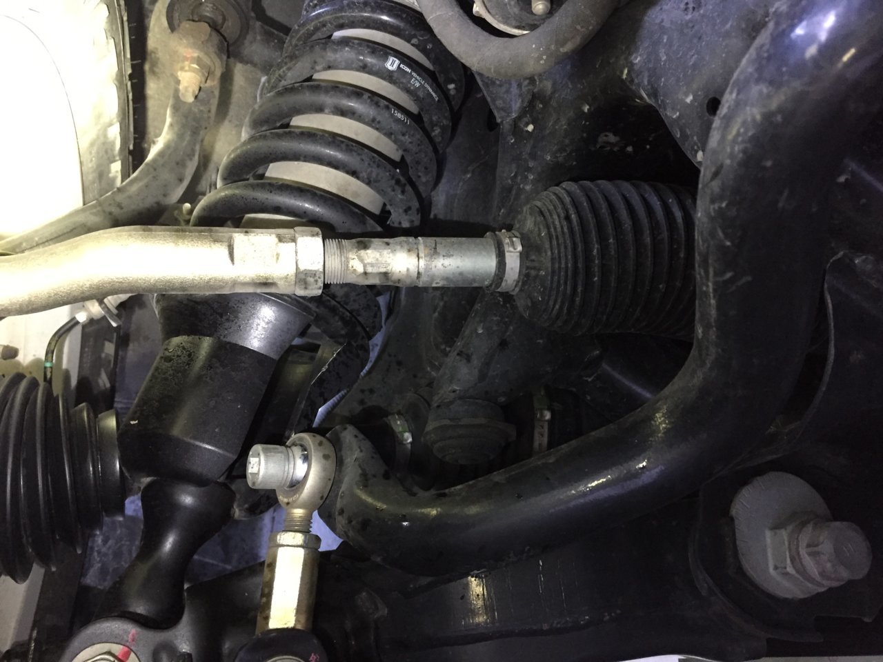

    I got back from snowboarding on Monday and noticed some sort of oil splattered around my wheel wells and underneath the truck. Washed the truck yesterday evening to see if maybe I just drove through something, now today at work I noticed some small puddles of oil at all four wheels it kind of weird spots. There is nothing I can see that is visibly leaking but since it is at all four corners I am suspecting brakes, shocks, or possibly axles. Any help diagnosing would be much appreciated. 2019 SR5 with Icon shocks, otherwise stock.

    Real main seal? impossible right?

    Icons are known to leak and squeak but all four corners at once?

    I agree, all four shocks starting to leak at once seems unlikely. Also, I have aluminum skids and there is no sign of oil on top of the skids..

    Have you talked back with Icon? What did they say?
  7. Feb 20, 2020 at 4:13 PM
    kylerocker10
    kylerocker10 [OP] New Member
    Jun 2, 2019
    #31379
    69
    Still trying to figure out where the leak is coming from, don't know that it's the shocks at this point. If I narrow it down to be the shocks leaking, then I will call Icon. No obvious leaky spots on any of the shocks though..

    I say all four wheels means you ran through something. Got it up where the car wash can't get.

    Once I forgot to put the o ring on my oil filter. Started it up and had oil everywhere. Took months of car washes for it to all go away. Maybe you ran through something and couldn’t get it all with 1 wash.
    Who makes those end links?

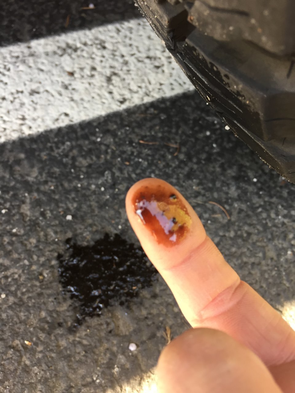

    Brake fluid ??

    They came with the Icon 3.0 coilovers.

    Oil leaking from shocks would be leaving a spot on the inside of the tires, you’re spot is coming from just behind each tire, near the outer edge. Try removing one of your mud flaps and see if there’s a bunch of muck in the void space.

    Did you tell someone at work and they are messing with you? What are the coincidence that all 4 corners are leaking. The spots on the tires look like you drove through it, ie. It was on the ground already.

    I didn’t tell anyone and it seems like way too big of a coincidence that there would be oil in the same spot on all four corners. I guess I’ll just keep an eye on it. Seems too dark to be brake fluid, would shock oil be that dark in color? Otherwise diff oil coming from axle seals?...

    @kylerocker10, smell your finger!...No, I mean dip your finger tip in the puddle and smell your finger. Brake fluid has a very distinct smell. From the color and other appearance, my opinion is that could be well-used brake fluid, but I have no theory about how, or why, all four corners would leak simultaneously. You're probably dripping something you've run through.

    My truck has under 12k so I don’t know how well used the brake fluid would be. I am really hoping I just somehow drove through a nasty oil spill and there was still enough residual oil left that it leaked out the next morning after it had been washed and driven for ~12 miles. Also, brake fluid in reservoir is clear and completely full.

    That is motor oil, IMO.
    Shock oil is a lot lighter weight and clear.

    You drove through it and it sprayed up and around the wheel wells. It will take a bit for it all to drain out.
    Been there done that.
