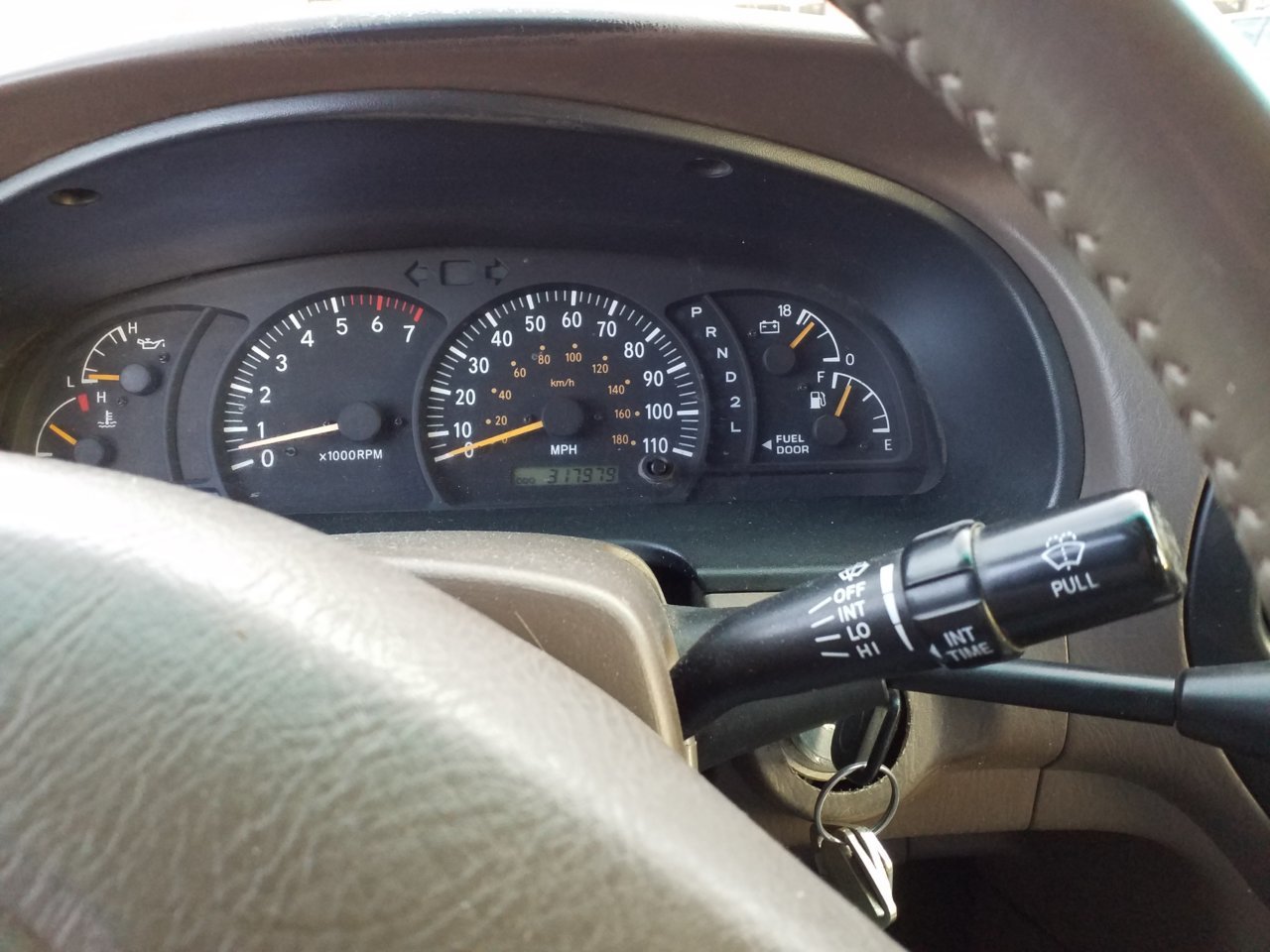

    I have e a 02 Toyota tundra sr5 with 4.7 the oil pressure gauge reads really low when sitting in idle and when I put it in drive it drops even lower iv tried changing the oil sending unit and it hasn't helped a whole lot when I crank it in the morning it climbs up to about half way a d when the motor heats up it drops I'm wondering is this normal the pic that's higher is in park and the other is in drive it has 243,421 miles15705439848504978332438703100967.jpg [=full]340144[/ATTACH]

    Pretty sure that's normal. Mine is the same. It should climb to the middle of the range when accelerating.

    Automotive oil pumps are gear-type, positive displacement pumps, and are highly dependent on the input shaft speed, i.e. engine rpm. When you put it in drive without moving, the rpm drops on an already slow rotational speed, and the oil pressure is less than before. When the oil warms up, the viscosity is less, causing less pressure to be produced by the same pump running the same speed. At idle, required oil pressure is only 4-5 psi. At higher speeds, the gauge should be near the mid-way mark. If it's less than half gauge at highway speeds, then that's not too unexpected for 243K miles. Eventually, like everything else, your 4.7L will die.

    I did notice take off and driving short distances it climbs to the half way mark but going long distances on interstate or highway doing that speed or usually runs in between quarter and half way mark. I'm no mechanic when it comes to motors all the suspension and stuff I redone myself I'm just not a motor person and don't know much about motors or transmissions

    Why we're here...to help Tundra guys learn about things they don't know about. I learn something here every day.
    Reason your oil pressure is lower once you're up to cruising speeds for long distance: Engine is finally heat-soaked, and oil temp is as high as it's going to get (lowest viscosity). Your transmission has also now shifted into the highest overdrive gear available, dropping the engine speed as low as it can go at that vehicle speed.

    Thanks that helps out a lot

    What type of oil are you running? When I first got my tundra, it was low like yours. The previous owner said it had a recent oil change but I don't trust people so I did it again anyways. After changing it to 5w30 synthetic, it came up quite a bit. It still shows 'low' at idle but it is definitely more than when I first bought it. It's all normal though.

    I use 5 w- 30 synthetic

    It's pretty normal.

    If your big end and main bearings aren't knocking then you have enough oil flow.
    If that gauge is bugging really bad you can try Mobil 0W-40. That will improve your hot idle pressure and still flow enough oil through your bearings.
