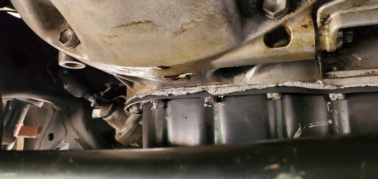

    Thank you for the heads up! After reading through several of these posts, I suppose I never considered the dowel pins to be out of spec...that's simple mechanic-ing 101 I assumed...regardless, I'm having my Indy Shop taking a look and am scheduled to drop off in a couple weeks...I'll be sure to mention the dowel pins to them!
    What's your assumption on a potential cost if it is only a Rear Main Seal? Was my assumption accurate?

    It's not that they are not set in deep enough. Toyota got a bad batch of pins that were slightly too long and cause the rear main oil seal plate to not seal properly.

    Yes sir, you don't have to take very much off so bench grid a bit off. Toyota has rectified the issue and the replacements are correct.

    He has a 2014 and I can't recall what year the dowel pins were a problem but it was for only one year. It's possible that if the plate is leaking because of the dowel pins Toyota would cover the repair. I would definitely check with the dealer.

    Yeah, I haven't had a leak since owning my 2014...after a recent oil change, I started noticing drips in garage floor...crawled under to tighten something and noticed it was the fresh oil all over the bell housing underneath...shouldn't be cam towers as that was addressed early in its life and the exhaust shields are still shiny and clean...just started and was wiped down...I'll look again in a few days as it will be a week since it was discovered...if nothing is showing, great, if there is still weeping, boo...no matter what, it will be looked at and addressed as I use the truck daily for towing and getting to work...fingers are still crossed!

    Repair involves removing the transmission. Labor time is about 5 hours and about 30min to reseal the plate and replace the rear main seal. Take the shop rate times 5.5 hours and some charges for shop supplies and taxes.
    Maybe you'll get lucky and Toyota will cover it because it's a dowel pin issue.

    I had the same issue at 50 miles with my 2015. Took it back to my dealer, they dropped the trans and pulled the rear main seal out, there is a aluminum casting that the seal is in. This casting is located by dowels. It was found that the dowels were not fully seated in the engine block which caused the casting to cock and not sit flush against the block. They had to tap the dowels in to the block to the spec. This allowed the rear main seal to sit flat and eliminated the ware due to the offset. The leak was eliminated. I have not had any problems since.

    It's not the RMS or oil pan gasket...it's an o-ring from a recirc that can only be accessed when engine is out away from bell housing...it's a simple repair but will cost $3k so I'm just living with it until I need something serious on my blown engine...oil.is cheap and so are rags...it is annoying but not worth the repair yet...

    It's engine oil as the rear plate on the block that holds the rear main seal is not tight against the block. The shop ground the dowel shorter then use FIGP to reseal. All is good for last 5k miles.
