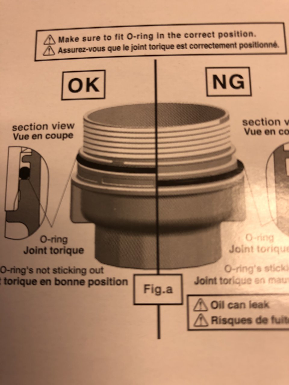

    Mmmmm. Sounds like the oil filter canister cap O ring is in the wrong groove.

    If you buy the Mama Toyota oil filter there is a picture/sketch right on the box showing you which groove the O ring goes in. I think it even shows you with a X where NOT to install the O ring.

    I'm not home today so I can't grab an oil filter box off my garage shelf. But I have found this which is the correct picture from the box. I'm correcting myself. They don't use a X but rather a NG (I'm guessing for No Good). Touche.

    received. Thank you. The truck is in the body shop. The extended stay there revealed the leak. I get it back on Tuesday and will take it off immediately. I may have done the NG version. Thanks for all the effort and info.

    Stock
