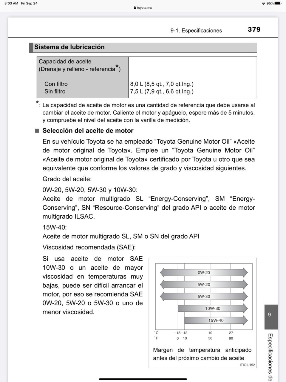

  25. Sep 24, 2021 at 5:05 AM
    #55
    Shark Bait
    Shark Bait Not new anymore
    Jan 21, 2019
    #24892
    175
    David
    2019 Platinum
    The Mexican owners manual for the current Tundra allows oils up to 15W-40. 2CBFE2C8-558A-4182-A4AF-9C7E19D6BE15.jpg
    860_UA7, juanpsi, RitcheyRch and 4 others like this.
  26. Sep 24, 2021 at 3:04 PM
    #56
    GoldenGoon89
    GoldenGoon89 New Member
    Jan 19, 2020
    #41463
    134
    Houston,TX
    2018 CM -1794 BLUEEE- 4x4
    That makes me feel much better! I really appreciate the info on this. I will be moving up in weight on my next oil change.
    Thanks again! @Shark Bait
