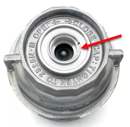

    Hello all while changing my oil today I noticed this gap(pictured) and thought my filter housing had chipped where the drain plug oil o-ring goes. Now I see if comes that way from the factory and am curius if anyone know the reason why it is designed like that? Appreciate any thoughts.
