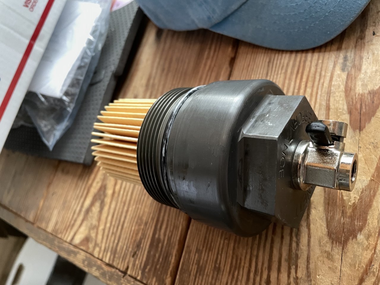

    2019 Tundra SR5 TRD Crew Max 4x4
    Oh, so the cheap knock off is the issue. I removed the tube from my plastic housing and put it in my toyota metal housing, so far so good.

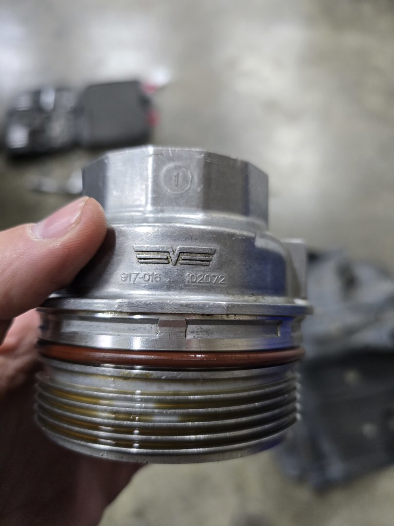

    2017 Platinum Blazing Blue
    Brothers and sisters, if you're going to do this upgrade...please for the love of all things holy just spring for the Toyota OEM part and not some cheap version. I just bought my 17 Tundra and during my first oil change the cheap garbage cracked in two when I screwed it back in! I've never seen anything like it, and now my truck is out of service until I can get a replacement. Be warned! 20241219_182437.jpg 20241219_182447.jpg 20241219_182602.jpg

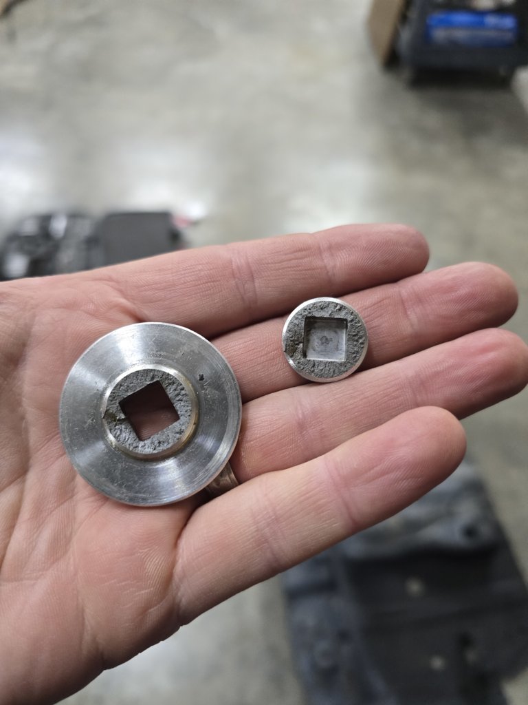

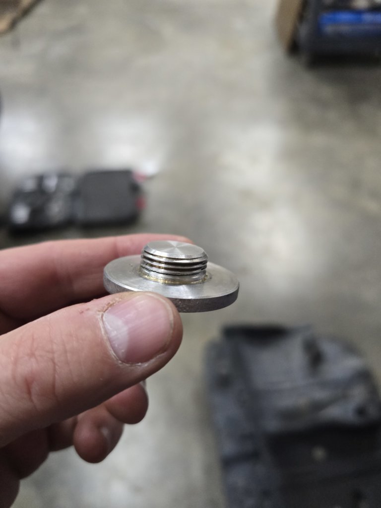

    2019 Tundra CrewMax Platinum
    Were you using the drain screw to screw the filter back in? I'm a proponent of just using the OEM plastic housing but many make the mistake of using the drain screw to screw in the filter housing instead of a filter wrench around the housing itself.
    JMGmanAZ and Fonecruiser[QUOTED] like this.

    2015 MGM Limited 2x4 Sequoia
    Eggzactly right. The drain plug needs all of about 5 lb-ft (60 lb-in) of torque.
    I put the drain plug in while holding the filter housing in my housing so that I can't over tighten it.
    No, I wasn't using it to tighten the main part. I was tightening that piece to it's specified torque and it just snapped. I've got these metal housings on 3 other toyotas here and know better. This was just a cheap Dorman replacement that came with my truck, and it's getting replaced with OEM asap!
