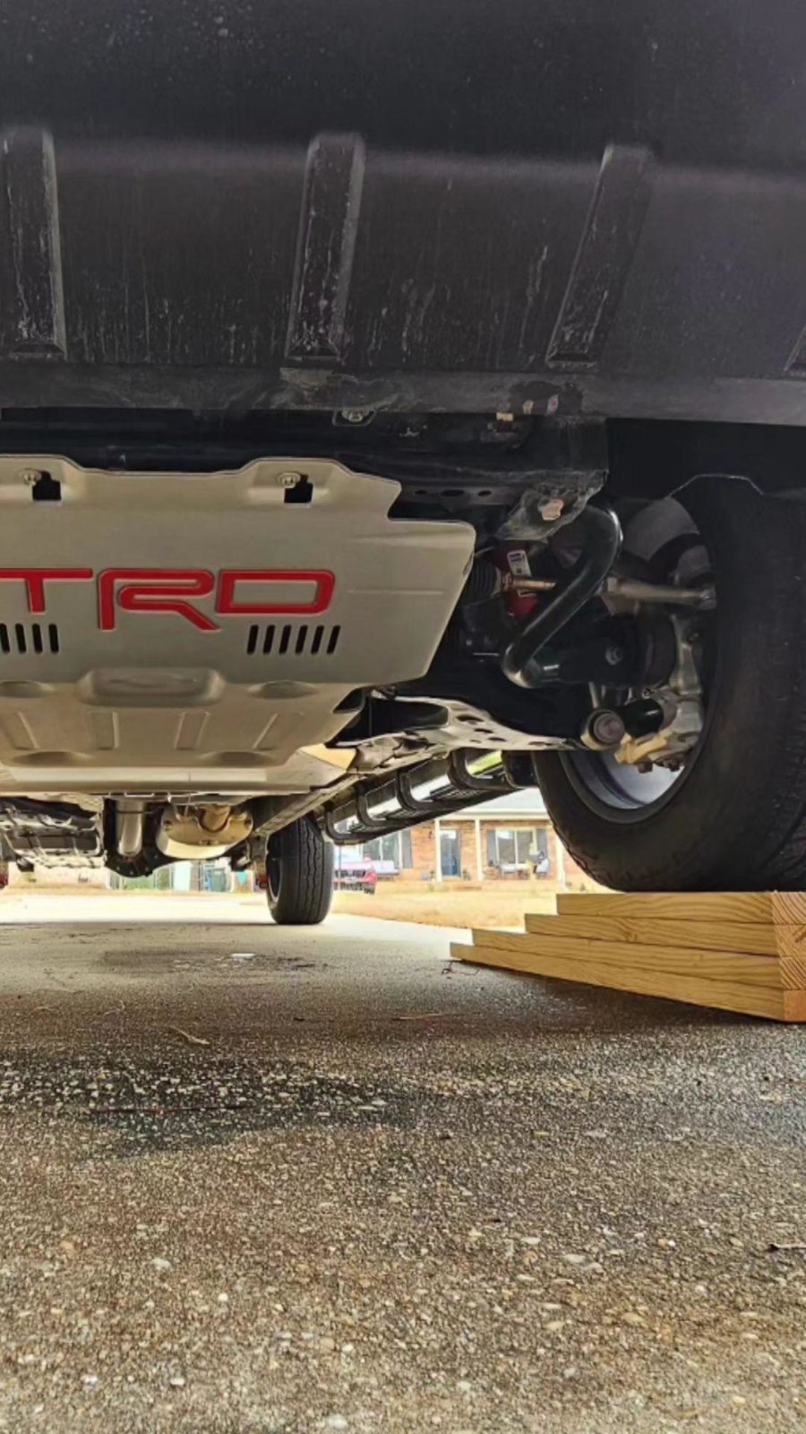

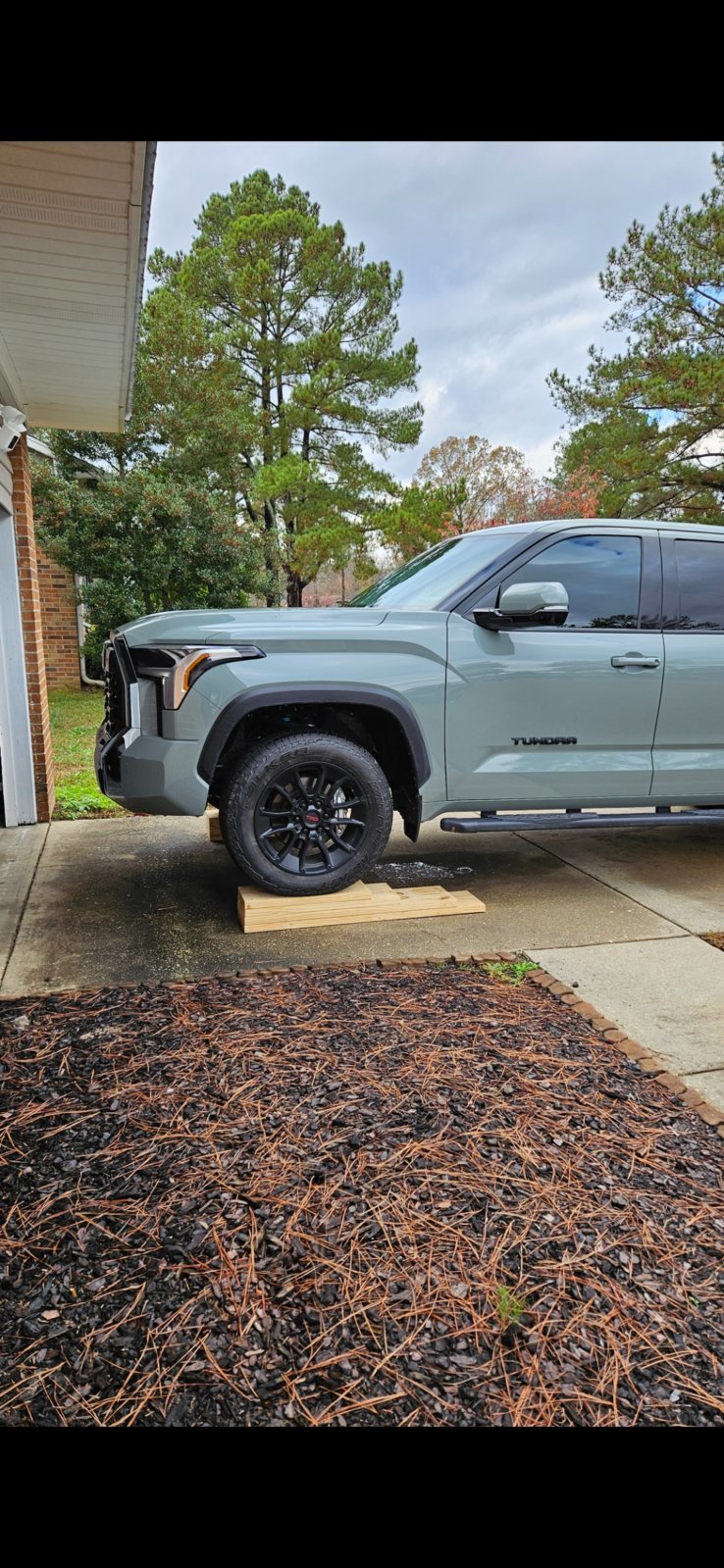

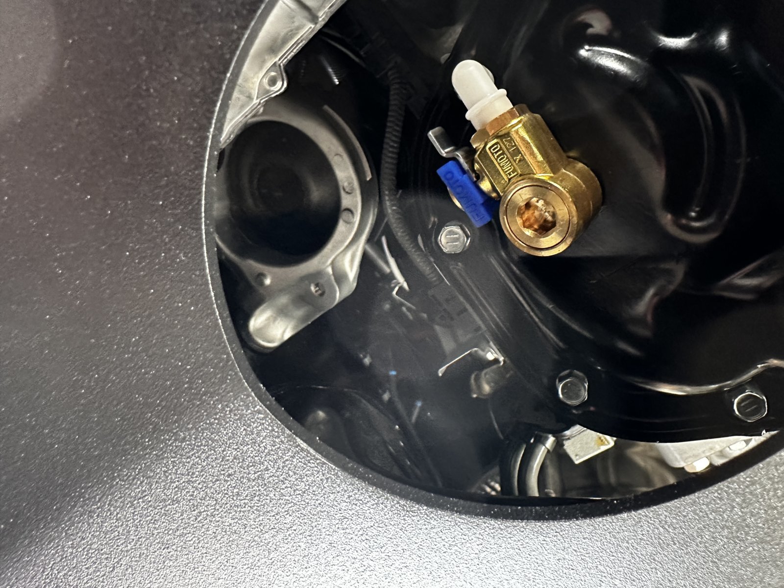

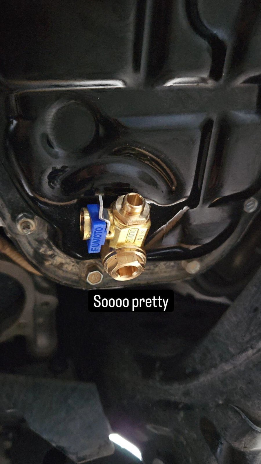

    Yup its not even a pride/paranoia thing to change it on your own it's sensible time mgmt especially with this fumoto installed and easy ramps. Drain, do some house chores for an hour, then come back and fill. Picked up a buncha oem filters...

    Hi all! Will it fit with the cat shield and skid plate on? Thanks for any replies smileytn1

    The fumoto valve? Yes. I have a millercat shield, valve is nowhere near it

    Yes, I have Talons Garage skid plate on mine with fumoto valve

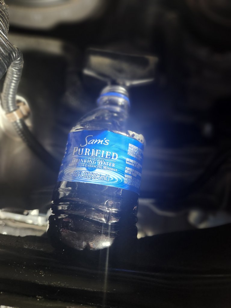

    While changing my oil at 35k I couldn't find my hose to drain my filter. I found out that a 20250722_175843.jpg 10oz water bottle fits perfectly sitting on the cross member. This does away with keeping up with a messy hose!

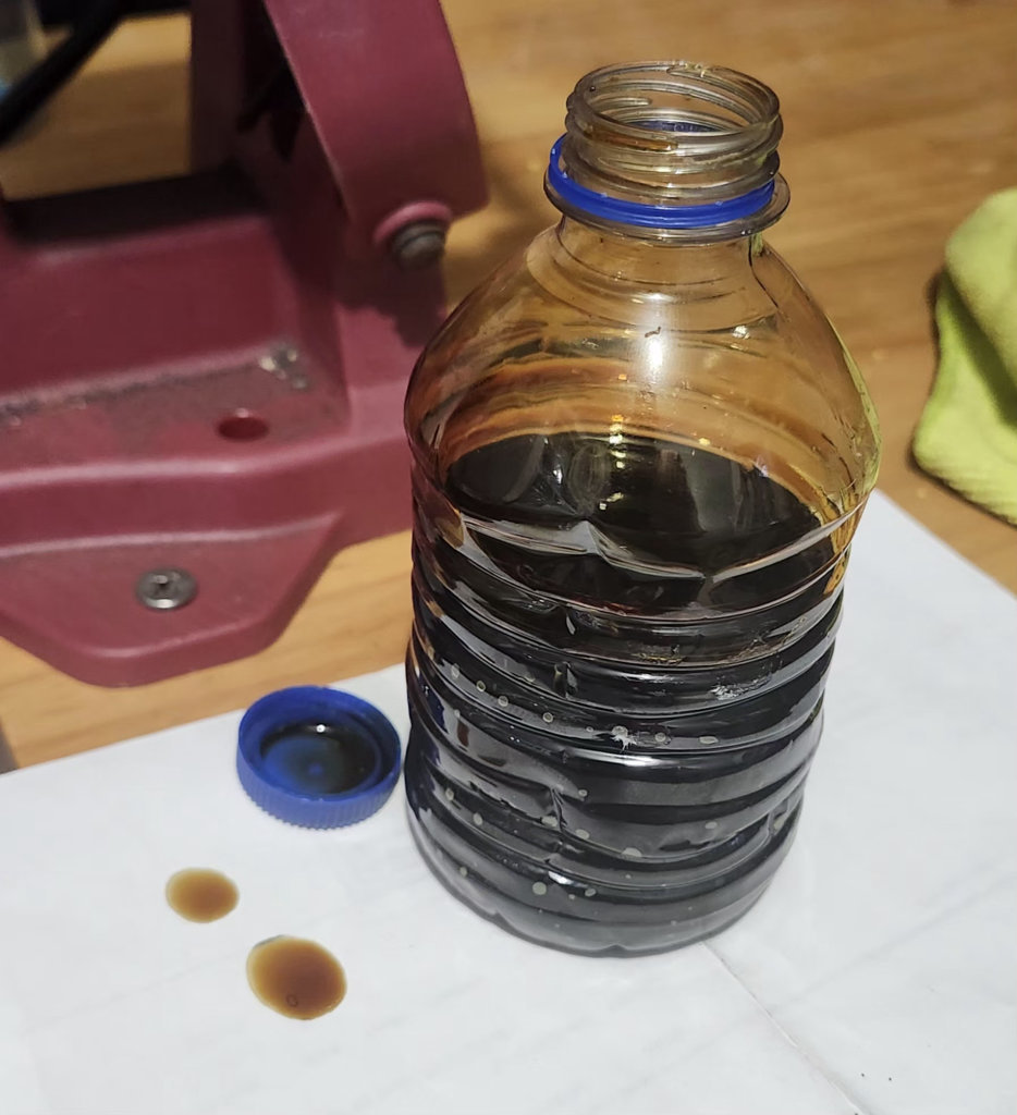

    Yes. I was thinking it was a little dark too. But it's not like my semi truck.20250724_071813.jpg
