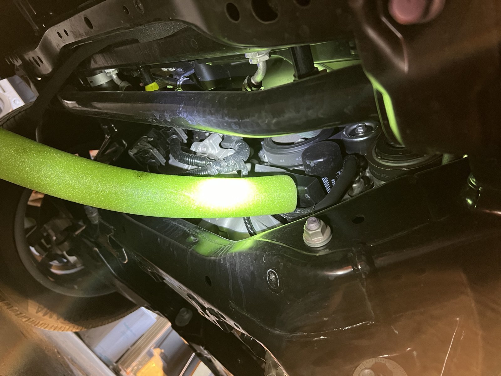

    Tip, pool noodles will work, but not that great.

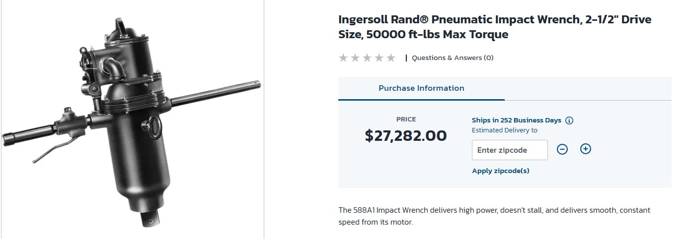

    Tell them not to use the impact on the filter cannister

    What kind of heathen would do that?!

    A 2.5 gen mechanic

    Toyota Dealer Official 2.5 Gen Oil Canister Install Tool. Screenshot (153).png

    Well, it’s is Ingersoll Rand.

    Twice now at 2K and 6K. 1) Don’t walk into your dealer parts counter for a filter. Its twice the price vs ordering it from your dealer on-line and picking it up ($6 vs $12) 2) TRD Skid plate? Remove the rear bolts. Loosen the center and front bolts half way. Roll a floor jack under with a 10x10 piece of plywood on the pad just slightly past the square impression on the skid plate.(balance point) Lift till the skid just lifts on the loosened bolts. Remove the center bolts by hand, then slide the plate to the left in its slotted front bolt holes till the plate pops off the front bolts. Lower it and roll it out. Reverse procedure for reinstall. Last oil and filter change took me 1hr. Next will be faster. For the filter drain I make a foil trough. It catches everything you spill removing the filter as well as what drains from the catch tray. Once drained it’s easily wadded up and thrown away. Hose method was messy for me. Have fun

    No. Make a trough that’s a little wider than the catch tray that comes out over the edge toward your pan. Tuck the top edge over the hose below the tray to hold it in place. (I use those precut foil sheets that fit your toaster oven tray) Shape it to catch all drips from the tray spout as well as what you drip sliding the filter out. (Tip- loosen the filter to the last couple threads and let it hang for a couple minutes to drain) After youre done it’s an easy wipe out of the catch tray with a paper towel or two. Also, only hand tighten your new filter as snug as you can. It won’t leak and removing next time will be way easier than the factory installed one was
