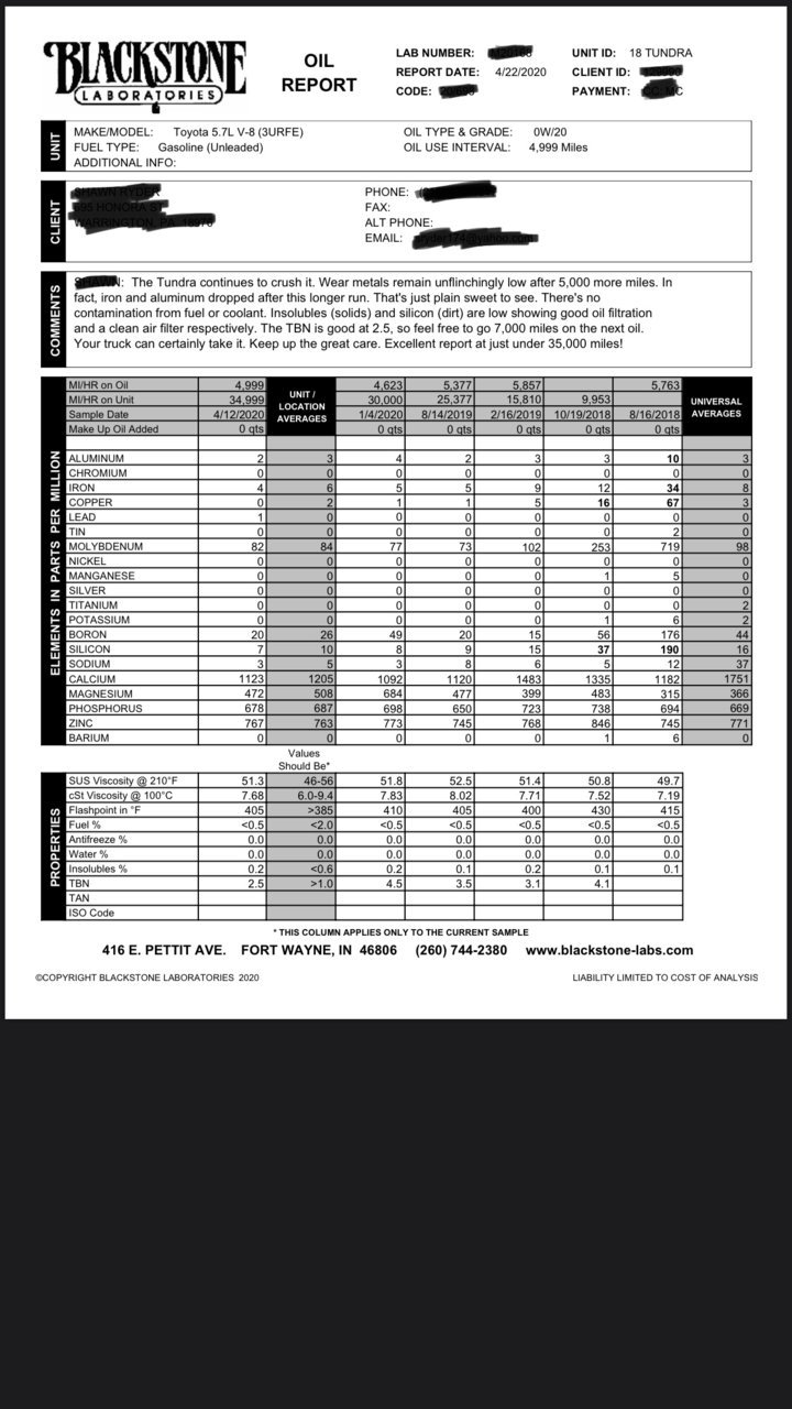

    I do 5,000 oil changes because I normally tow with my truck but haven’t been lately from the virus. But when I changed the oil last time I didn’t do any towing, the oil was still brown and I did feel like I wasted a oil change. The next service from my dealer will be changing the oil but after that if I don’t do a lot of towing I might push it to 10,000 and see what Blackstone has to say. D12D6DDE-9A59-44AA-BD19-02345A032520.jpg
