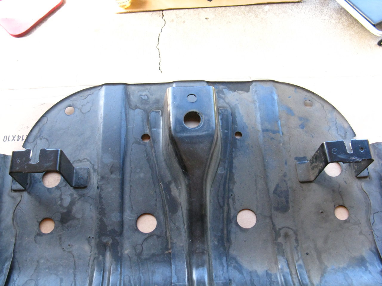

    I modified my skid plate by cutting slots in the two center mounting tabs (see photo). When I remove it, I only loosen those two bolts, removing the other three. Slide forward a bit and it drops free. When replacing, bring into position, slide forward a bit and then back engaging the slots. This will hold it in place to start the other three bolts. It is a little bit of a wrestling match to line it up for re-attaching but once the bolts are in the slots, the rest is easy.

    Sep 7, 2022
    #83013
    841
    That is an awesome idea! Well done!!
  13. Feb 23, 2023 at 5:50 PM
    Bakershack
    May 20, 2020
    #46846
    5,805
    Kelly
    Spanish Fort, AL
    2020 SSM 1794 4x4
    I'm copying that one. Great idea!

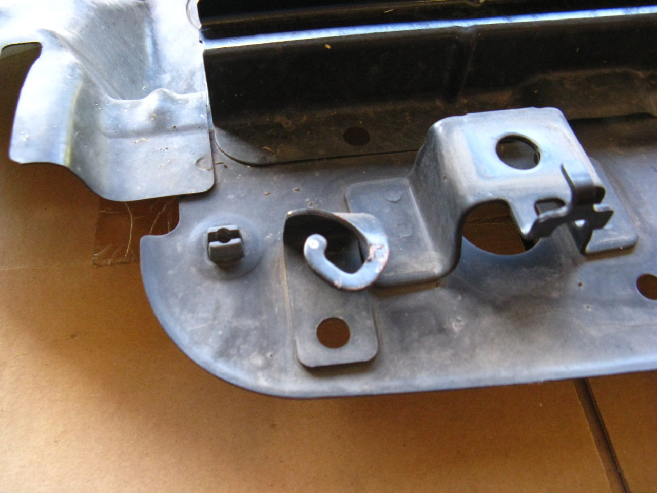

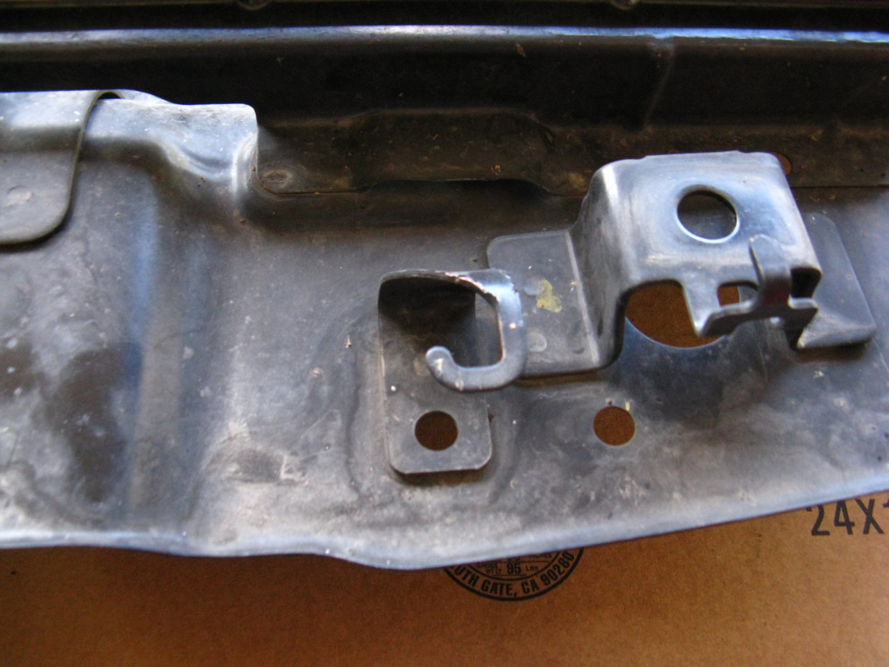

    I forgot to mention (in post #11) that I bent over the front hanger hooks to get them out of the way (they are worthless anyway). This makes it easier to slide the skid plate fore and aft to position for slot engagement.
