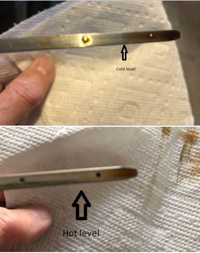

    The oil level drops considerably when the engine is running. Both my bikes have a sight glass, and the oil level drops completely out of sight when they're idling.
    If the oil level is fine with cold oil, it's gonna be fine with hot oil. It may be a bit higher on the stick because of expansion, but if there's enough it it cold, there will still be enough in it hot.
    To gauge oil consumption (the subject of this thread) my main concern is repeatability. I check my vehicles sitting in the same place with cold oil after they've not been run for quite a while and can easily see if the level on the stick drops. I doubt it matters much how it's done, but that's why I wondered if JEHTUNDRA was comparing apples to apples in the opening post.
    Just for fun, (I'm easily amused ;) ) I checked my oil this morning cold. My wife is gone in the truck now, and when she gets back, I'm going to let it sit for 5 minutes and check it again. It'll be interesting to see how much it changes.

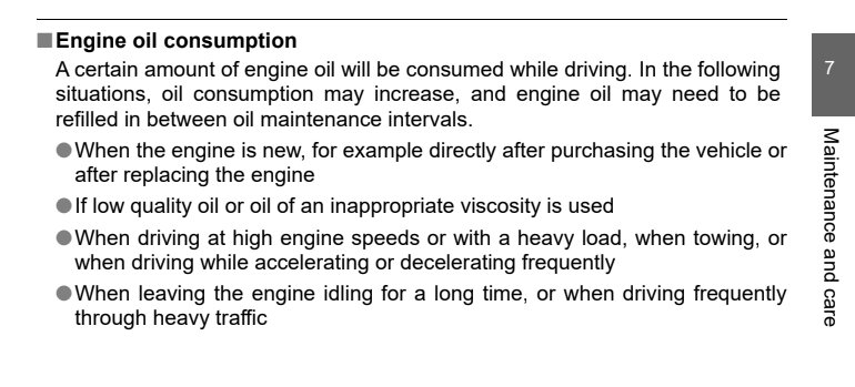

    Tundra Manual:
    Doesn't state specifics, but says oil consumption is normal.

    OK. After my wife returned, I let the truck sit for 5 minutes or so and checked it. It was actually lower on the dipstick than it was when cold and sitting overnight -- not a lot, but some. That actually surprised me a little; I thought it'd drain back faster than that. The level is really hard to see in the photos, but I didn't doctor them any. The arrows point to the true level after pulling, wiping, then checking.
    At any rate, I think we're all overthinking it. :)

    MadMaxCanon
    MadMaxCanon New Member
    May 27, 2021
    #63566
    4,526
    SoCal
    '21 CM SR5 4x4 6 seater
    Too many, but not enough....
    This makes sense, when the oil is hot, it means the engine was running recently, thus, the oil from all the nooks of the engine havent fully drained down yet. I would think cold would be the best indicator of true oil level.
