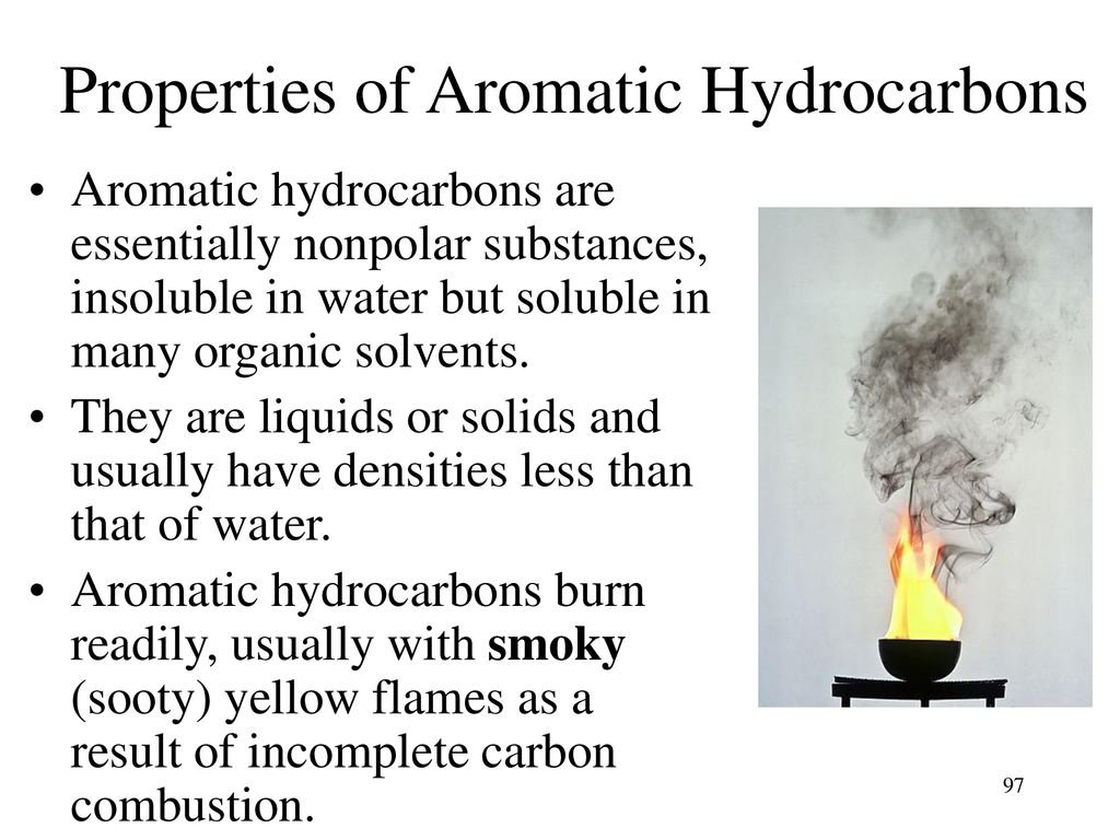

    I think he meant that changing your oil more frequently will do more for eliminating engine wear than using an expensive oil.
    Q: Why does one change oil anyway?
    A: Modern day gasoline is a product of deep crude oil treatment and contains a significant amount of aromatic compounds (including BTEX) that produce large quantities of black soot when burning. That soot with blow-by gases contaminates oil regardless of what brand of oil you use.

    Oil has soot holding capabilities, which is 'one' of the reasons why it turns black. And it's almost a non issue in gas engines (except DI engines). Diesel is another story, they're high compression and much more prone to blow by . The detergent/dispersant packs clean and suspend insolubles so they don't settle on engine surfaces and they're able to be removed when draining oil.
    10k mile oil from my tundra is brownish (but getting better every oil change as the oil cleans)
    10k mile oil from my 7.3 is black.
