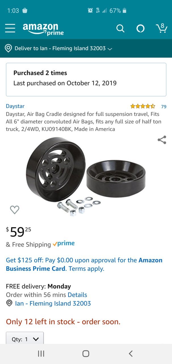

    Pair it with dystar cradles.

    You don't want to utilize these are bump stops. You will blow them out eventually. The cradles help with offroad use as it will not limit your suspension travel to the extension of the bag

    Firestone air bags 5psi minimum will serve as bump stops. When used with dystar cradles it will prevent the air bag from getting damage during full articulation.
    Air lift have an internal jounce/bump stop, but I did not like the ride. Both on 0 psi or even 5psi. It felt that I am riding on bump stops.
