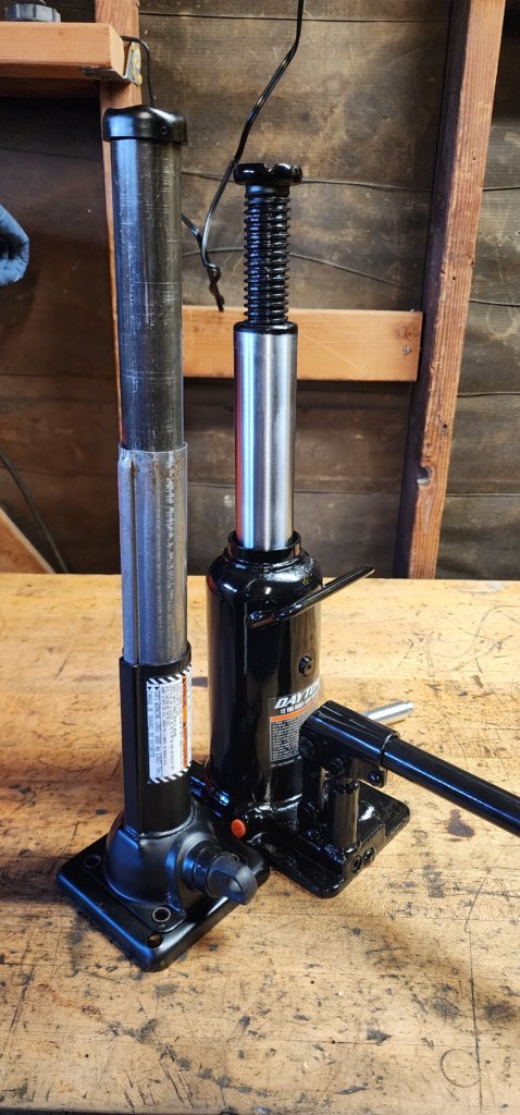

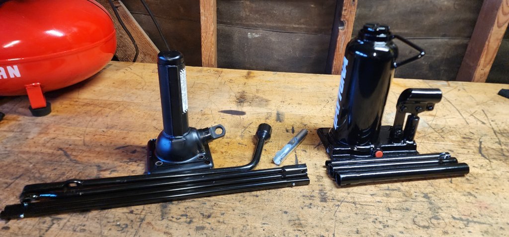

    I recently swapped out my stock jack for a Daytona from Harbor Freight. I was surprised to see the stock jack extended to the max. I actually took a side by side comparison of stock and what I got...
    And love that it fits perfectly in my ESP bin. I keep a couple wood boards tucked away where the stock jack used to sit.
