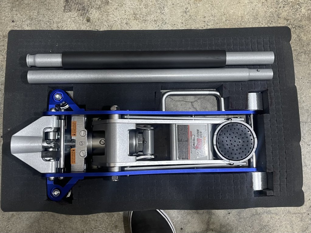

  15. Dec 23, 2024 at 5:00 PM
    FirstGenVol
    Dec 13, 2018
    #22934
    14,151
    East TN
    2002 AC TRD 4x4 V8

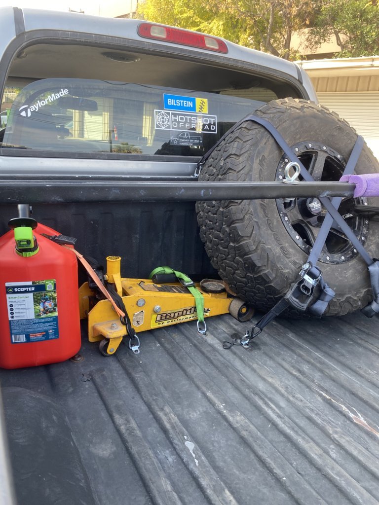

  19. Dec 23, 2024 at 5:40 PM
    shifty`
    shifty` Just like witches at black masses
    Jun 20, 2020
    #48239
    28,375
    ATL
    '06 AC Limited V8/4WD
    ProfJ[OP], Tundra family and PNW15 like this.

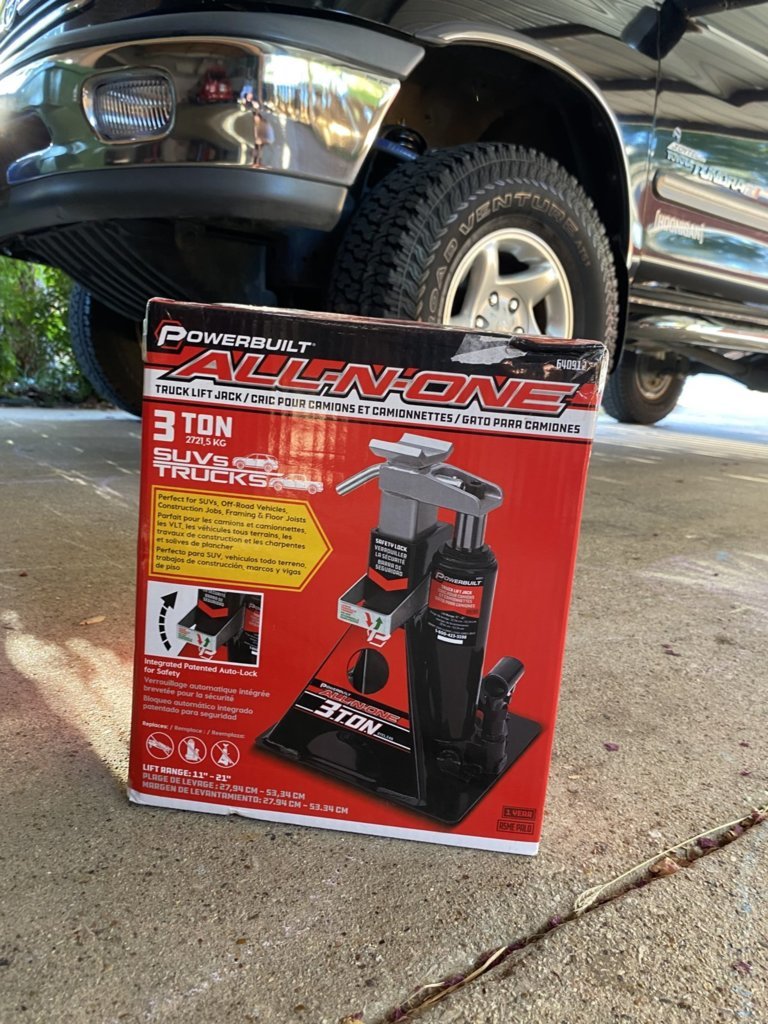

  27. Dec 24, 2024 at 12:37 PM
    #27
    Cthulhu
    Cthulhu The White and Black Goat of the Woods
    Jul 21, 2018
    #17251
    1,380
    John
    2018 Tundra Limited CM Premium Package
    Yep…
    Mater, RobertD, Nicklovin and 2 others like this.
