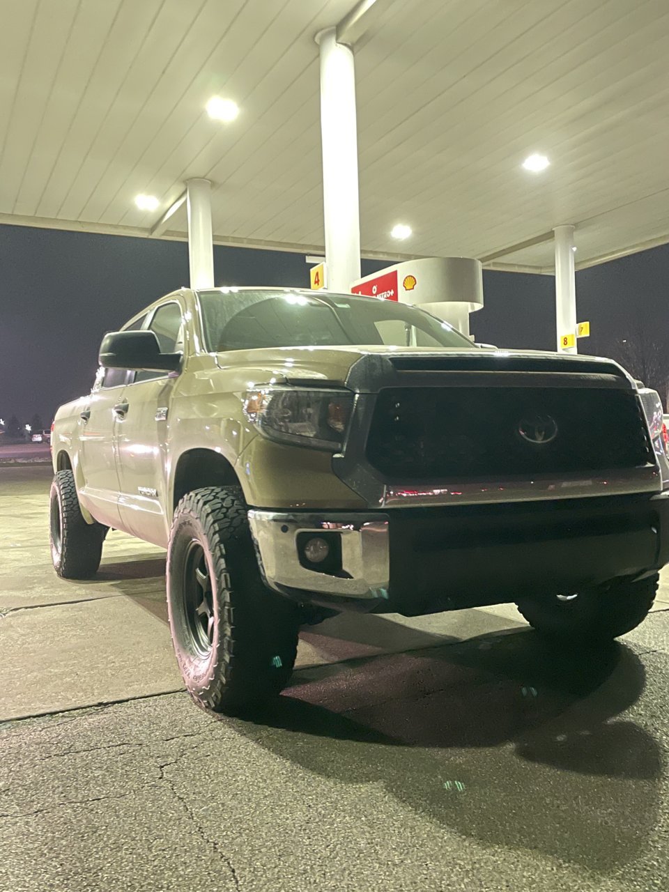

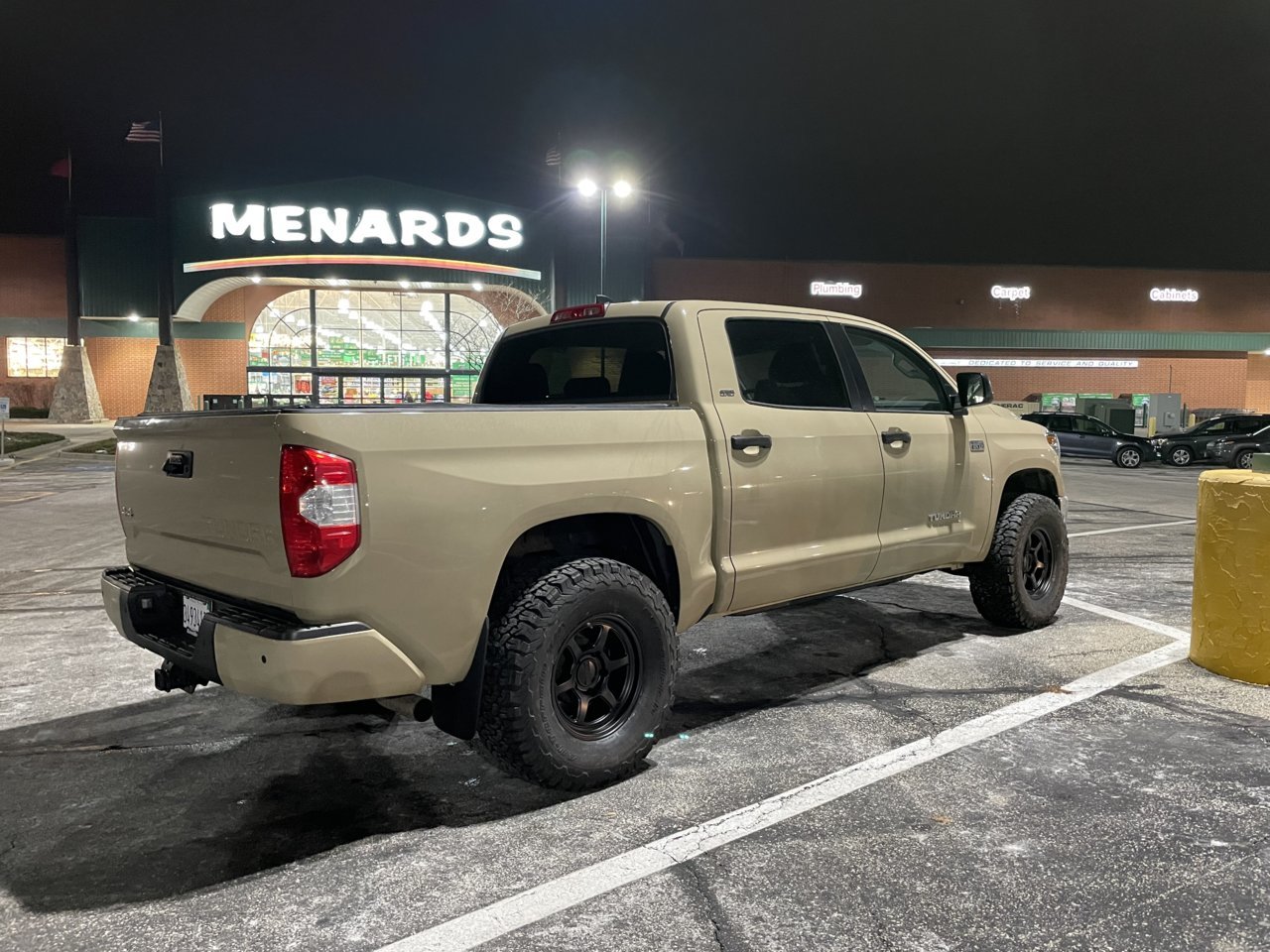

    Bilstein 5100, 35’s on 17” wheels
    New Here. Here’s my set up I just had installed the other day. 17x8.5 +0 Kansei Roku wheels with 315/70r17 BFG KO2’s. Bilstein 5100 set at the middle setting, rear is stock height. Minor body mount chop and front bumper shims for clearance63773474-F19A-4FF9-91E1-A0C35BF305D5.jpg 7D5A1D17-0B17-479F-82AD-C1379B7157B2.jpg

    Ghostface New Member
    Jan 10, 2021
    #57398
    34
    Awesome setup!! Do you have anymore pictures? Would love to see more to get a better idea of this setup.
