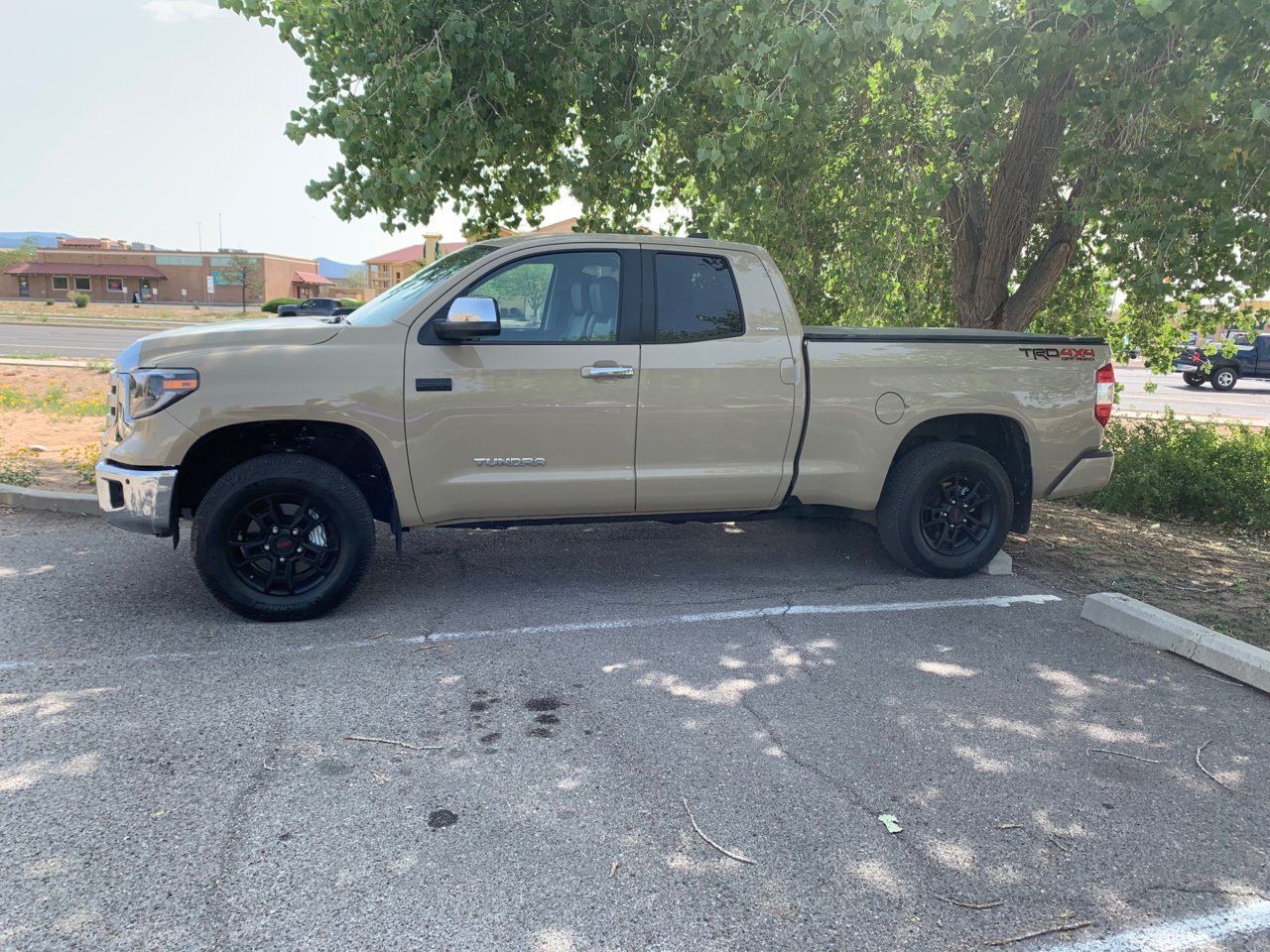

  6. Sep 16, 2020 at 6:32 PM
    #2136
    aark12
    aark12 AARK12 - Hello All
    Aug 27, 2020
    #51417
    58
    New Mexico
    2020 Tundra Limited TRD
    Bilstein 6112, Pedal Commander, TRD Pro BBS Wheels, Gator Tonneau Cover, Bed Step, TRD Pro Grill, Mirror Caps, Grab Handle, Dirty Deeds 10in System, rear bumper step, dash cam
    Installed TRD Pro BBS wheels. Will be replacing the tires with 275/70/18 eventually.
