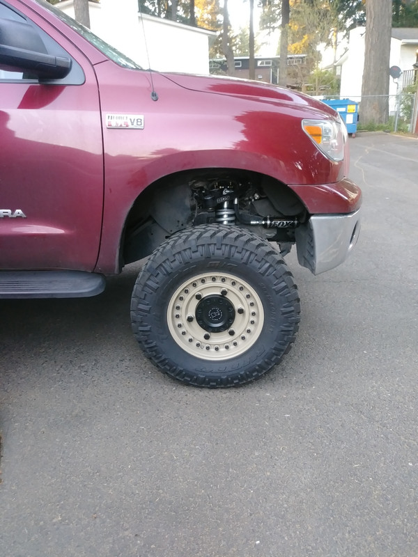

    Salsa Red 2007 Tundra DC @91k.
    7" BDS Coilover Suspension Lift/BDS UCAs/XB LED Headlights/Nitto trail Grappler tires on Black Rhyno Armory wheels
    35 x 12.5 x 18 Nitto Trail Grapplers tires on 18 x 9.5
    Black Rhino Armory Desert Sand wheels, offset +6, backspacing 5.5, center bore 110.1
    7" BDS Fox coil-over suspension lift & uca s.
    The only modification done with this setup was to remove the stock front mud flaps, and install bump stops.
