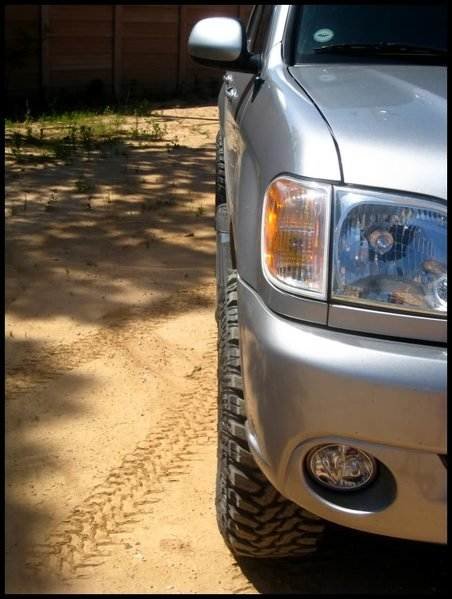

    rvanwert, my bad. Somehow I missed the part that your truck is 2003. 1st gen Tundra wheels have relatively low offset, so in order to achieve the look you want, you might have to go with a negative offset. 2nd gen comes with 60 mm offset wheels, so at 12 mm offset, the wheels are pushed out about 2 inches from the factory setting. From what I could find out, 285/70/17 is pretty wide tire for the 1st gen.
    But it seems you don't have to change the offset very much to achieve the look you want. Here is a picture of 2006 (I think) with 285/70/17 Cooper stt on oem bbs-rd wheels. I am not sure what rubbing issues are involved. I am not very knowledgeable when it comes to 1st gen. My 2010 Tundra was the first truck I've ever owned. So I am still learning.

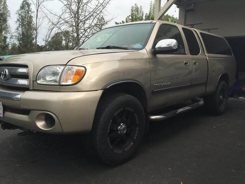

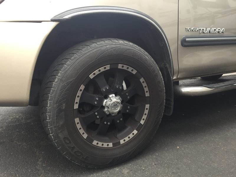

    Hello All,
    Just signed up and appreciate all the time and effort people have put in to their posts. Supper helpful. Thanks!!!
    I haven't had a chance to read much and ...
    I got a lot from the first few posts I read.
    I needed some info on stock wheel and tire sizes for my 2003 Tundra SR5 (Xtra Cab?) 4 x4 with a manual trans and the V6 with added TRD Supercharger and an URD 7th injector kit and Firestone Air Springs. ( I had to modify the air spring mounting brackets quite a bit to be able to have the air bags clear the tires).
    When I bought the truck it came with Goliath Matte Black with Diamond Cut Accents 18” x 9” 6 lug and Toyo Proxes P285/60R18 Tires.
    At first I didn't really like the wheels much and they have really grown on me and the tires are excellent.
    I was looking up original tire and wheel sizes because I was thinking of buying some stock wheels to put some more off road tires on. The Toyo's are great and I love the way they handle. Most of the driving I do is on the highway and I also like the quiet. I used to have a Ford Explorer with pretty off road tires and really got tired of the road noise on the highway and loved how they preformed when off roading. I also have become really fond of my Toyo's but they are pretty useless for off roading.... at least in my opinion for whatever that is worth.
    My money situation has taken a temporary ugly turn which may last for awhile and in the big picture trying to get what I want and not spending a ton of money has brought up the thought of buying a used stock set of wheels with very off road tires for my trips to the mountains and to the snow. Hence the looking up the stock wheels and tire sizes. I can still buy my tires at pretty good deals from my ex tire supplier and stock size off road tires are lots cheaper and do a pretty good job off road or at least they did with my Explorer.
    I was in the auto repair business for a long time but didn't do a lot of tires and wheels and every 4 x4 I drove with pretty aggresive off road tires where always noisy on the freeway. I had some Goodyear Wranglers on my Explorer that were a pretty good compromise and now am kinda of spoiled with my wheel and tire set up and really don't want to compromise my tires and wheels for off road and snow use.
    I am always open to learning new things and anyone's suggestions.

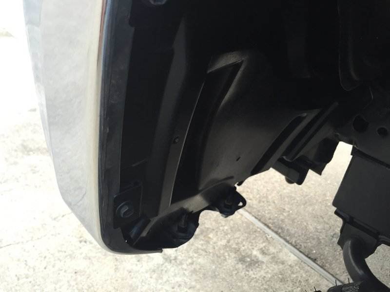

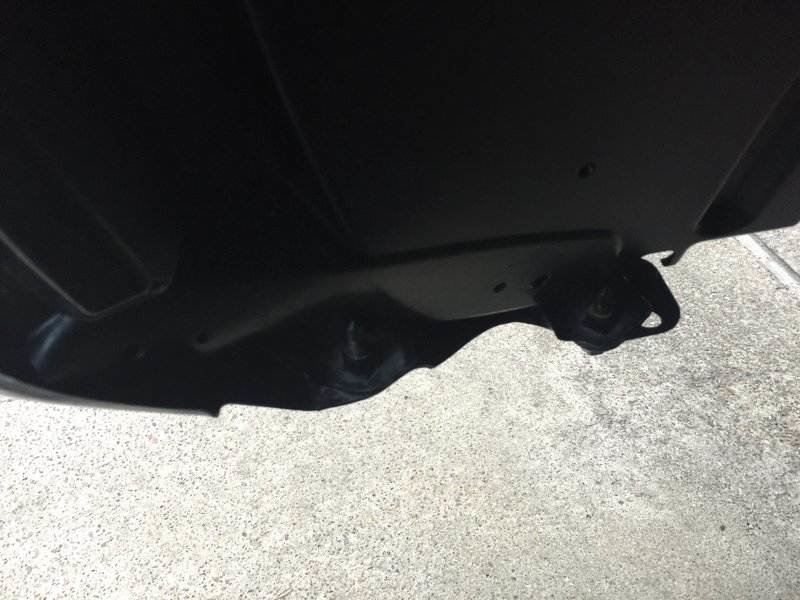

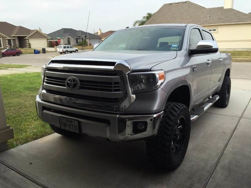

    My plastic modification with out removal. Just a trim and it still fits perfect. No rubbing what so ever anymore on 305/55r20 +1 offset
