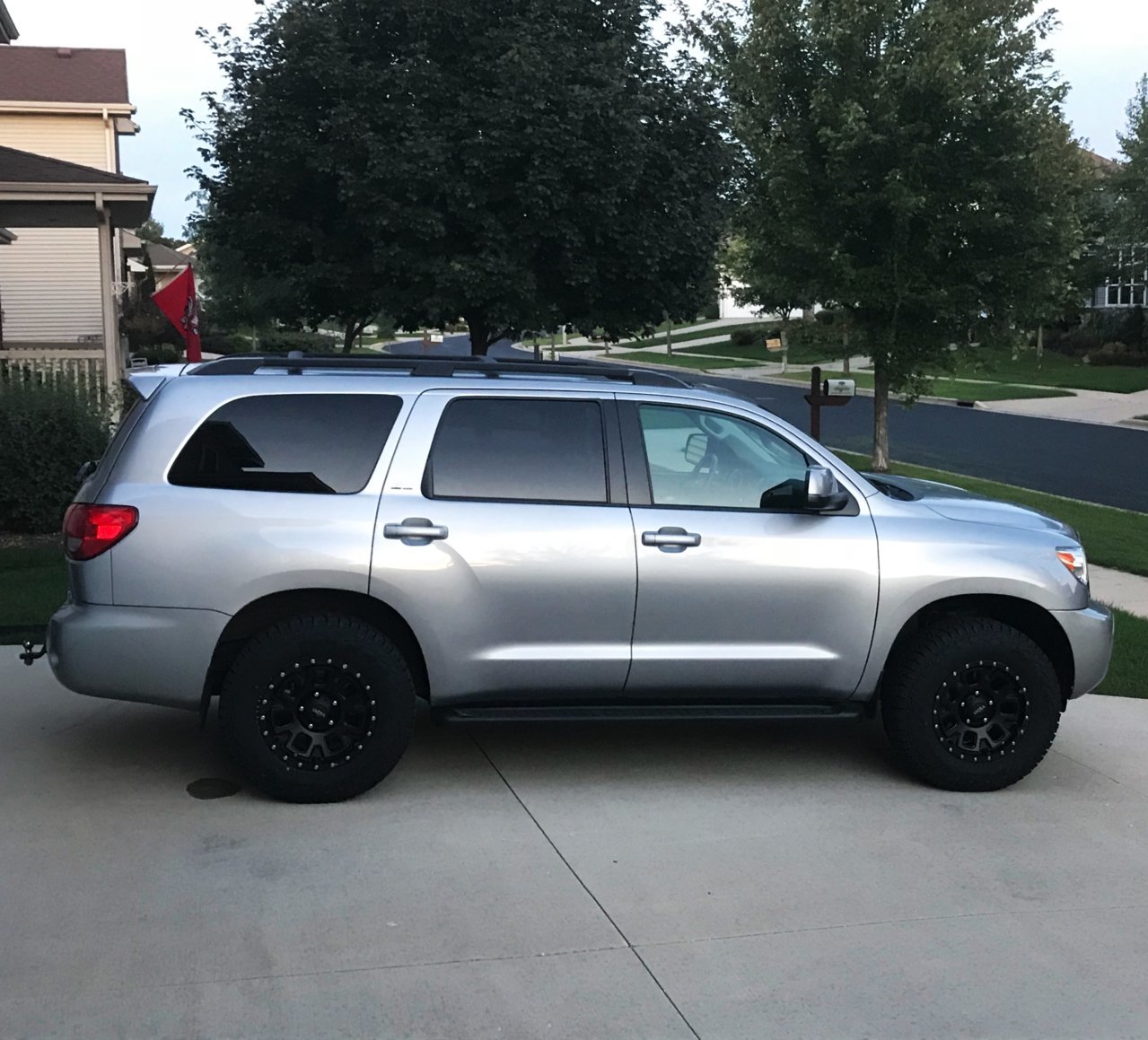

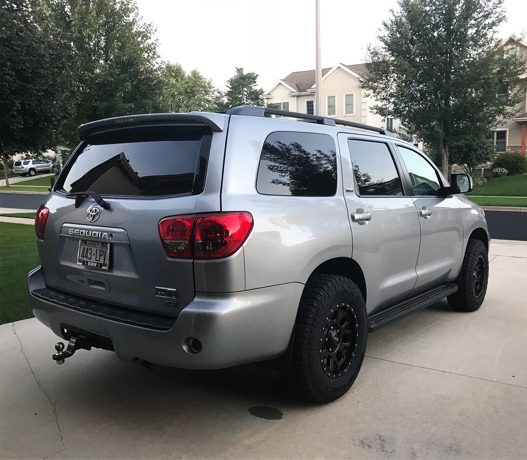

    Bilstein 5100 shocks, Ultra 109SB wheels and 33” Falken Wildpeak A/T3W tires.
    Bilstein 5100 shocks front and rear, 18X9 Ultra 109SB +18 offset wheels and 33” Falken WildPeak A/T3W tires.

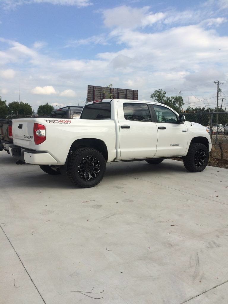

    Fuel assault 20x9 +20 on 35x12.50
    Edit: 3” toytec eibach kit with shackles set to 1.5” in the rear.

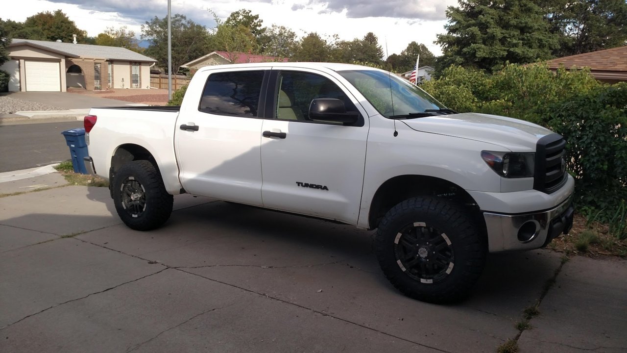

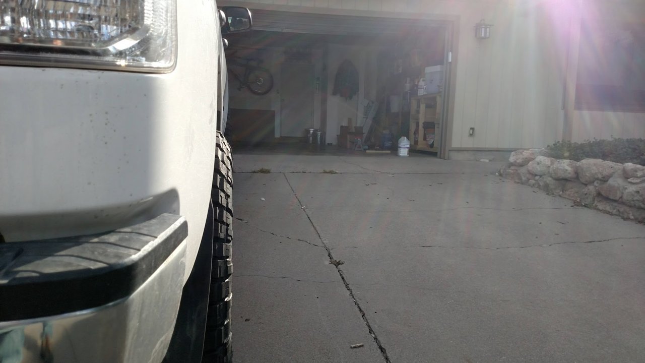

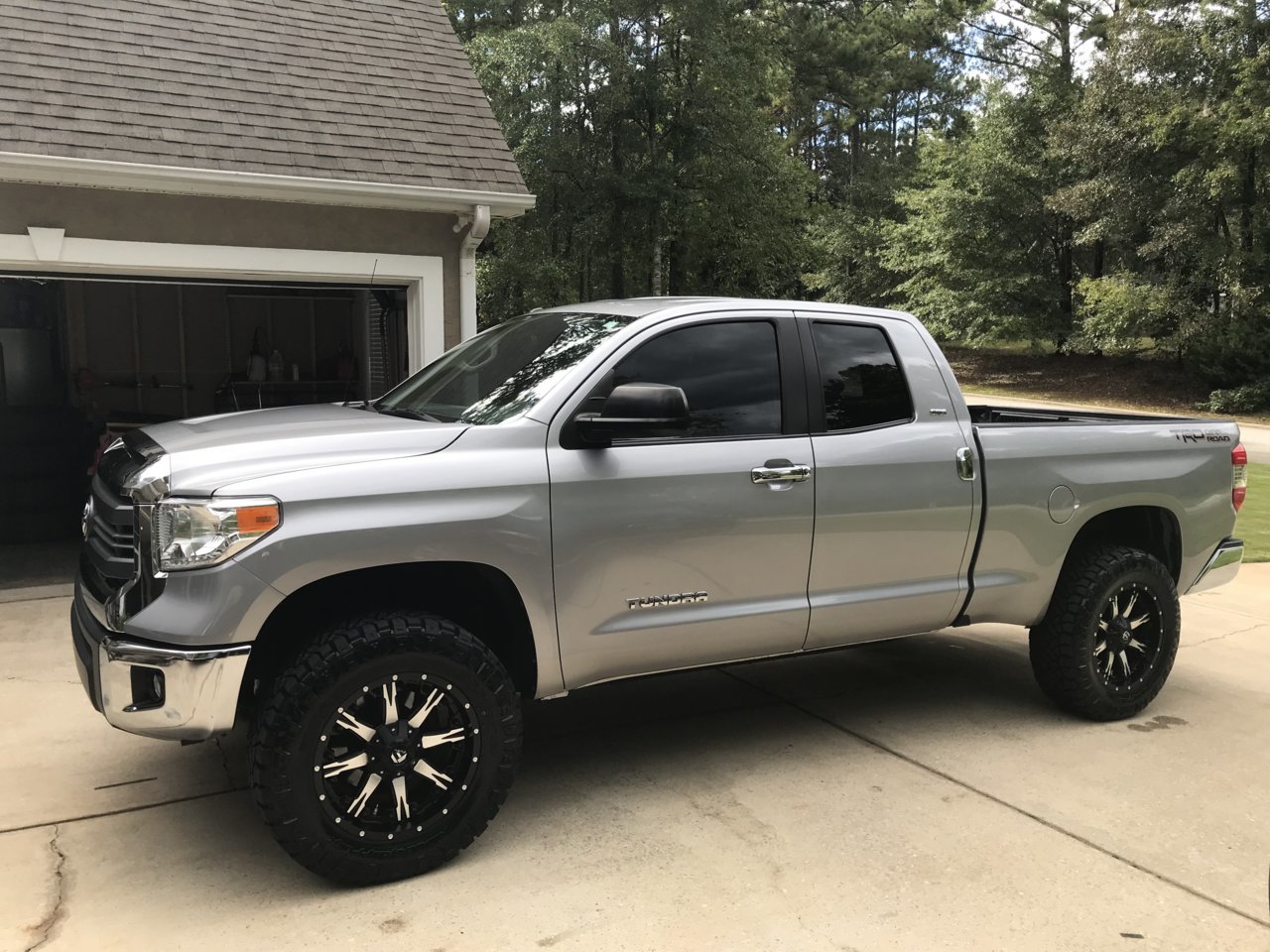

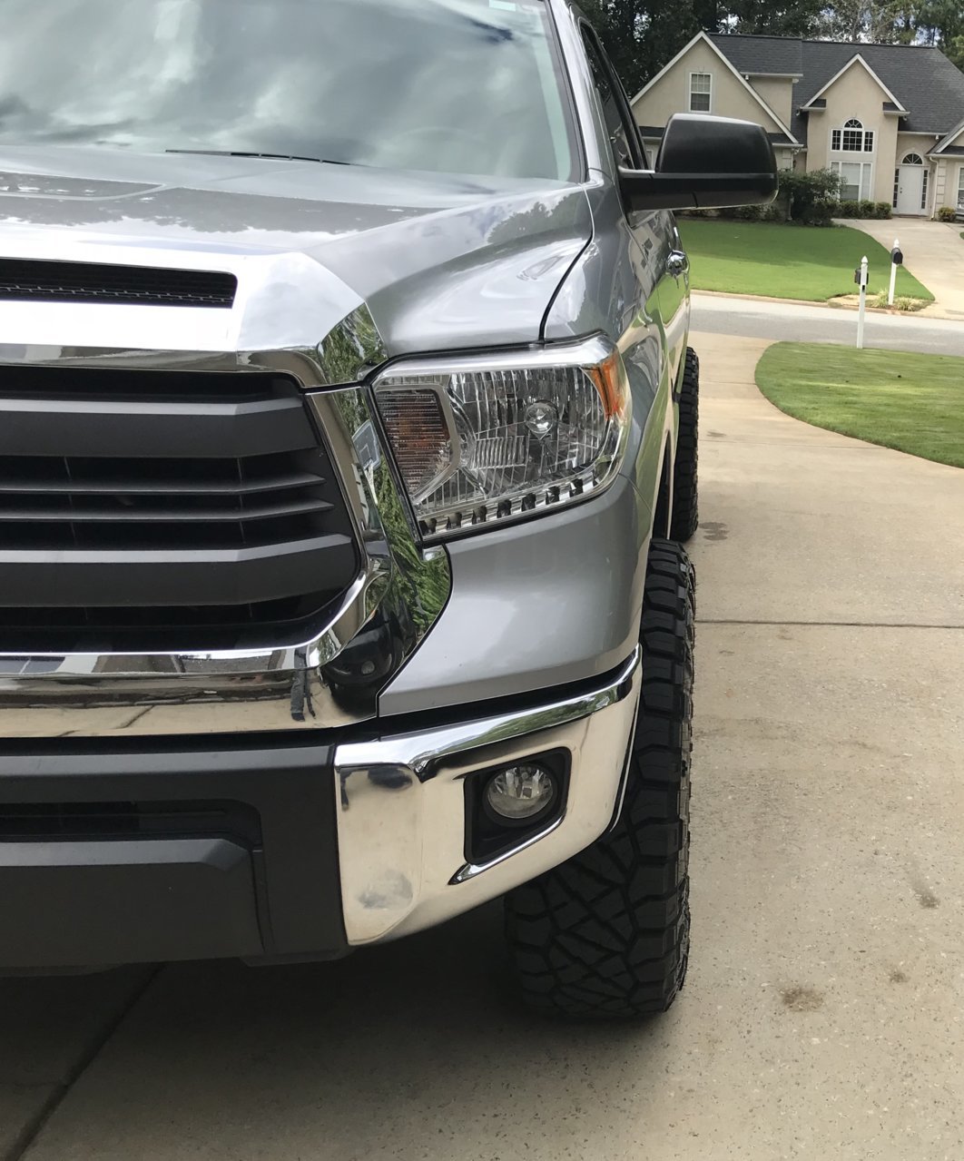

    Finally got my Nittos on today. Had the lift on for quite a while now with my old 275/70r18 KO2's and they finally wore down enough for me to justify getting new ones.
    Went for the 295/70r18s. Considered the 35X12.50s, but every pic I saw with those and my lift seemed to look a little too "stuffed" in the wheel well for my liking. The best thing about the new tires? My rig is quiet again. As I have mentioned in other posts, if those KO2s start wearing unevenly, they are loud as hell. It is nice to not have that noise now - I can just focus on the sweet tone of the exhaust. :headbang:
    Anyway, a couple of pics. My wheels are Moto Metal 951s with +30 offset. Lift is about 3.25/1.

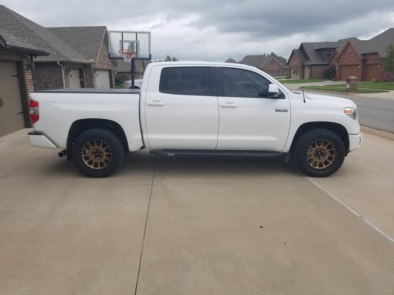

    20x9 +25 Method
    275/60/20 Falken Wildpeak A/T3W
    Stock suspension
    I had to remove the small mud? flap in front of the tires due to rubbing. Other than that they fit great. Due to the new offset, the tires are ~1in outside the fender. I would have liked 295s but wheels, 2x $$ tires, lift, fender flares were more than I wanted to spend all at once. And, I knew the 275/60/55s would fit with little to no issues. Down the road, I'll pick up a toytec lift. Overall I'm very happy. The guy at the tire shop gave me two big thumbs up. He loved the bronze/white, but he probably says that to all the girls. :)

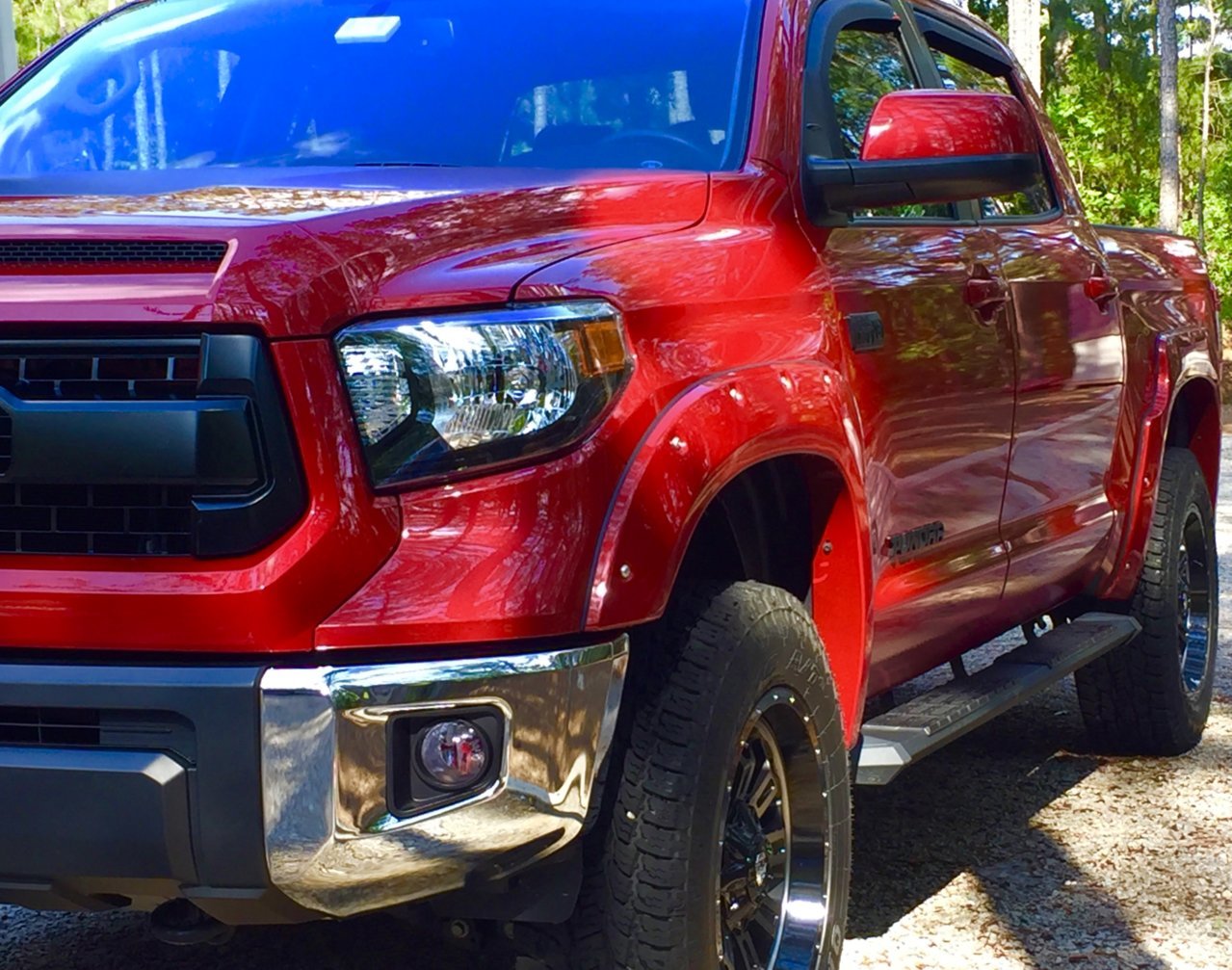

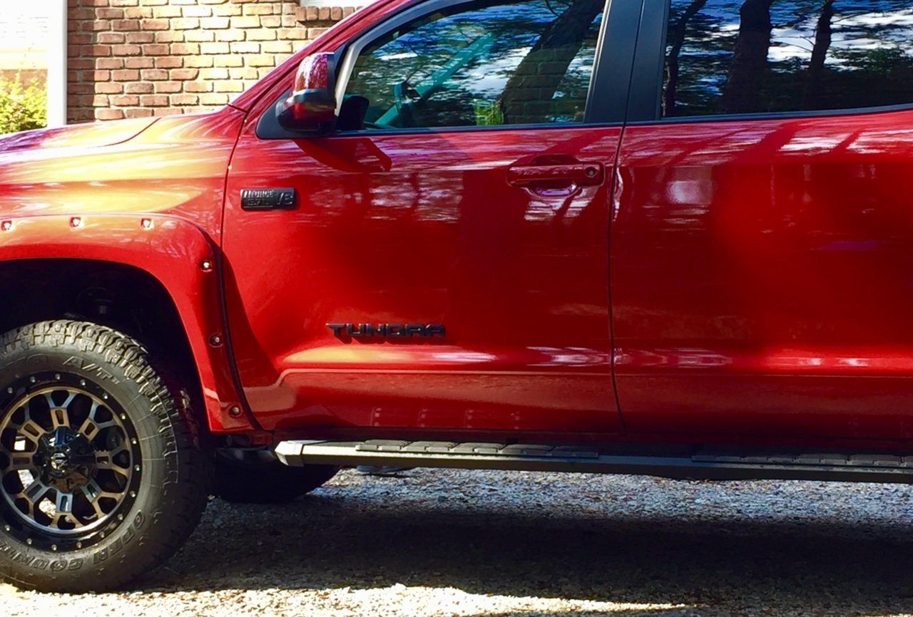

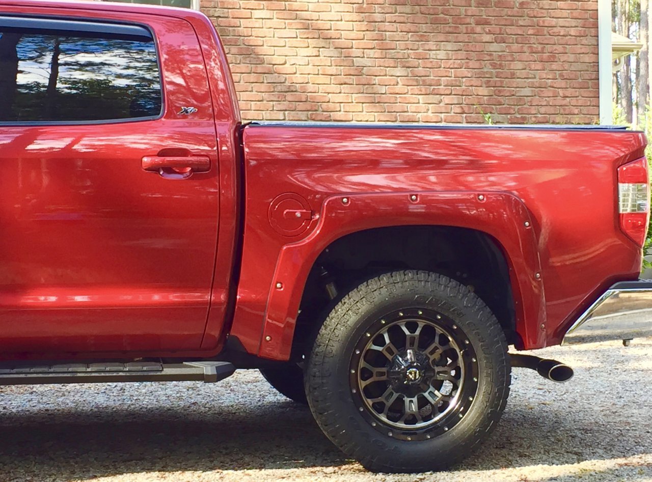

    I have Fuel wheels at +1 offset 5 mm backspacing 20x9, 3/1 suspension lift and +3 CB shackles. Tires are 275/65/R20 toyo at's which required BMC along with front bumper CoachBuilder spacers and front mudflap takeoffs for front clearance. Hope this helps anyone looking to mod their look. fullsizeoutput_1d75.jpg fullsizeoutput_1d76.jpg fullsizeoutput_1d78.jpg

    Toytec eibach kit with shackles at 1.5”.
