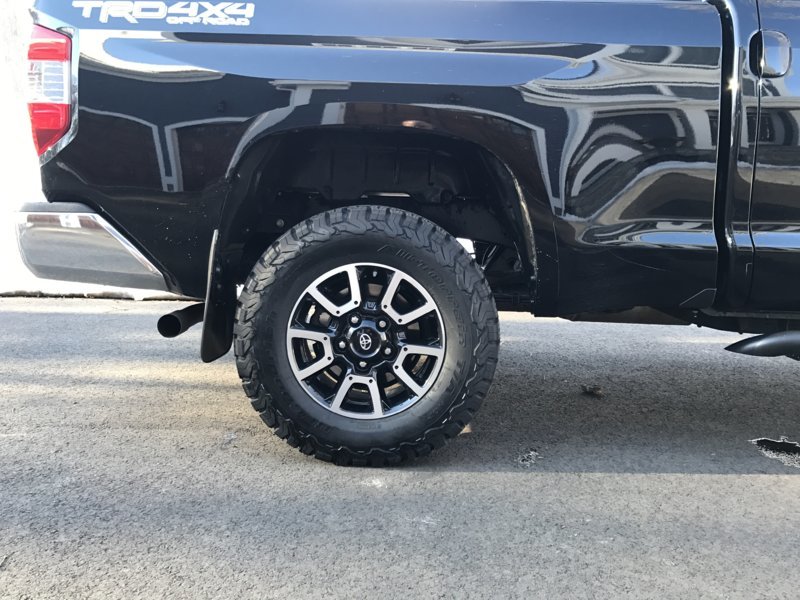

    I just did a 3/1.5" leveling lift and put a set of 305/65/R18 BFG AT KO2's on the stock rims. I understand the math behind offset but I also am looking for some feedback from people who have experience playing around with this stuff.
    With my Jeep I used 1.25" Spidertrax spacers with the stock rims but no matter what I was still riding on stock looking rims. I don't want to do the same for too long with my Tundra.
    Questions:
    When shopping for 18" wheels, how much of an offset would I need to put the tires out 1.5" or so. I don't want them sticking too far out which in my opinion messes up handling and sandblasts the side of your truck... I just want some depth to the wheel...

    I say anywhere from +12 to +18 should put you in the area. I'm running +12. CCheck out my build thread if you want to see some pics.
