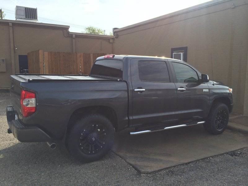

    Added 295/60R20 and plan to install a 2.4" leveling kit on front.
    Thanks for your comments. I ended up trying several different things but finally settled on new wheels and tires and a 2.5 inch leveling kit. We installed Matte Black XD 20" Monster Wheels with a +35 offset and 285/65/20 BFG All-Terrains. I am trying to decide if I should remove the XD caps, but when I take the back ones off, it is all rusty looking in there. Any input would be appreciated. Check out the pics below...
