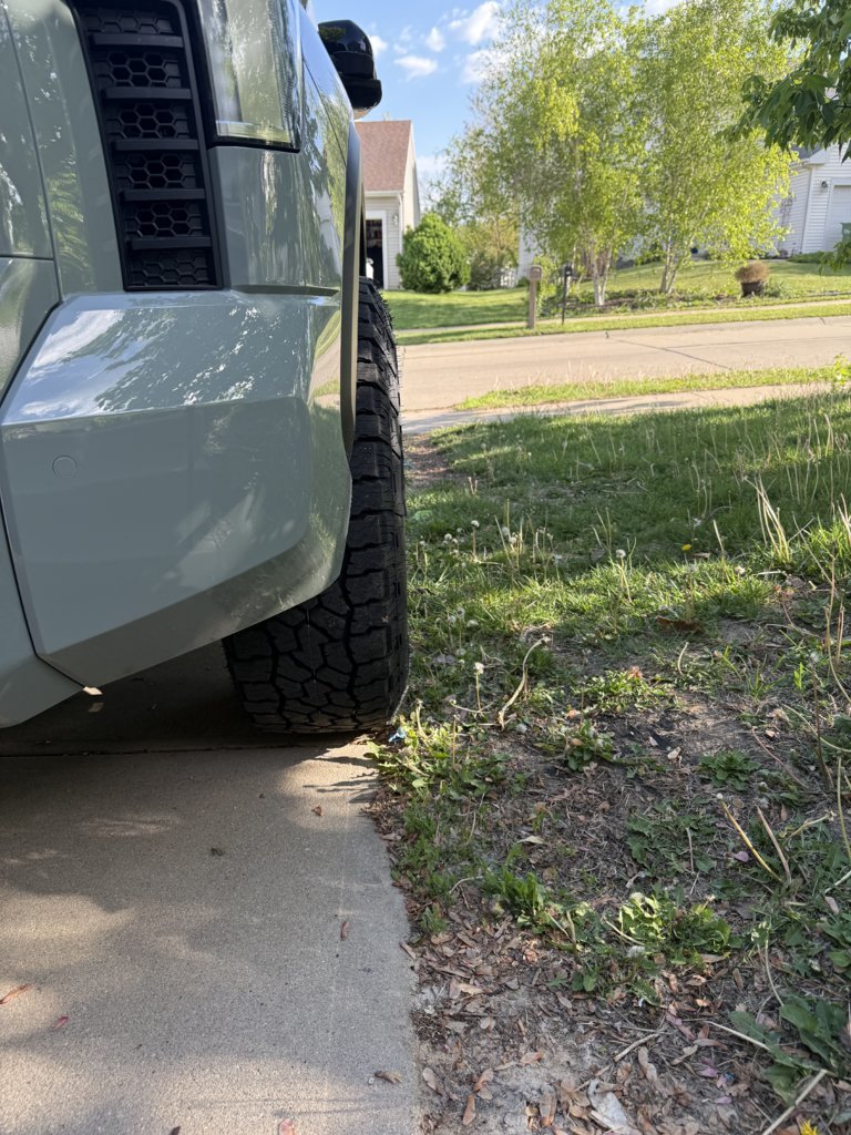

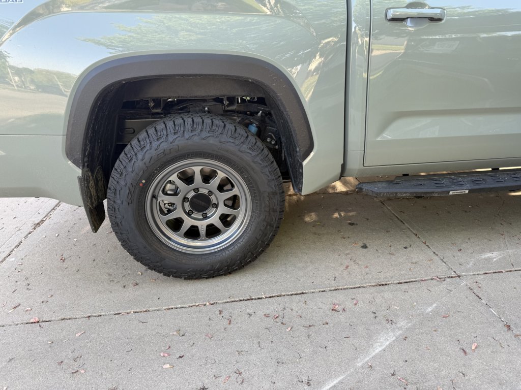

    Method 316 Gloss Titanium 18x9 +18 offset
    Wildpeak AT4W 275/70r18
    OEM TRD Off-Road Bilsteins

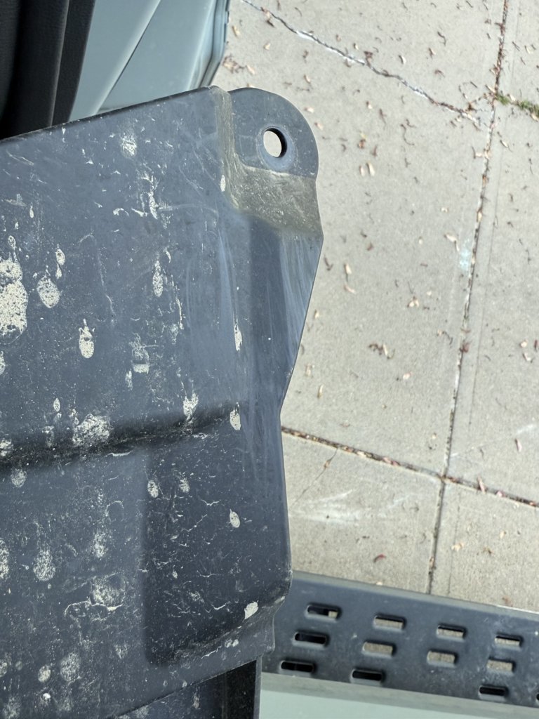

    Slight rub at full lock with OEM mudflaps. Seemed to be when turning on sloped surfaces.
    You can see how slight the rub was. Took off the OEM Mudflaps and putting on RokBlokz this weekend

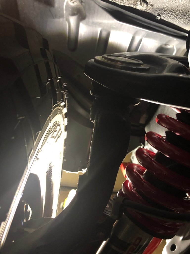

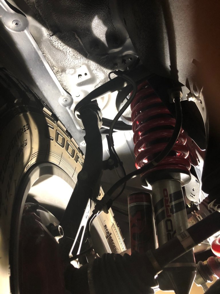

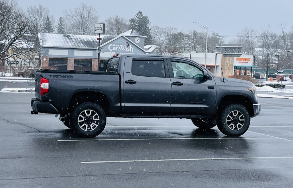

    Currently running 6112/5160. 3rd setting with two driver shims, one passenger. +3 CB shackles and 1”block. Have bora 1.25”. Stock TRD 18 OR rims. CB bumper shims. 285/70 18 Toyo AT III. No rubbing. Plan to jump to 295 soon.

    Thanks. Post up pics when you got it all done! I could have probably used only one of the shims. Maybe even forgone all together. Also have JBA UCA’s.
