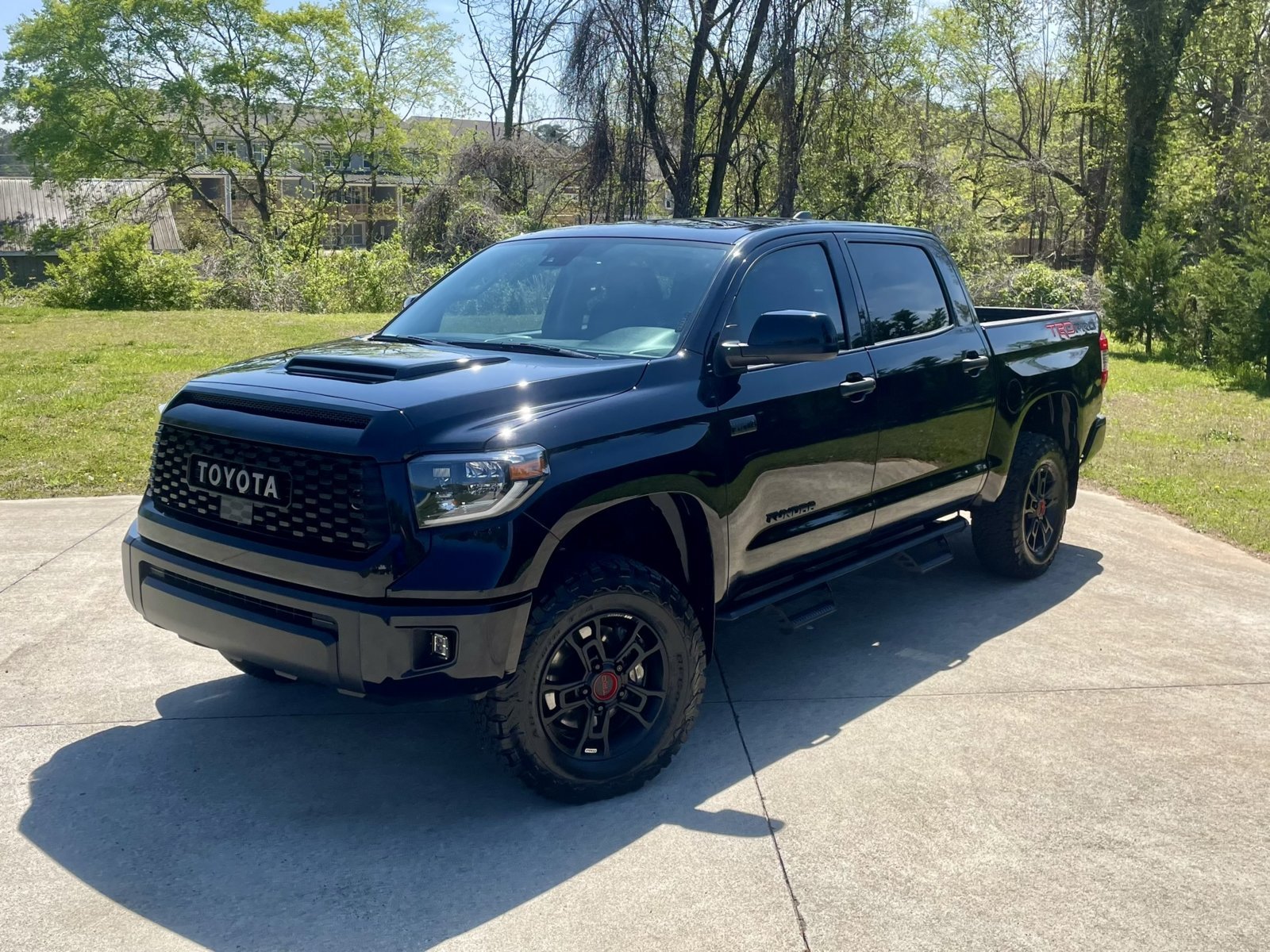

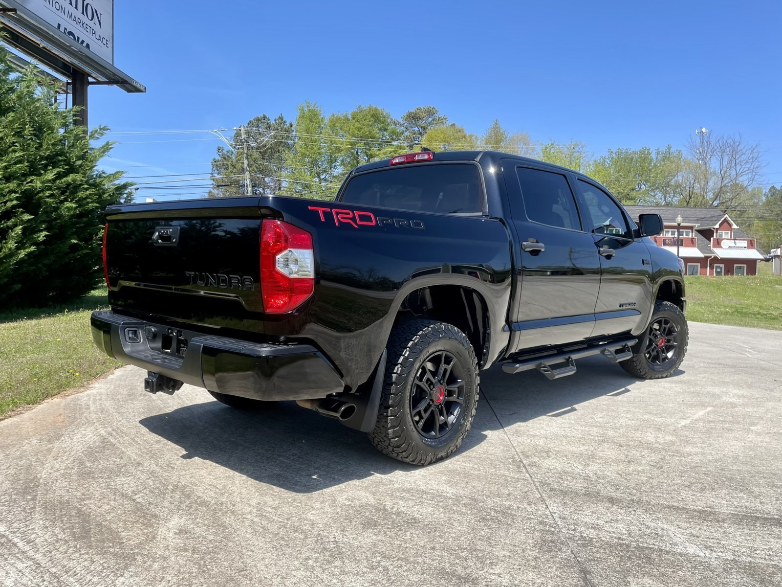

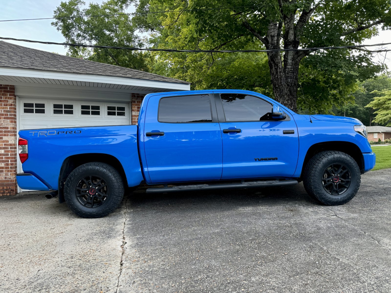

    Just popped this in the "what'd you do to your 2.5-gen today" thread, figure I'll add it here as well.
    Just got some 295/70R18 Toyo Open Country AT3s, truck is stock regarding suspension/wheels. I took the front air dams and all 4 mudflaps off. No rub in city/highway driving but I'm sure I will need to make some adjustments once I can get it off road and stuff the tires into the wheel wells a bit more.

    love that color. Looks great!

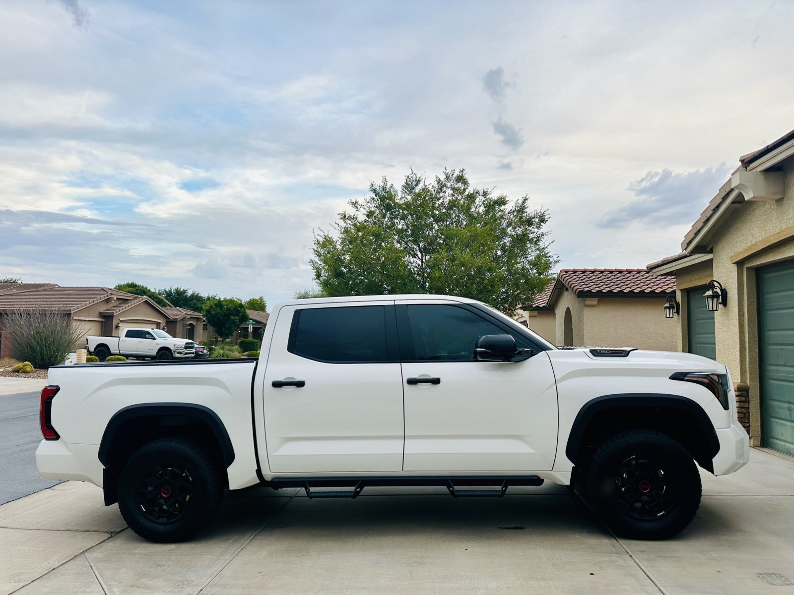

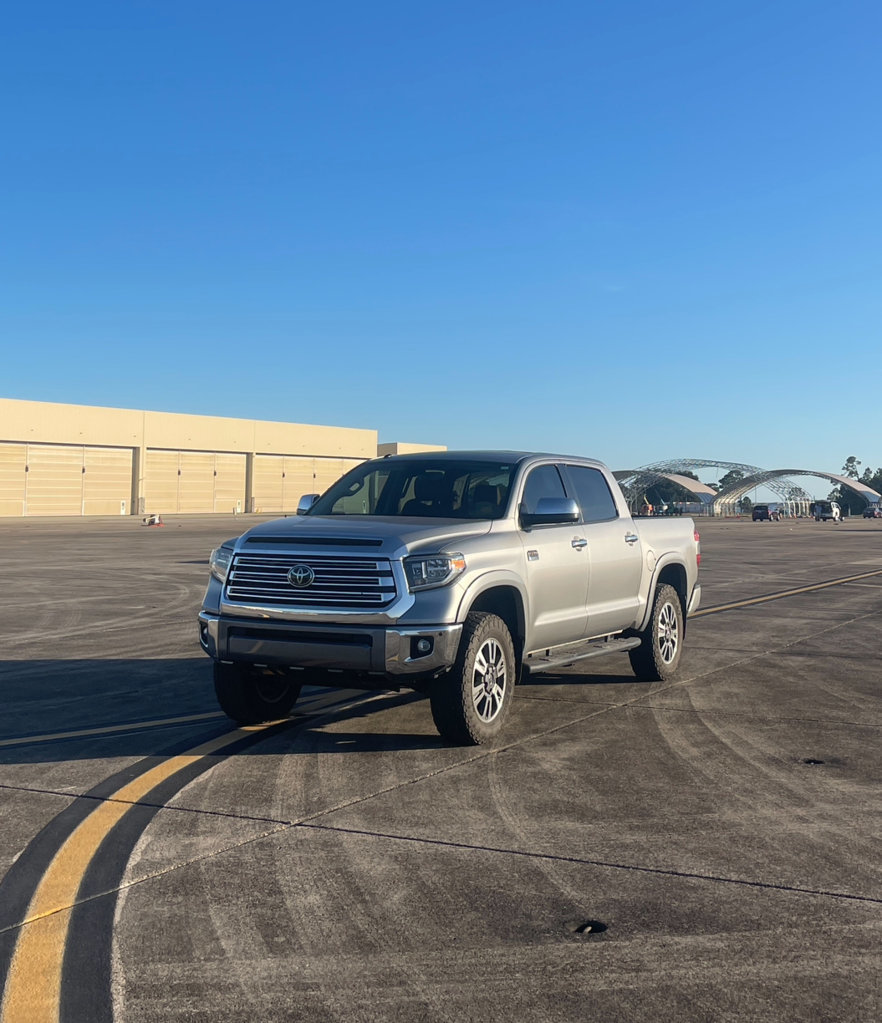

    My Review/Lift/Wheel/Tire Spec input for your 2024 Tundra TRD PRO
    I’ve been researching them for months! Definitely on my bucket list for sure. Despite the price point. This thing is pure gold so far!
    I had considered the 2024 Tundra Platinum TRD Off Road I Force Max or Gas instead, but I’m very happy I went this route, despite my budget concerns. The additional features for me have been well worth it this far not to mention the additional rarity factor for each years production at less than 2000 units nationwide. I also like that these are American made/built right here in the heart of Texas.
    I highly recommend it after trying out my 2019 Manual Tacoma TRD Sport Premium/Limited, 2021 GMC 3.0 1500 Diesel, GMC 2500 AT4 6.6L Duramax Diesel, 2018 F-150 LariatEcoboost, & now 2024 Tundra TRD Pro V6 Twin Turbo I Force Max Hybrid rocking 437HP 580TQ stock.
    I’m averaging about 14 to 15 MPG so far all the way around with both city and Hwy commutes to Phoenix from QC with nearly 450 miles to the tank prior to full break in.
    This is by far my favorite so far. It’s an absolute tank, but it’s smooth as butter, the ride quality is superb, and the performance so far with a smooth break in only 300 miles in has insanely smooth power.
    I haven’t opened it up of course, but I can tell it’s all there. I was comparing several trucks and didn’t want a diesel because I didn’t want to deal with DEF fluid and having to consider tuning/DEF delete options. I also didn’t find any savings with a diesel as far as MPG goes.
    Performance wise, this has just as much go as any truck if owned other than the taco of course and then some. I highly recommend it so far. I’ll be happy to share more insights with further break ins.
    I had concerns about reliability on the 2022 & 2023 model transmission/engine issue replacements, but have spoken to several dealers before purchasing as well as reputable Wescott designs locally and they assured me out of the 100k recalls they have yet to see one issue after lifting/modding literally hundreds of them both locally and nationally.
    I’m praying for the best and have ensured warranties are in place for any one offs I may run into. Due to the chip shortage I am pending my second key in a couple of months, but other than that this thing is fully loaded with every option I can imagine and is a work horse as well if I want it to be.
    My goal was 91 octane which 87 can be leveraged and tow capability at nearly 12k lbs with a near 2k payload with every bell and whistle I can hope for. So far she’s delivered on all accounts.
    This will hopefully be a long term overland build my family and I can enjoy and make memories with for years to come!
    Of course I recommend anyone live with in their means and I’m preaching to the choir because this is a stretch to say the least, but for me it truly feels premium on all accounts in comparison to anything I’ve personally tried so far.
    YOLO enjoy each moment time is short! Blessings!

    Have you got a picture straight down the side? Curious to see how the tires are to flush with fender clearance

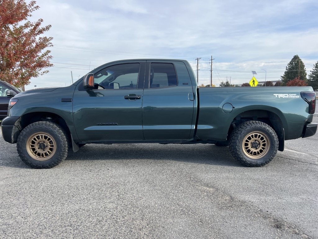

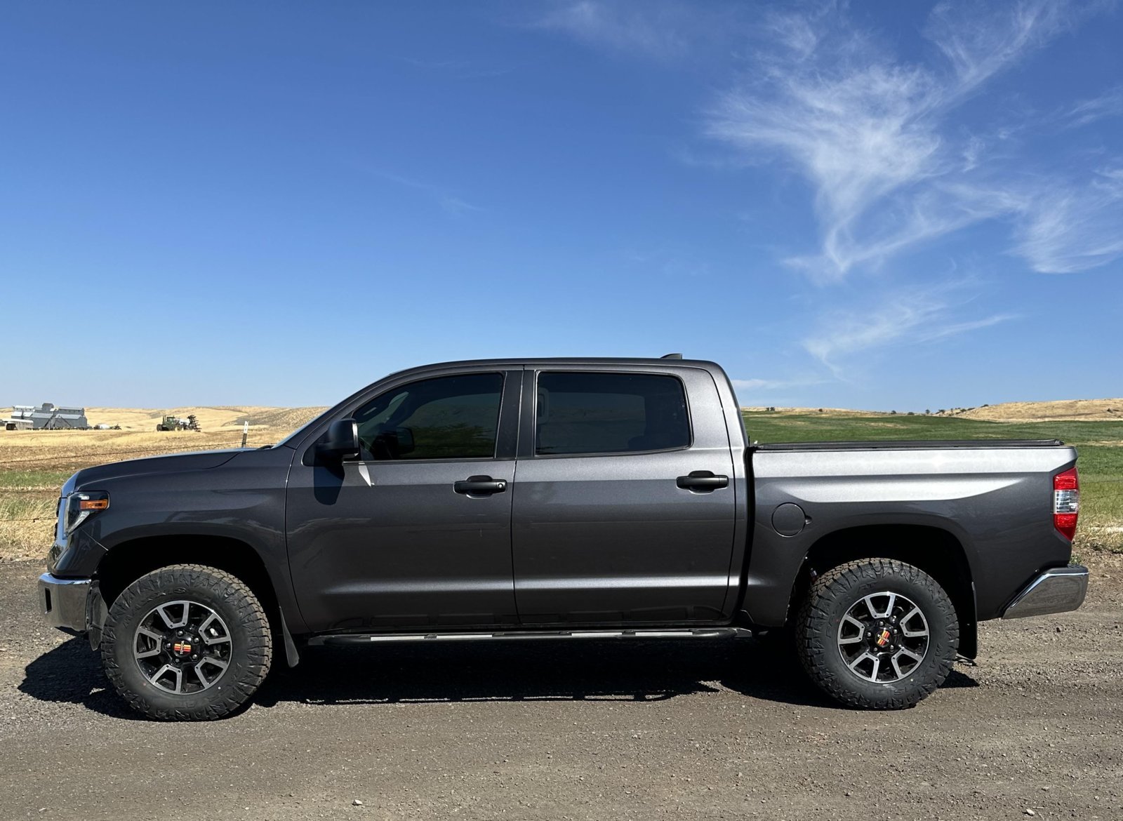

    275/70R18 Maxxis Razr AT on stock TRD OR wheels. Eibach Pro Truck Sport Shocks set at 1.9" with stock coils and Eibach 1" block in the rear. I've got about 1.5" of rake.

    I'll get you one soon. They're a bit too flush for my taste, the tires are actually inside the top of the fender flares by 0.25-0.5". I have 1.25" Spidertrax sitting in the garage to rectify that issue whenever I can get some free time

    That's what I'd like to see. Even a before and after pic. I'm personally a fan of inside wheelwells. But I live in a pretty dirty world
    and it's expensive to paint rock chips.

    That is why I've stayed with the stock wheels. Between all the gravel roads I drive and then the cinders DOT puts down in the winter, rocks are flying.

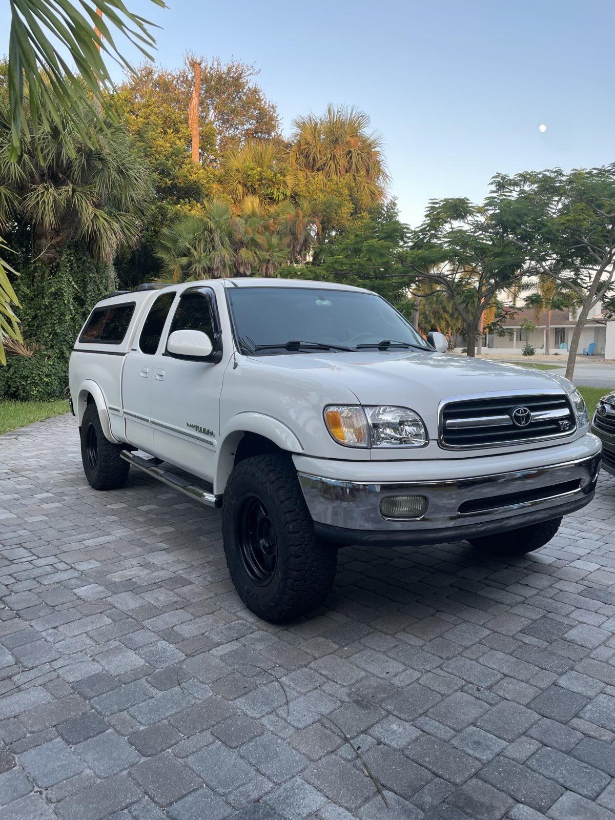

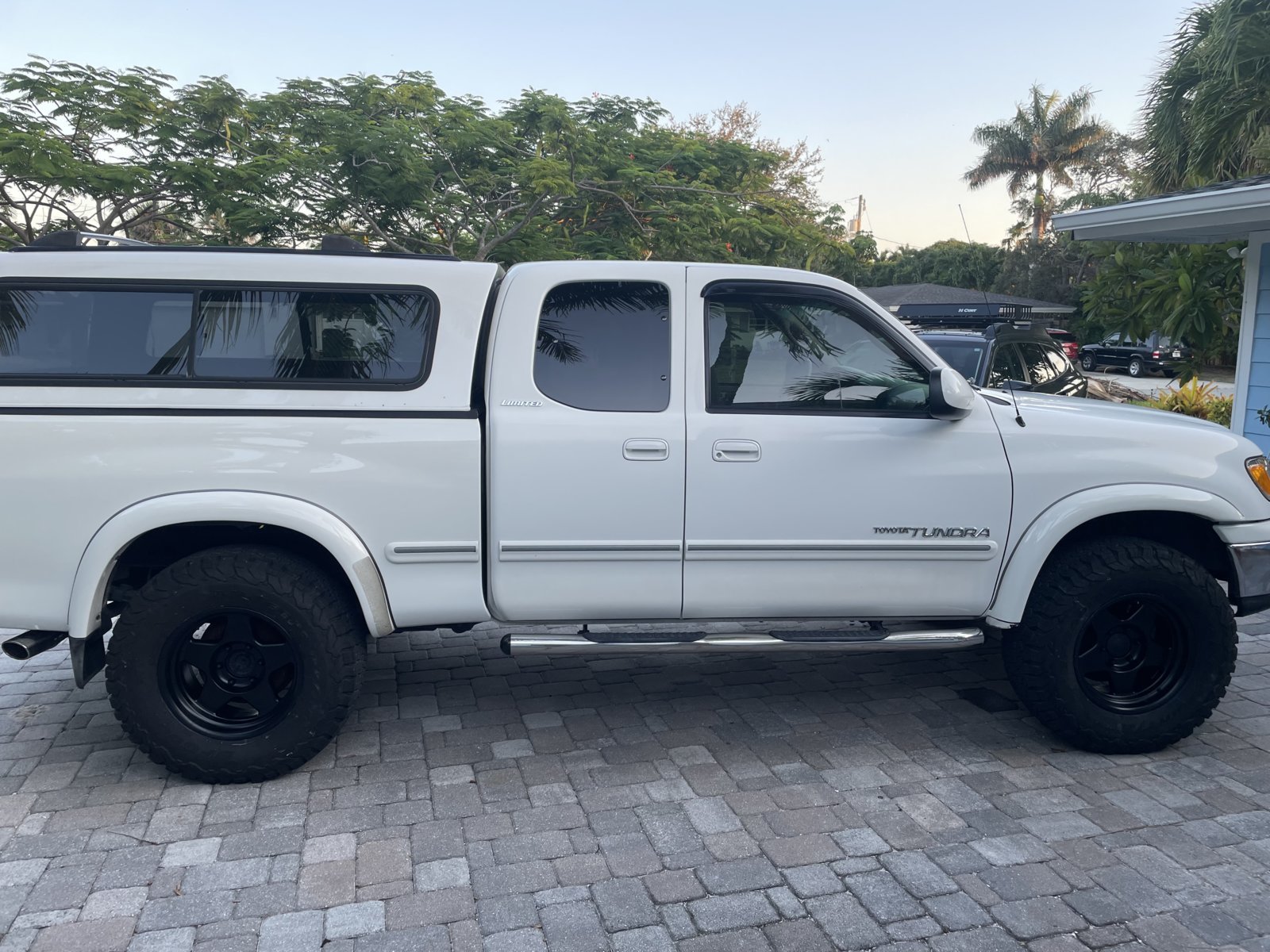

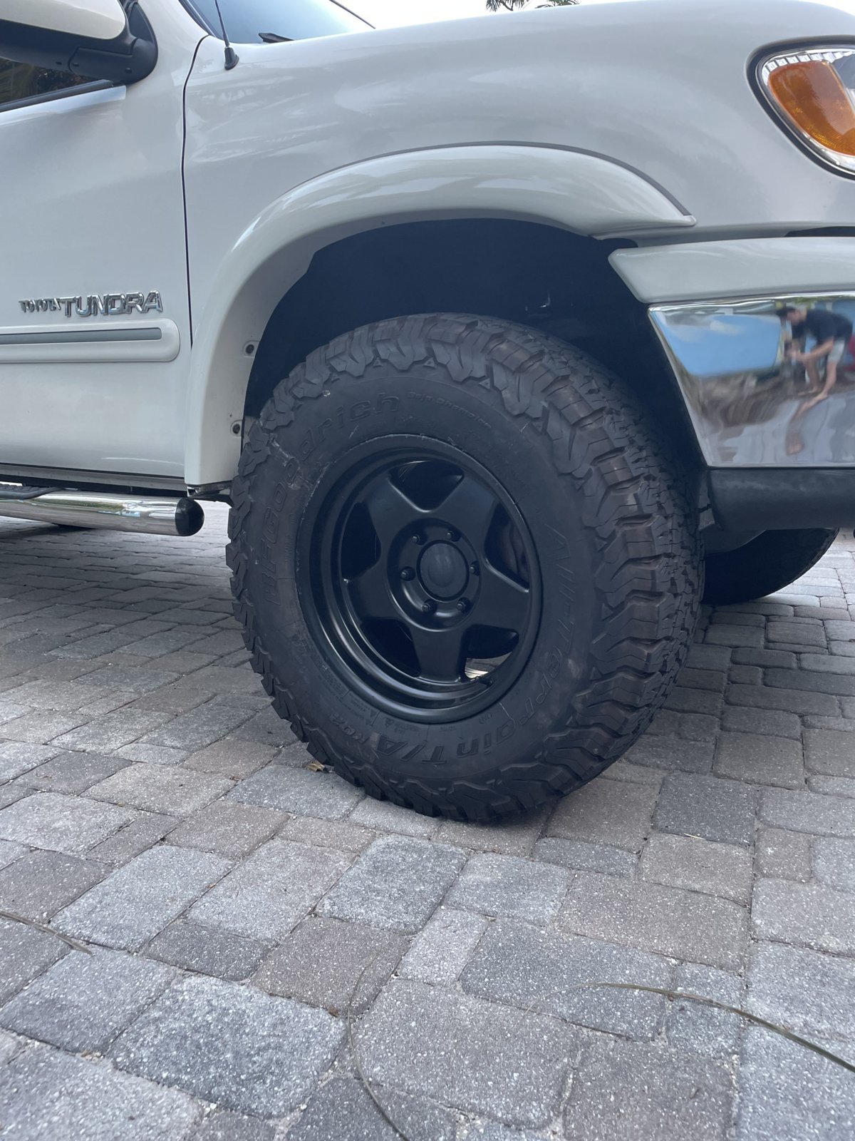

    Bilstein 6112's leveled (6/4), SCS F5 17x8.5 4.3' Backspacing on 285/70
    285/70/17r on SCS F5 -10mm Offset/4.3 Backspacing. On Bilstein 6112’s on circlips 6/4 which gives about a 2-2 1/4 inch lift. No spacers.
    Very slight rub on the right side pinch weld when you turn into a bump, trimmed out the plastic. Rub on left slide frame at full lock going over bumps. No rubbing while driving flat in drive or reverse. Nothing a sledge hammer can’t fix

    I like the way you think !

    Any rubbing on can mount?

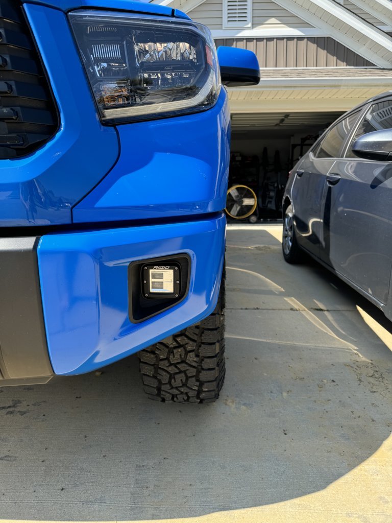

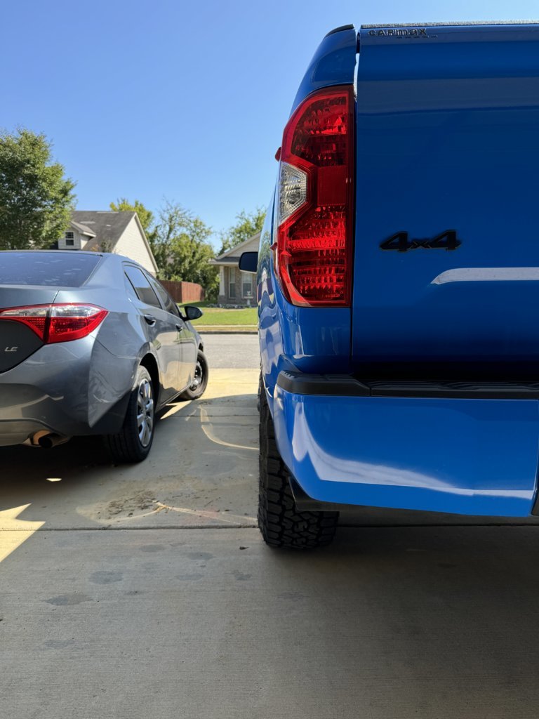

    I was supposed to get you these LONG ago, work and life got busy and I haven't been on the forum in a few weeks.
    Can't decide at this point if spacers are the move or not. 295/70 looks good from the side, but from front and back they still look too narrow for the truck. I'll probably try on the spacers on one side and see what I think.

    That's ok. 2 weeks in quarantine with Covid and 3 weeks of work. I go home tomorrow!! :)
    They look small for a tall tire, but that look is exactly what I want so I appreciate the photos very much.
    Now I can go ahead and get that size and know its good.

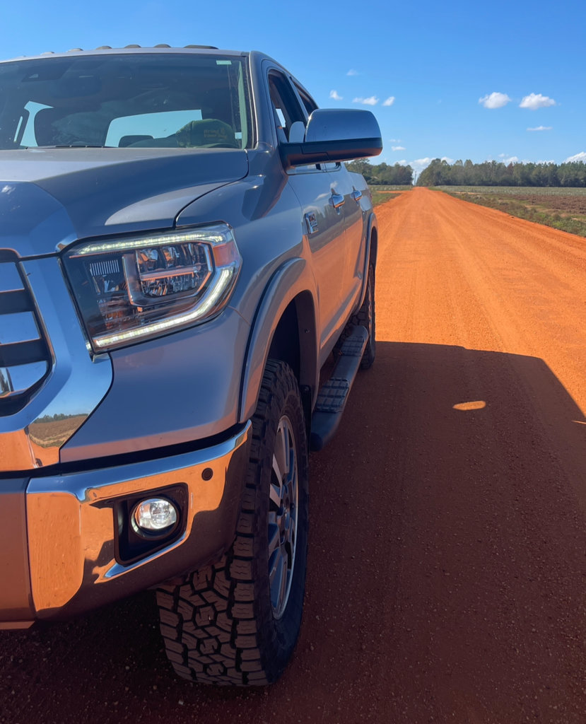

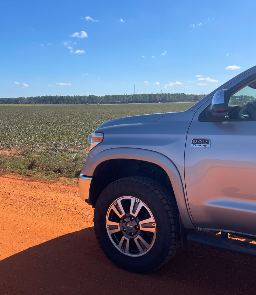

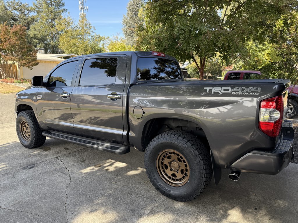

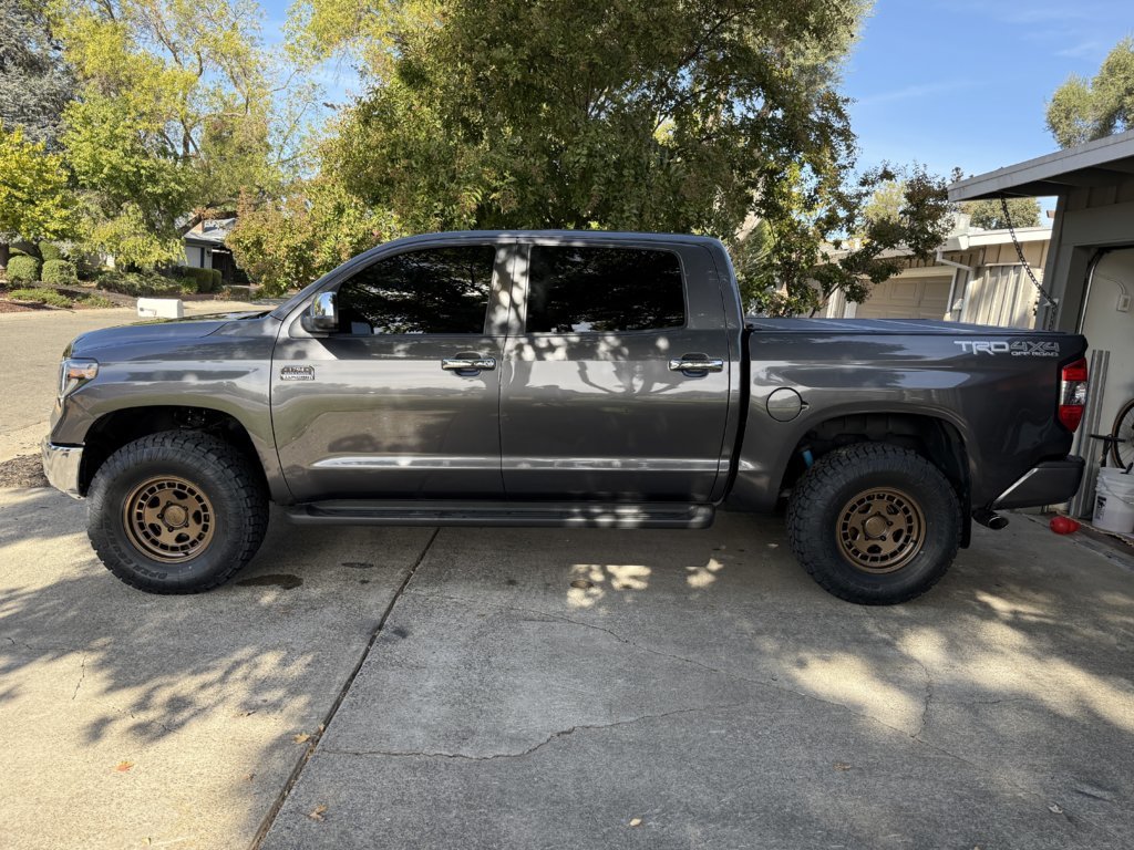

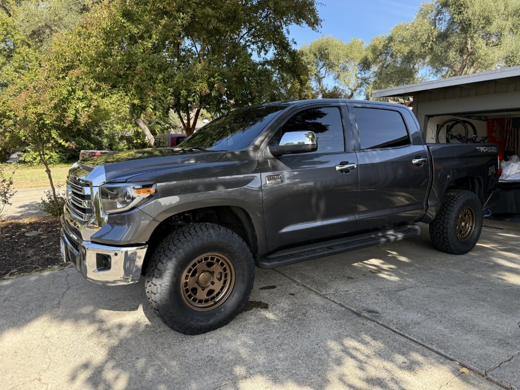

    Mounted some 315/70R17 Toyo Open Country AT III’s on a set of fifteen52 Turbomac classic HD wheels 0 Offset. Truck has a 2 inch leveling kit and some front bumper spacers. Rubbing a bit on the cab mount but I have a CMC scheduled for next week. Overall happy with the look over 33s! I feel like they fill out the wheel wells better.
