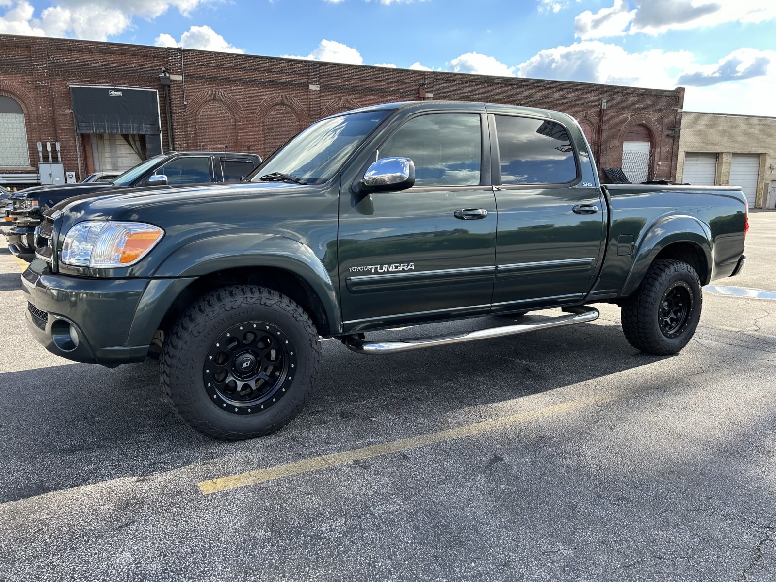

    2006 SR5 DC 2WD 4.7
    265/75r17 M/T Baja Boss AT 17x8.5 -10mm SCS Ray 10’s Bilstein 5100’s 2nd notch
    265/70r17s scs ray 10’s 5100’s at 1”

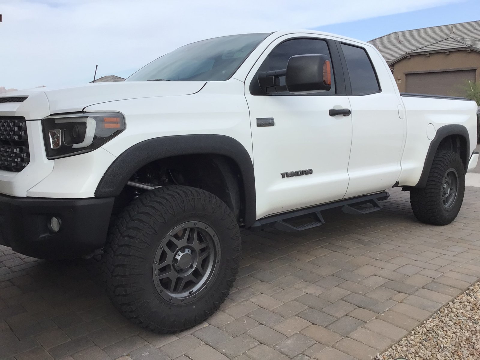

    Pro comp Phaser 41 wheels 18x9, Radar Renegade R/T 35/12.50/18 , 3.5” RC lift

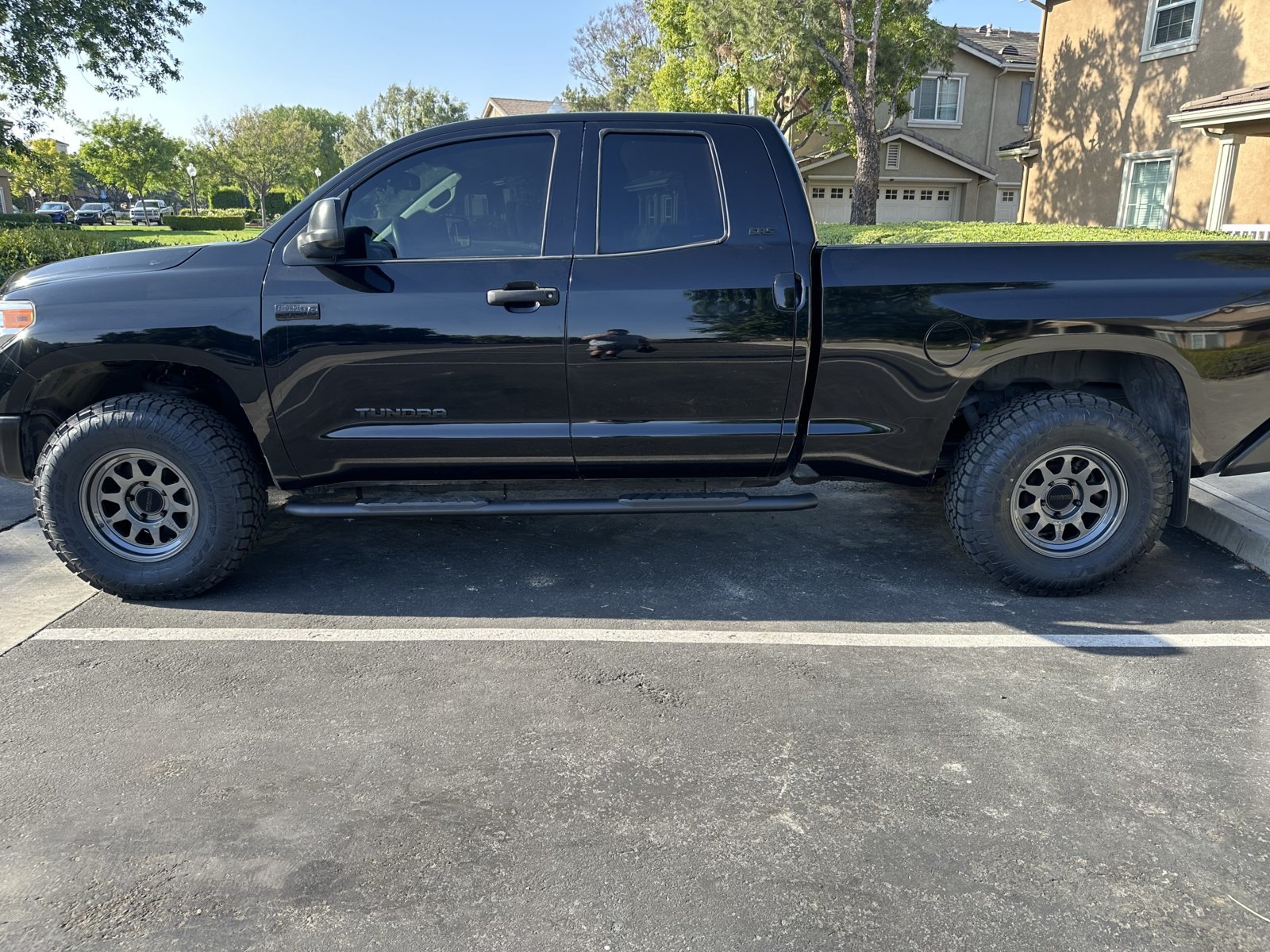

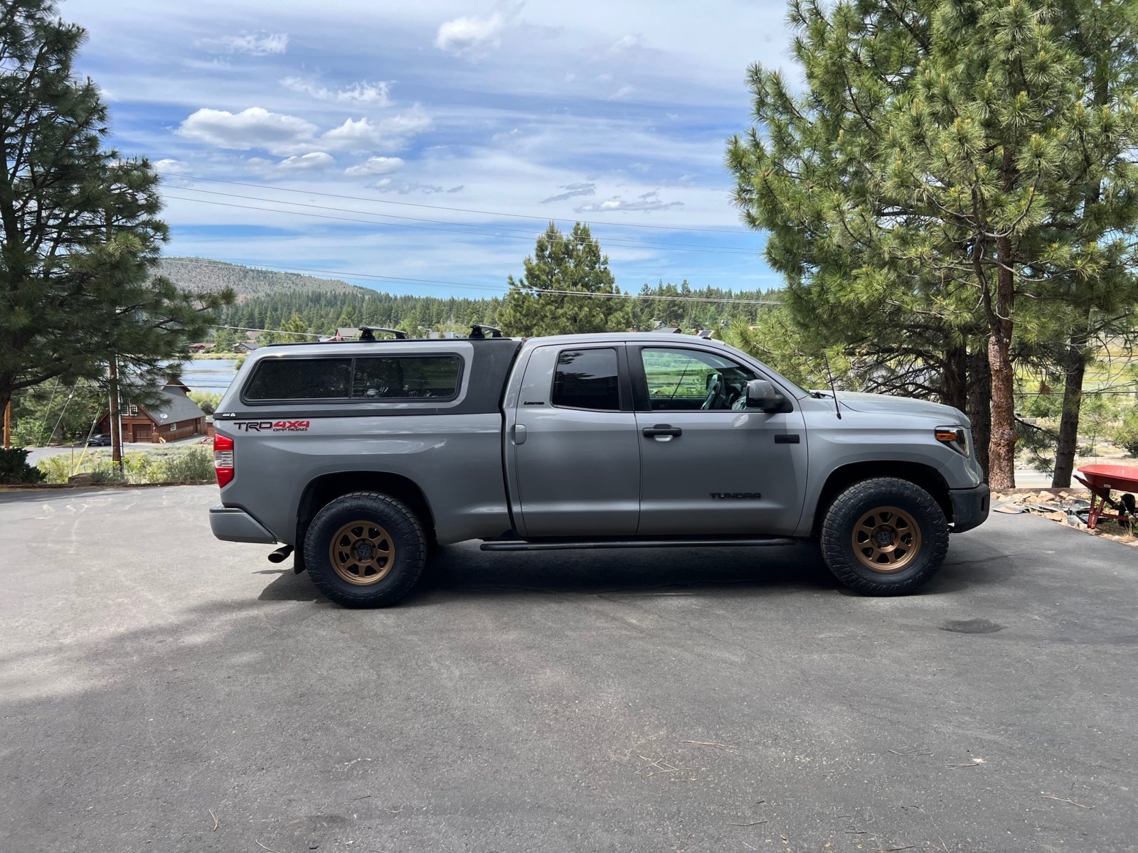

    285/75/R17 on Method 701s 17x8.5, stock suspension, just fits with mudflaps and plastic removed

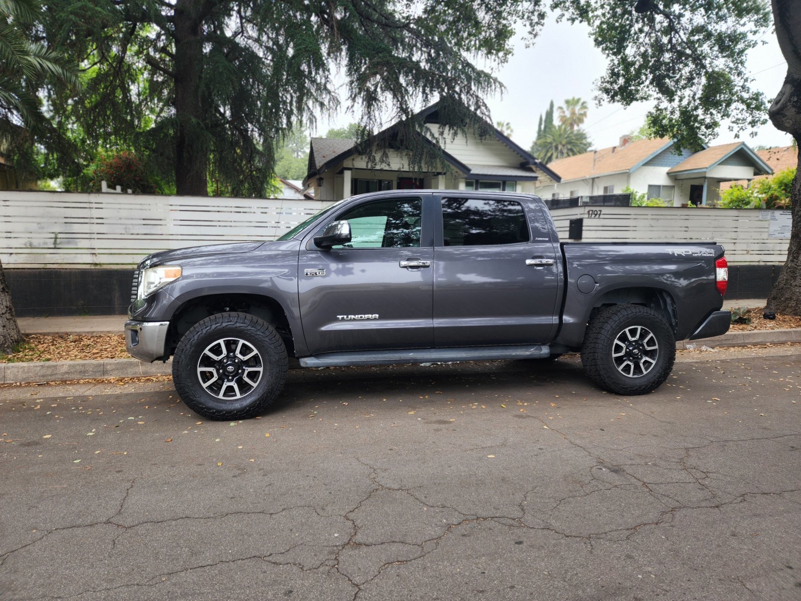

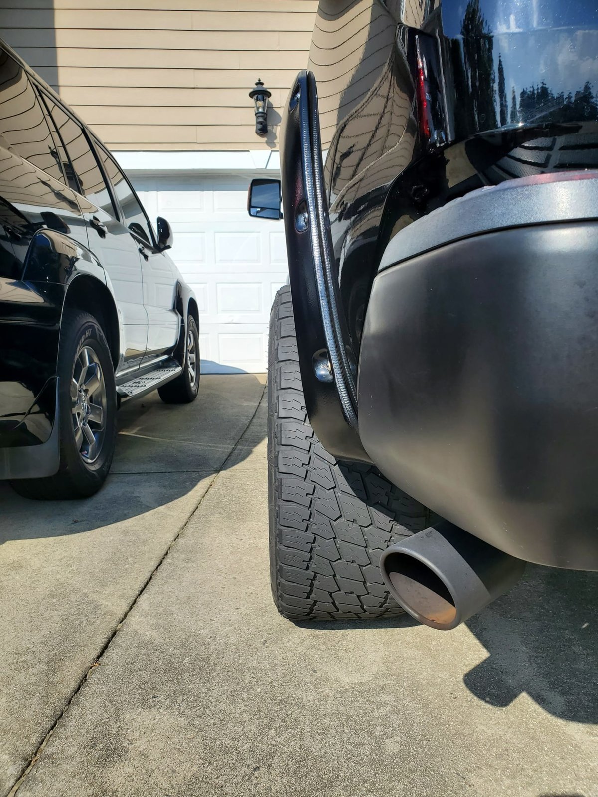

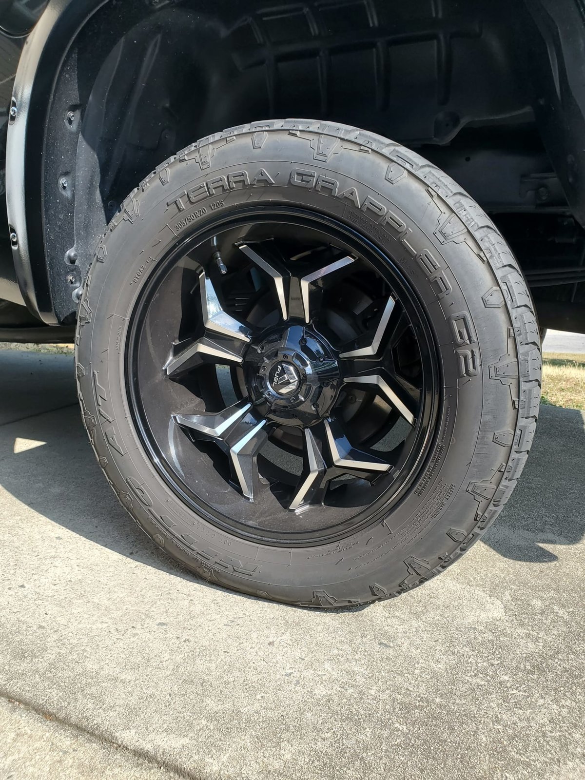

    Hi guys,
    Pretty new to truck stuff as I was more of a car nut back in the days and now with work and family I don't have time to do this whole research and I know for sure someone here is already expert in this field. The time has come and looks like I will need to start thinking about new tires and here is my dilemma.
    The truck I got is 2014 Tundra it was already equipped with FUEL wheels and 305x50x20 tires and what seems to be basic 2 - 2.5" lift with stock struts and flares. Also my decision will have to be based on budget and so far just tires seems to be the cheapest but will list all the option I was thinking.
    A: Get new tires
    B: Get new wheels and tires
    #1 I was thinking to buy smaller wheels and meaty tires and re-sell my wheels to get some money back but I have absolutely no idea what to get to maintain similar look that I have but that was something I would really wanted to do since I dont care much for big wheels and skinny tires.
    #2 If it's too much hassle and too expensive to go new wheels and tires including re-sell value for the wheels that I currently have then I will just do new tires but would rather go not as wide and rather bit taller however not sure if that will work (rubbing) with these 20" wheels and how off my speedometer will be. Currently there is small rub on frame with steering all the way turned to one or the other side but that seems to be issue with the width and dont mind to go less wide.
    Third option is trade but unrealistic unless miracles happen and both parties like the trade 1f602_ceb450e84d87cb8774be66104d77d4845913d691.png
    Based on this thread it seem like with the wheels size I have I can go either:
    285/60 R20
    285/65 R20
    I would love to have meaty tires but again not sure if thats a good idea. Don't want to throw off my car transmission or should I stay same size maybe less wider to maintain almost factory diameter?
    Anyway any input from you guys will help. Few pictures as well to get idea where I'm at right now...

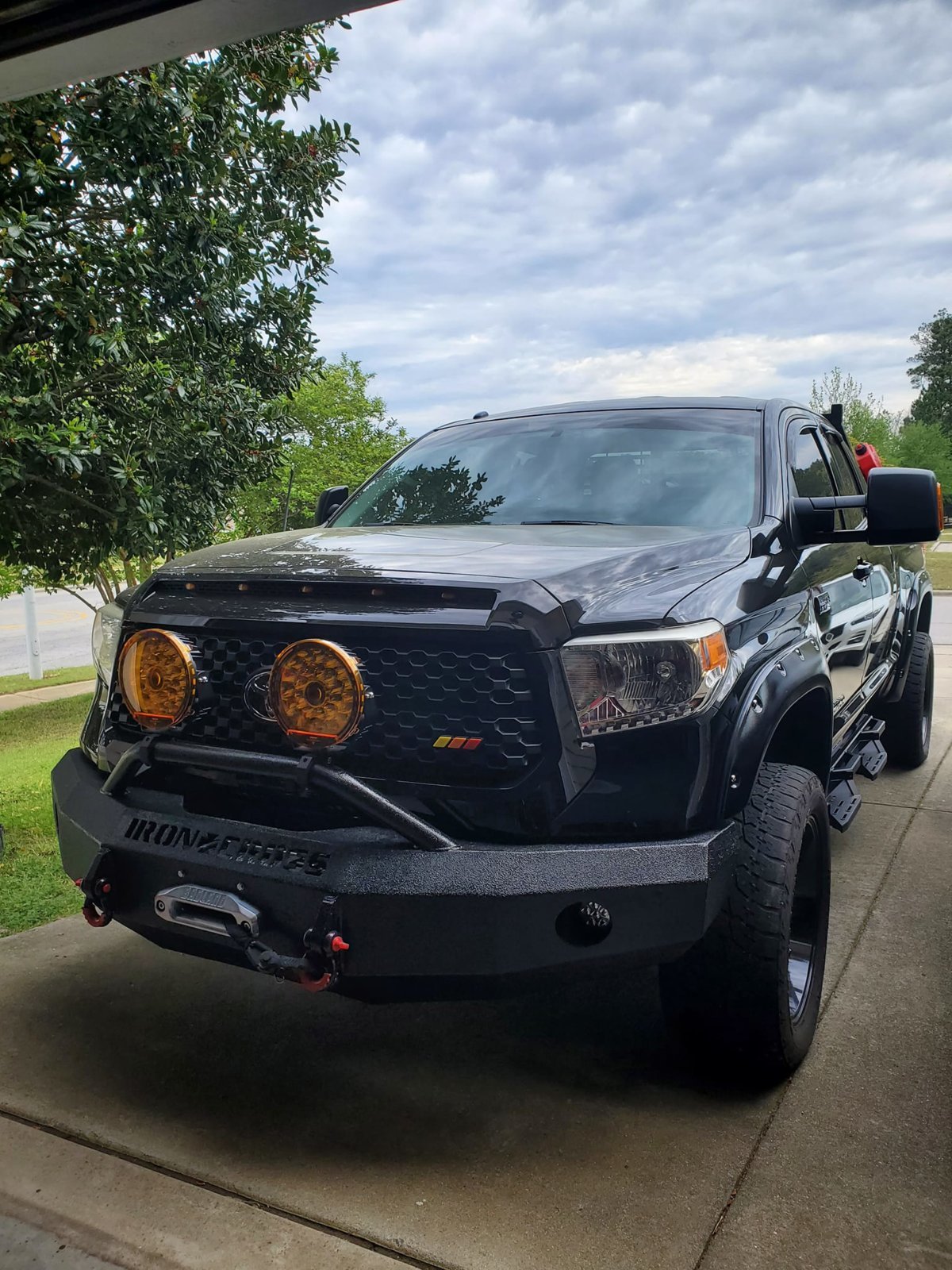

    2016 Crewmax, Limited TRD Off Road 4x4 with Falken Wildpeak AT4W, 35x12.50 R18, on stock rims. Trail Gear 1.25" spacers. Fox 2.0 coilovers set at 2", fox 2.0 Resi's on the rear.

    Anyone will be able to answer if this tire size mainly the height could cause a issues down the road?

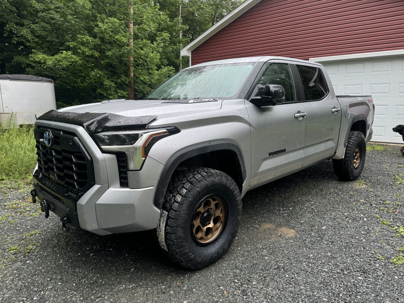

    Well here’s my two cents, KMC Dirty Harry Wheels 17”x8.5” +18 os Toyo OC AT III 315/70R17 with a Westcott Designs Tundra TRD Preload Collar 3”/1” Lift Kit.

    great looking setup. you may want to take the sticker off the wheel though lol

    Thank you, the sticker will wear off on the road to an alignment tomorrow lol

    In the old days that was a thing - 'Sticker Tires' meant a guy had just bought new tires. They wear off, of course.

    Is anyone capable to answer my question or yall just going to discuss stickers on new tires? And yes I wouldn't bother to remove that sticky nasty stickers either they will be gone by the time he get to the alignment shop :) Anyway one more time ...
    Will any of these cause any issues down the road ?
    285/60 R20
    285/65 R20
    295/60 R20
    295/65 R20
    When I bought this truck it come with 305/50/20

    There is a 2.5 - 3” difference in height with those 4 sizes you mentioned compared to the
    Ones it’s came with. The tallest are the 295/65R20 just over 35”. Depends on offset of your wheels.
    But from what I’ve read and I have a 2010 is that no, you should have no issues.
