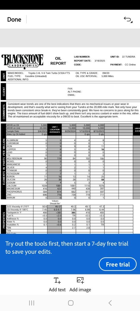

    Thanks for sharing. Nice numbers. Oil Brand??

    I'm not sure, Toyota dealership special. I think they use m1

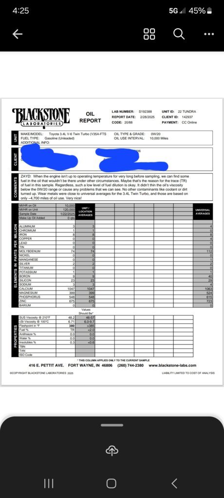

    125k currently on Jan 2022 purchased SR5 with TRD OR factory upgrades
    Did BS analysis at 120k
    10k OCI (3 yrs & 12 total oil changes)

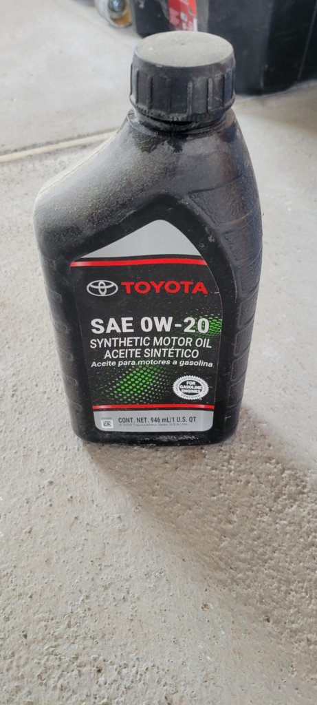

    Using 0w20 toyota flavor
    Doing it again at 130k with TBN

    Thank you for posting.
    You say you use Toyota oil? Mobile1?
    I compared my results and yours.
    Your engine has 100k miles MORE than my engine.
    I changed my oil at 1k, and every 5k miles
    You change your oil every 10k miles.
    How is it possible that your results are same or slightly better than my engine that has 100k miles less and gets oil changes twice often than yours?

    Wild stuff, huh?
    We should grab a beer next time I'm in sf & chat it up....but staying on topic--->
    I was nervous at first doing zero early preventative oil changes & going 10k OCI rather than 5k...so far so good

    I'm also doubting the Blackstone results.
    Engine with 20k miles and 5k oil change intervals can't have same results as an engine with 120k miles and 10k oil change intervals.

    If you think about it, it actually makes sense that a motor that spends more time running at optimal operating temperature will have less internal wear compared to a motor that does shorter trips and spends less time, percentage wise, at optimal.
    I am assuming, since there is such a vast difference in the mileage on your vehicles, that this could be the case. Not trying to start an argument, just pointing it out.

    also, Could using toyota oil (like what was in the motor from the factory) have an effect on the oil test/engine wear?
    I noticed that most peeps in this thread are using a variety of oils, usually introduced immediately after purchase of their tundra or soon there after....I didn't touch my factory oil until 10k & only used toyota 0w20 for my 12 oil changes, (btw I did all the oil changes at home)
    I'm pretty sure when toyota engineer's/develop motors, they only use Toyota oil with the same specifications each time.... they are not using mobile 1, then pennzoil, then castrol, then toyota
    They would use the same flavor repeatedly to insure valid testing results on the motor
    Which I would assume is the toyota branded oil....I know toyota doesn't make oil, but using the same oil makes sense for scientific/engineering purposes
