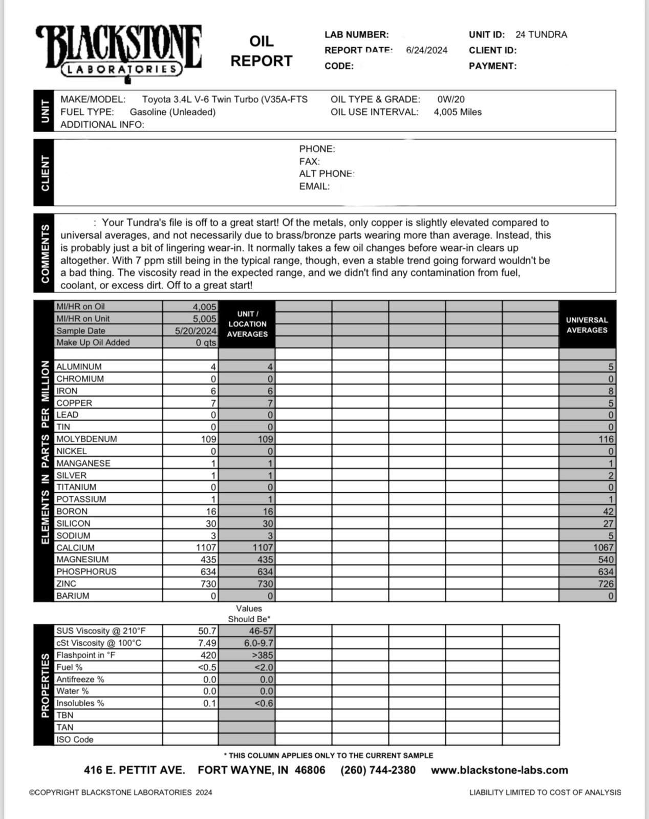

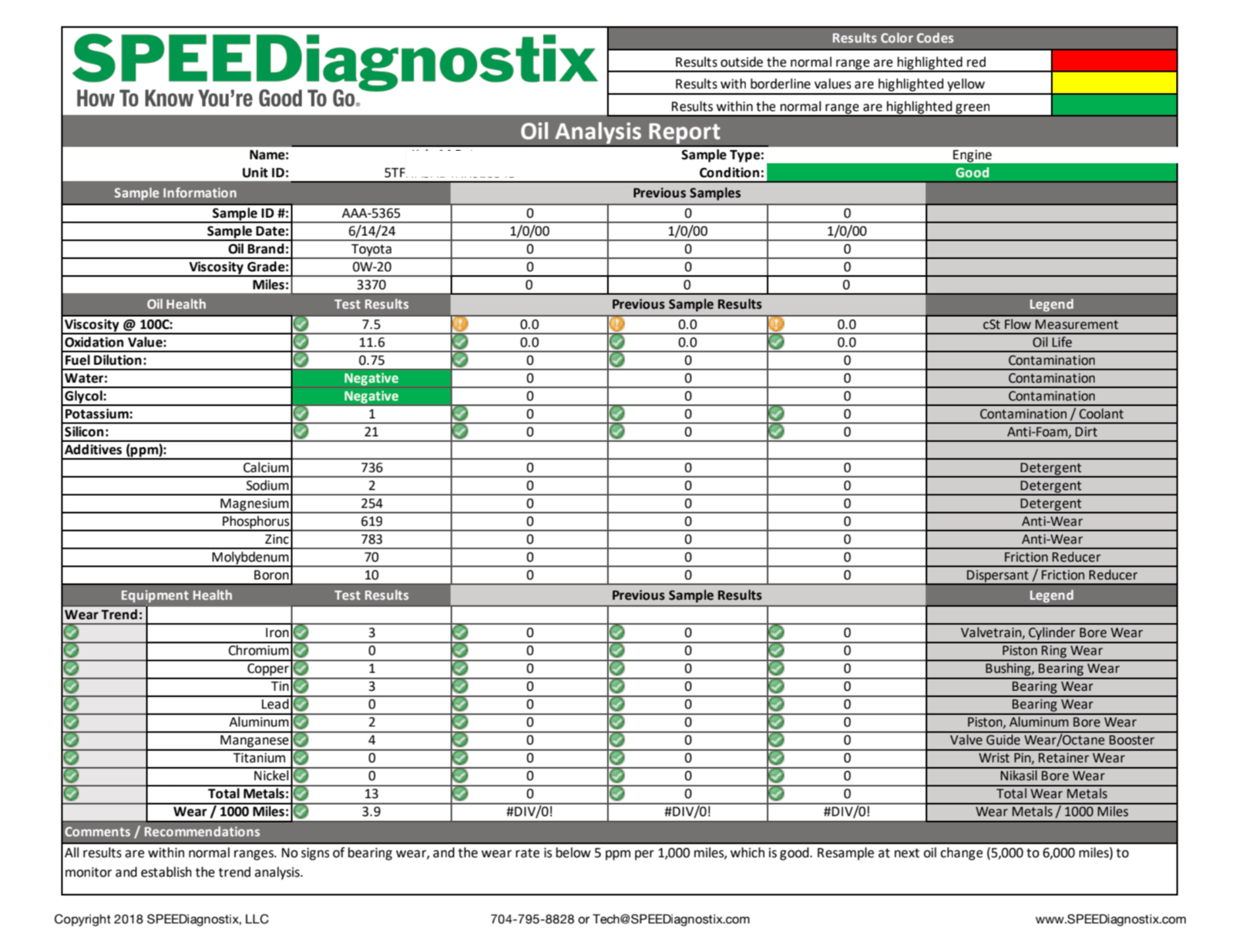

    Oil analysis on my 2022 Tundra at 28XXX miles with 3370 miles on this current oil. First oil change at 1,000 miles, all performed at my dealer. Oil changes done ever 5k.
    dJunior, machd08 and OLV1071571 like this.

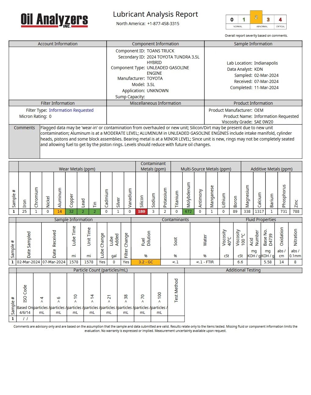

    This was my first oil change at ~1600.
    Firemedic1428 likes this.

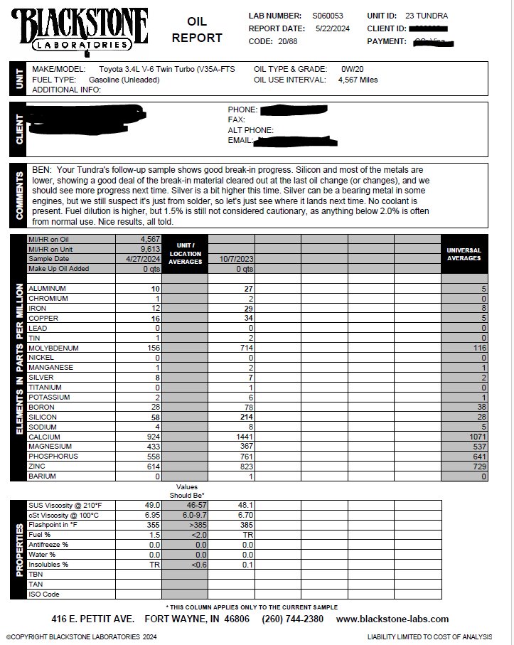

    Just got my report back from the initial 505 mile oil change, nothing to worry about.AAA-6060_Page_1.jpg
    Tundrastruck91 and Firemedic1428 like this.

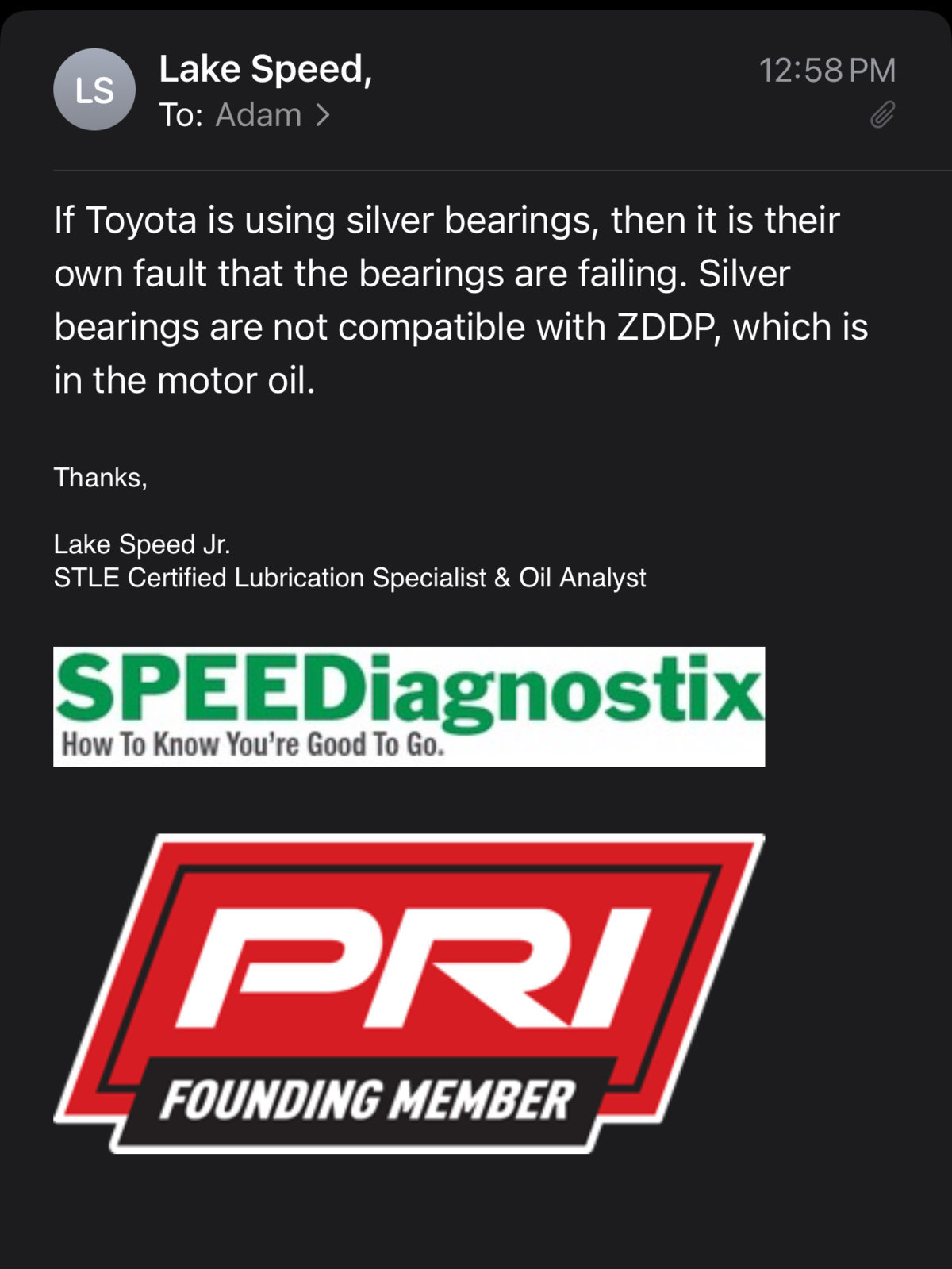

    From Speed Diagnostix in an email I sent asking about the absence of silver levels in their tests.
    “Silver is only found in electromotive diesel engine bearings, so it is not a wear metal found in any gasoline or diesel powered vehicles, which is why we don’t report it. There are several elements that we test for that we don’t commonly report as they are not relevant to the results.”
