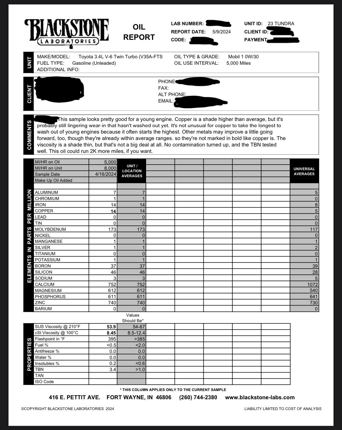

    Limited with 8,000 miles. M1 0W-30 (GF-6A)oil used, changed the sparkly oil out at 3,000.

    Thx for sharing this. Q? Did you mention to them the sparkly oil at 3K?

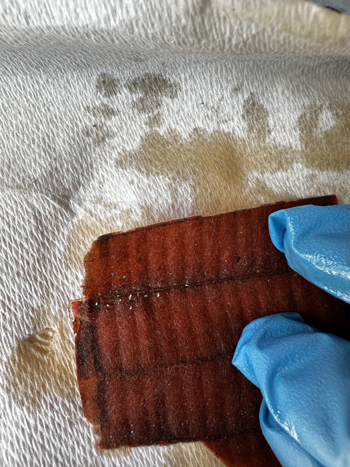

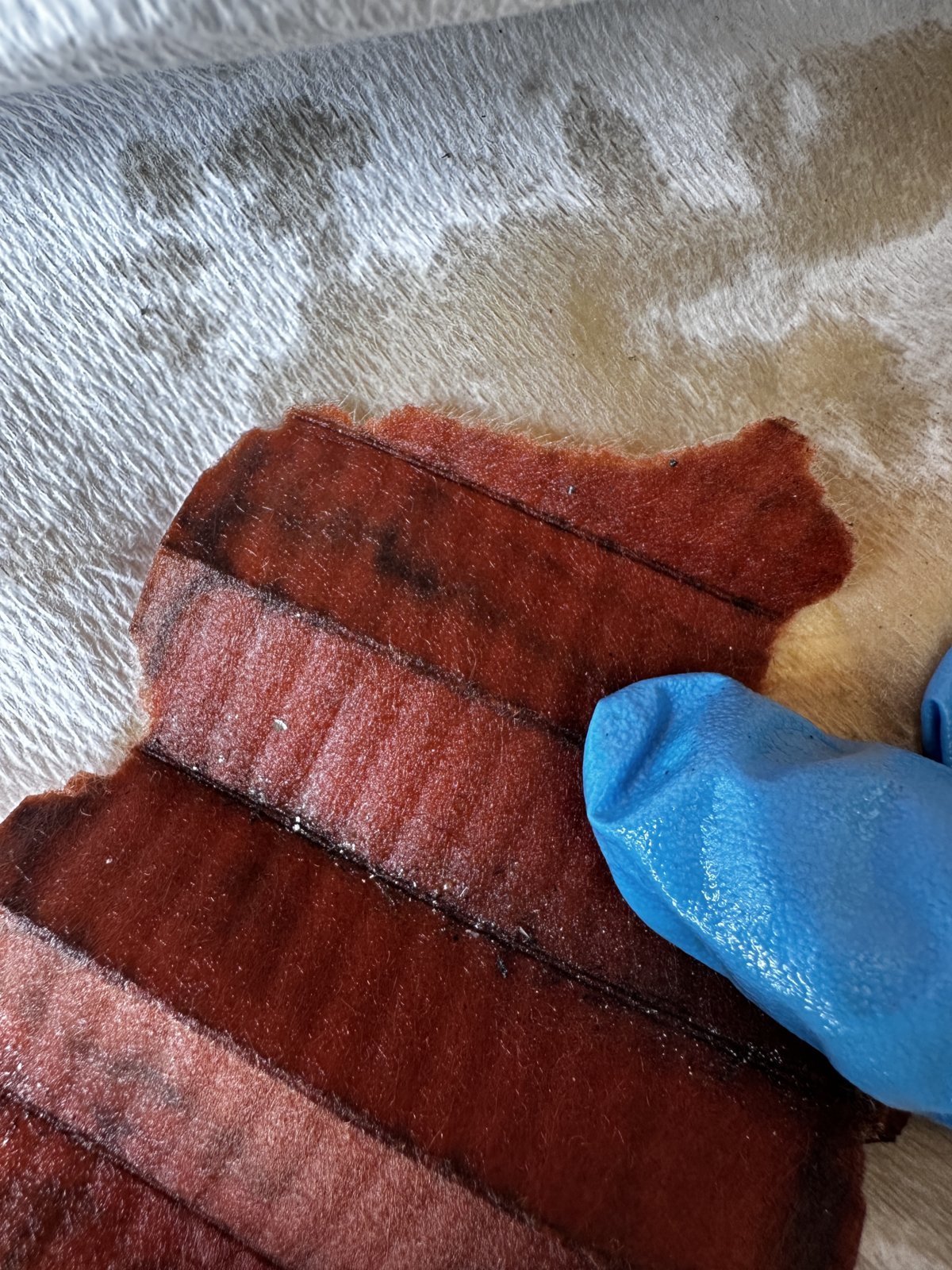

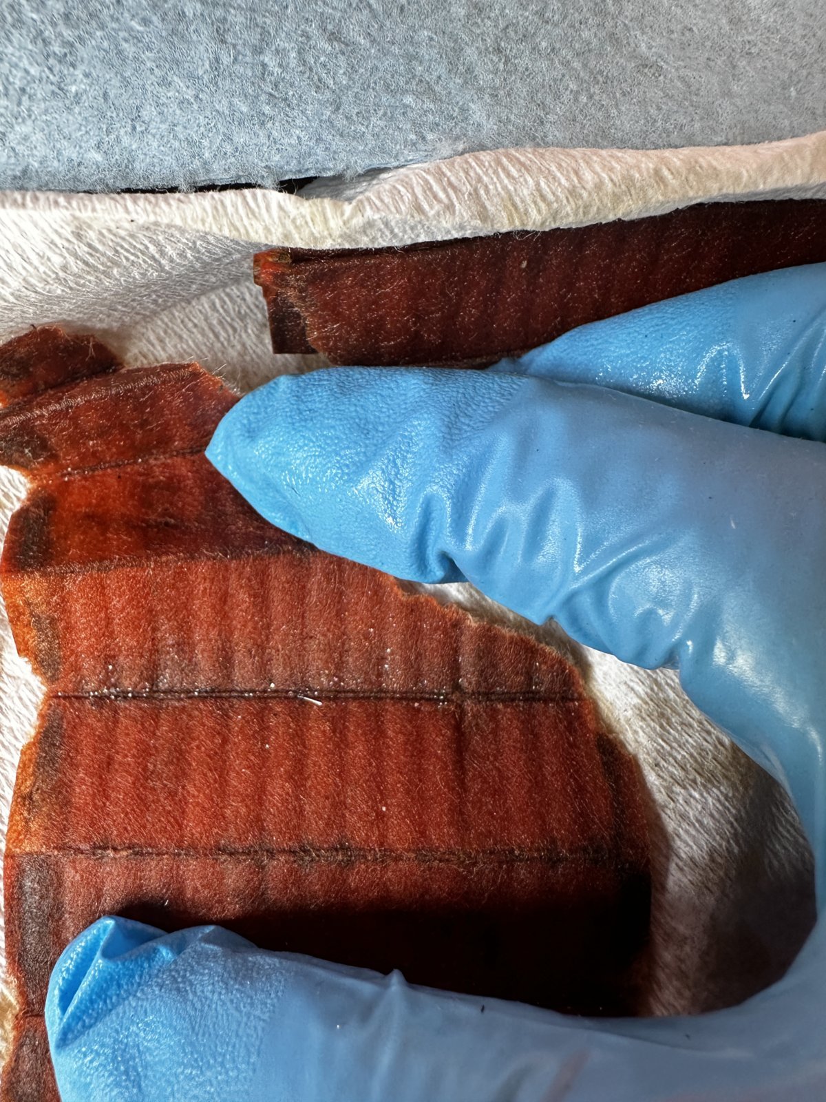

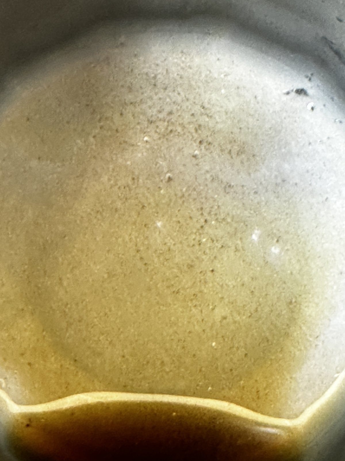

    Waiting for my report to come back from Speed Diagnostix. Did it 500 miles, opened the filter and looked at the filter pleats, these were the few areas with debris. Will post results when I get it back.

    Yes at 500 miles. At least the filter got it, not worried, have lifetime power train warranty, comes with the vehicle, South East Toyota/Dealership warranty.
