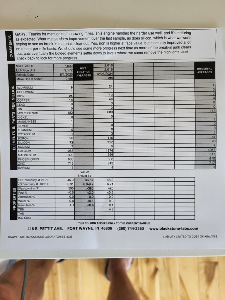

    389 24/7
    389 24/7 125k on the gen3
    Oct 31, 2023
    #106248
    262
    Oregona
    2022 TRD OR
    Nada
    I wish there was another higher mileage gen3 doing 10k OCI with a post 100k mileage oil analysis to compare my results against
    As far as my driving
    I idle alot
    I drive 1000 miles every weekend, usually
    I would say I do 70/30 (highway/street)
    I average 20mpg

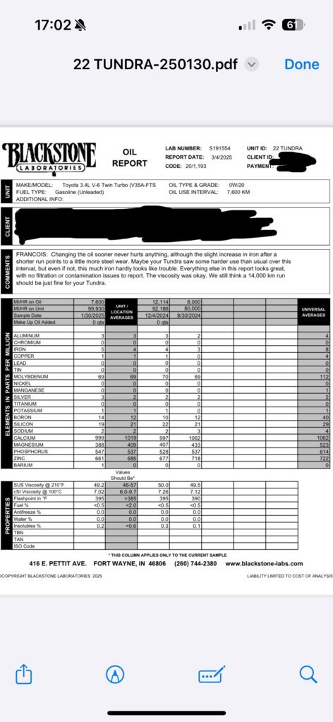

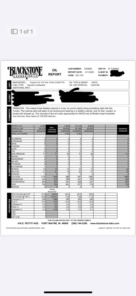

    Francois
    2022 Lunar Rock Sr5 TRD Off Road
    Last 2 results. Went on a 3000 mile road trip down stateside through Montana and North Dakota after this and did some harder driving than the truck is used to in a very short time so I’m curious to see next analysis. Silver is creeping up but who knows what that’ll do.

    238
    Francois
    What exactly needs to improve on this oil sample that you wouldn’t expect from break in oil? Also, except for the flashpoint and fuel% on your last sample before you had a failure, what do you think looked bad? More importantly, what indicator in any of these samples are you looking at to say that Toyota hasn’t figured it out if it doesn’t improve?

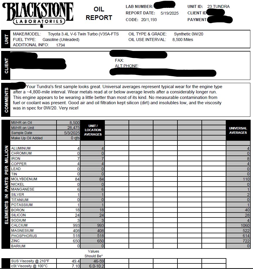

    Just had my first oil analysis. Posting results. I was happy with it.

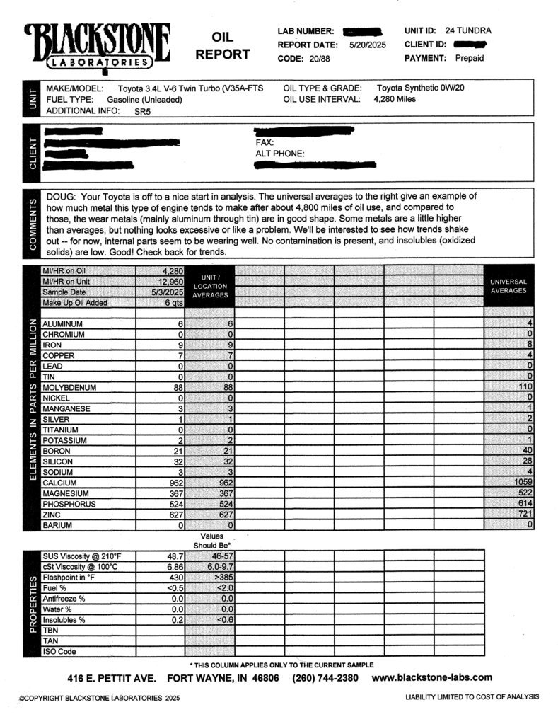

    First oil analysis for my 2024 SR5 at 13K miles. 3rd oil change and first one done by me and not at a dealership. All done at roughly 4-5K intervals.Oil Analysis 052025.jpg

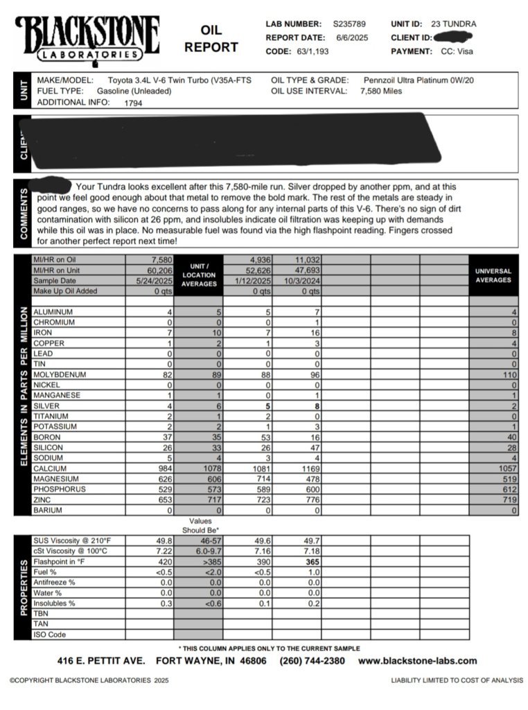

    Bought used. Vehicle was manufactured within date range of recall but not in scope of recall. First oil change was on Toyota oil. Last 2 have been Pennzoil Ultra Platinum. Might take Pennzoil to 10k for the next sample.

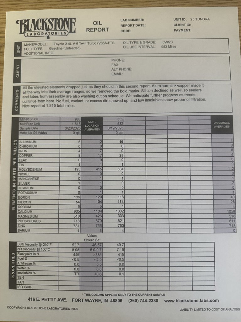

    2022 Lunar Rock Tundra SR5 TRD Offroad CM 6.5
    I decided to run a Blackstone test every other oil change. Shooting for 100k before I get a new engine. Build date 7/22
