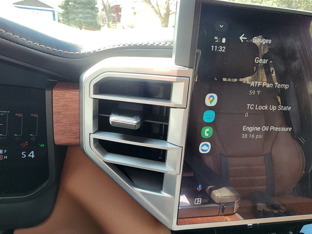

    An intersting point made here and something I tried today. I came to a full stop at my normal leave the neighborhood route and today I pulled the shifter into “s”. The dash said “s4”. I manually adjusted to s1 and there was no lag which happens every time previously in “d” mode. Odd that the truck feels it needs to start out in what I think is 4th gear but definetly noteworthy. I am not a gear head just sharing my experience.

    that’s not what’s happening there , it defaults to 4th as a limit high gear when you do that . It does not mean your in 4th gear

    OK, I'm back to thinking the tranny is slipping then.
    I didn't the scan tool
    Couldn't Toyota have the dash readout show EXACTLY what gear the truck is in .... and still have gear limits and a gear range in the background?
    I'm not debating that the dash readout is not the gear you are in at that moment because it would be beyond stupid for the truck to be in 3rd or 4th gear when at a complete stop
    ....but I am debating that Toyota designers we smart to display it this way.
    Just another dumbness for no reason and still doesn't explain the tranny slip or downshift or whatever I'm getting every morning.

    Transmission is not slipping. It is a delay in it downshifting all the way to 1st gear.
    There is a TSB out for the Tundra HV & Sequoia HV starting out in 2nd gear, even when doing it manually downshifting with the shifter.
    https://dot.report/bulletins/MC-11003578-0001.pdf

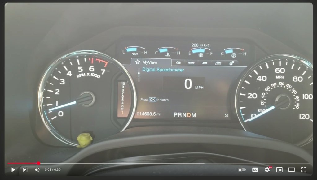

    It'd be nice if they would do that. My old boss had a 2013 F150. His I believe, always displayed 1-10 and would high-light whichever gear it was in. I thought it was neat and was disappointed when my 2014 Tundra couldn't.
