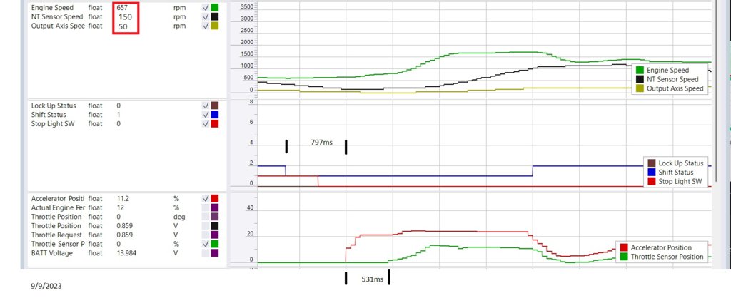

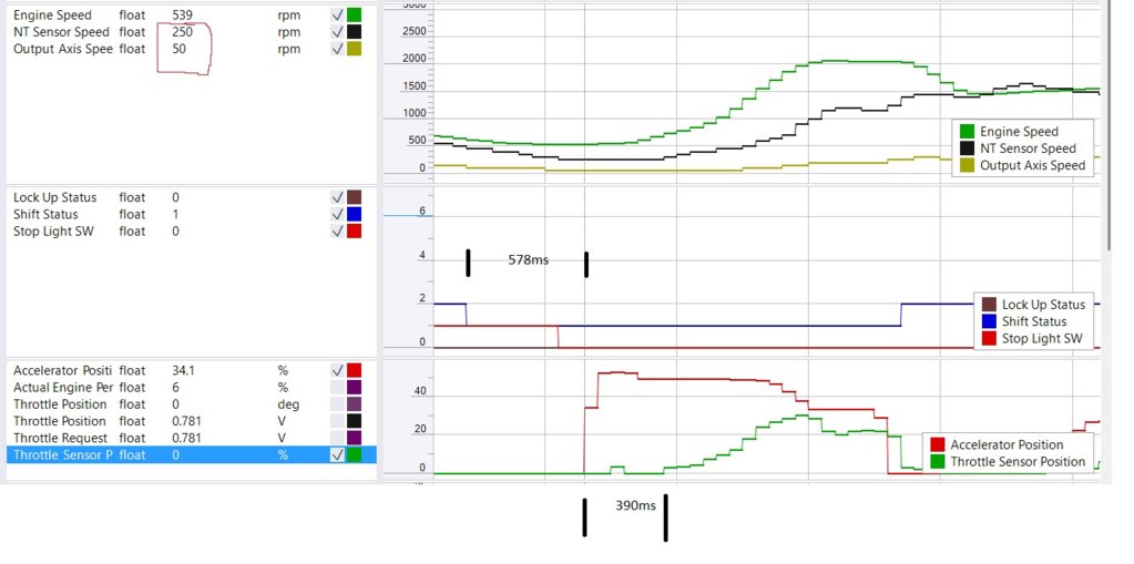

    This is the hesitation I'm able to observe, Slowing down there was a downshift, then after 578ms I pressed the acclerator to about 34 percent, but it was about 390ms before the throttle was commanded in any meaningful way , I believe to experence the hestation, you have to achive Output axis speed 50 and less than 300rpm Input (NT) Speed. I took the timestamps and the total time from the Output axis (drive shaft) going from 50 to 100 RPM was about 781ms.
    You can also see Engine RPM is very slow to ramp up despte the accelerator at 52.9% (basically half floored) which is not the same pattern I see under complete stop.
    I belive the output axis speed being reported as 50 RPM is a critical requirement, as its very hard to see any delays at 100rpm or 150rpm. Acheving these exact speeds of the input and output of the transmission is very thread the needle and to apply the accelerator at the exact right moment to see the delay.
    Since having the Transmisson Movement in Neutral recall I have not been able to log any hestation beyond about 390ms, but I'm not convinced just because I haven't that it couldn't happen. Keep in mind 390ms is the computer delay, by the time you feel it as a driver more time has passed.

    This one was from 9/9/2023 before the Transmission was updated for the recall, I have not seen a delay this long in some time, so I'm not sure if this condition was improved. A note here is that NT Speed 150 Output Speed 50 is a lot harder to acheive.
