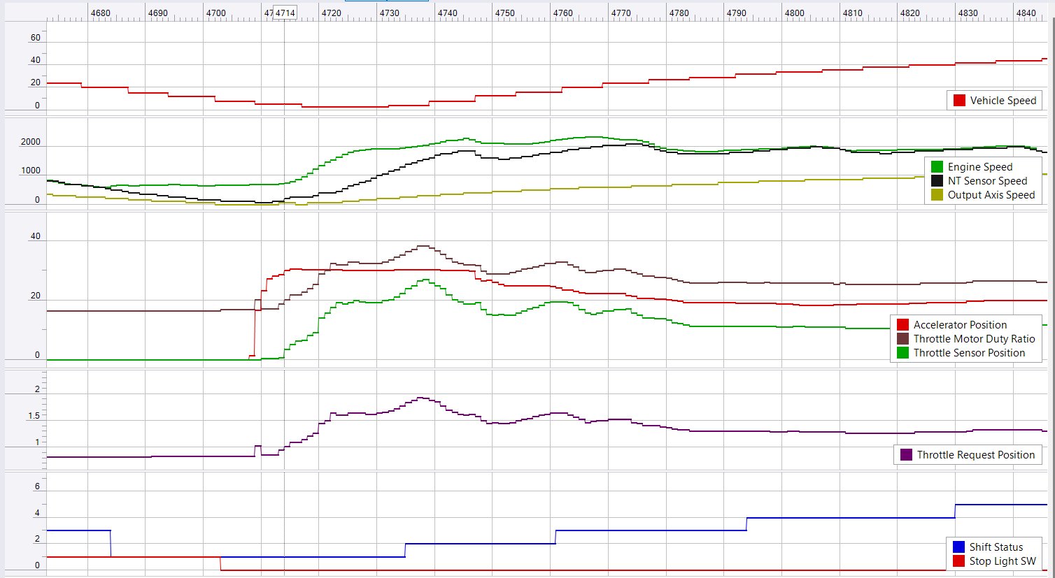

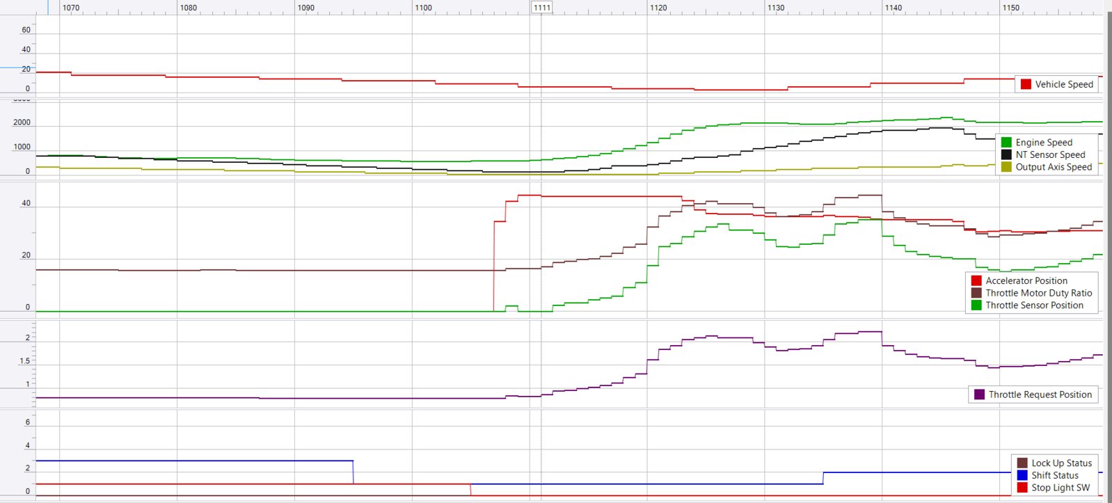

    I'm doing a long term AGM test, the typical charging voltage is 14.1 volts. When it gets into the mode where it decides to charge more when costing downhill it does get higher.
    Some data from drives with the AGM
    Older drive data with the EFB
